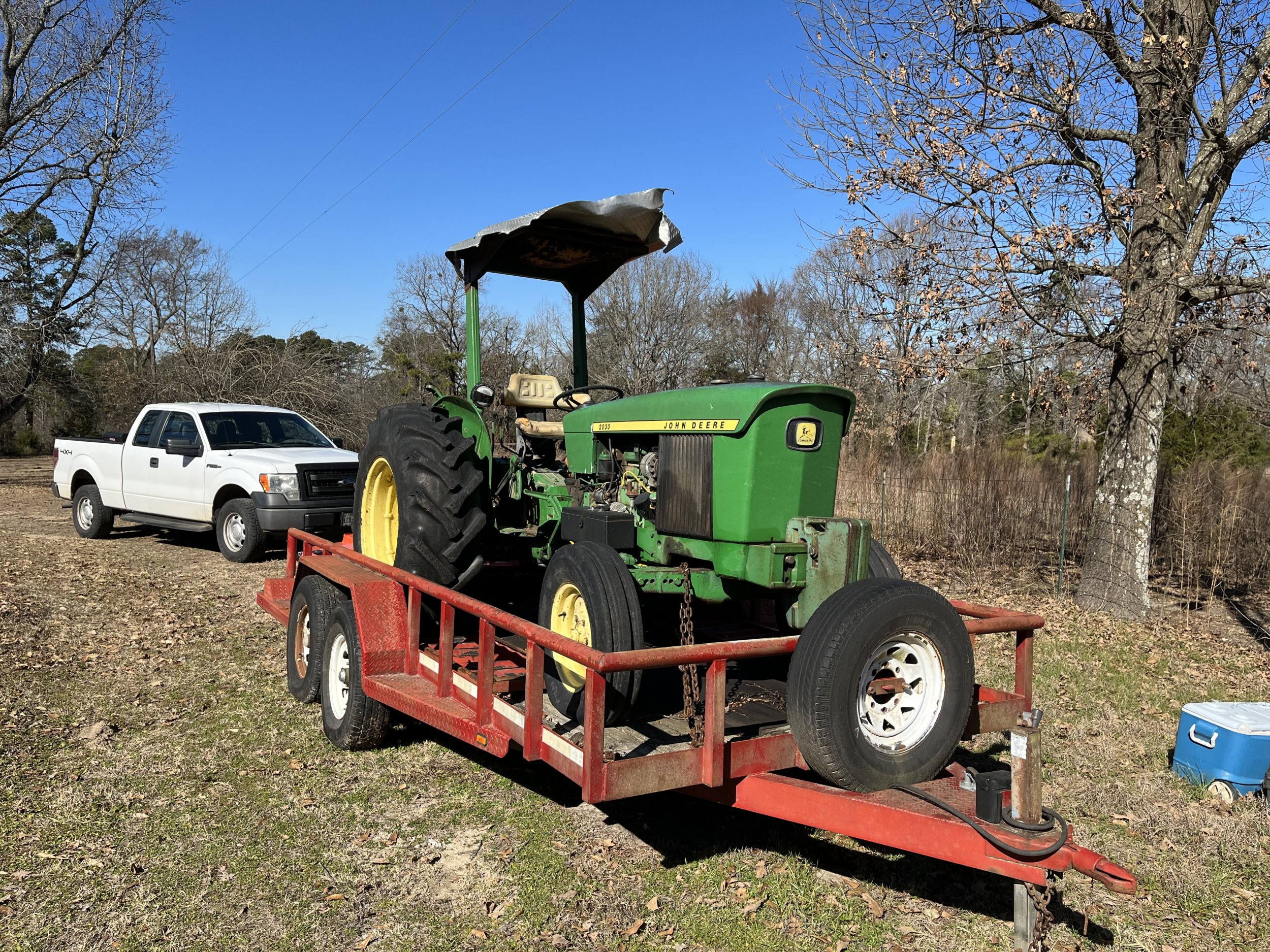

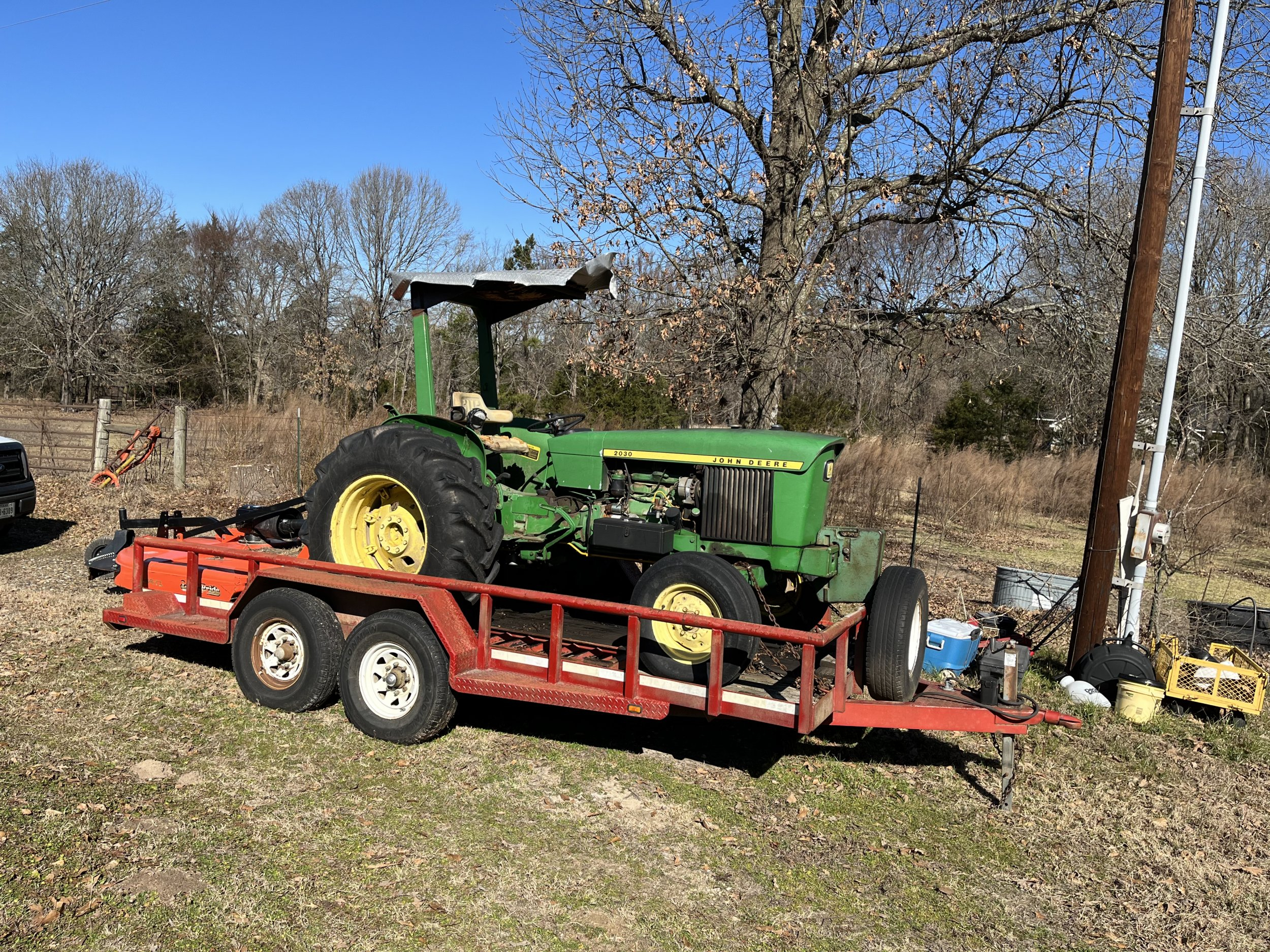

Metal is all pretty straight. Will try to post a couple of pics in a bit. Dealer says 1500-2500 for repair and my better half says I should spend that on new or newer one than repair this one!
   / Pricing for JD2030 w/pto clutch issues?
Pics of the 2030
   / Pricing for JD2030 w/pto clutch issues? #8
You might find that repairing it now and fixing your roll guard will net you a much more than selling as-is
#9
For someone with a shop and equipment to split this tractor and repair it could be a great older machine for your farm
   / Pricing for JD2030 w/pto clutch issues? #10
You won’t get much for a broken 2wd, geared, no FEL tractor if you try to sell it as is. Buyers will lowball you, figuring the worst case scenario for repairs.
I would bite the bullet and repair it, but before taking it to the dealer, I would see if an independent shop might be a bit cheaper.
When you get the tractor back, you can sell it for a better price, or keep it and continue working.
