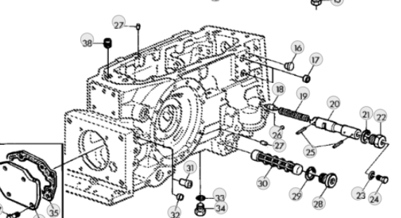

What are the symptoms of the non-functioning hyd engaged pto? Do other hyd's function correctly? Has anyone checked pto operating pressure?

Was mowing a small property that I have been taking care of for a couple of yrs. On my sixth round noticed difference in engine sound and my mower was barely turning lifted the mower and speed picked up again. Dropped a gear and finished that round back to my truck to take a break disengaged mower to let all cool some - 20 min or so - tried again and there was no resistance like normal engaging the hyd to engage clutch mower just barely begins to turn and then picks up

Any clues
Open to suggestions
Have tried it a couple of times after I got it home - same thing
   / Pricing for JD2030 w/pto clutch issues? #15
How long since hyd filter was changed & suction screen(item 30) checked/cleaned? I suggest to remove cowling the gearshift levers protrude through & attach 300 psi gauge(item 5) to check pto clutch pressure. Pressure should be 155-165 psi.
