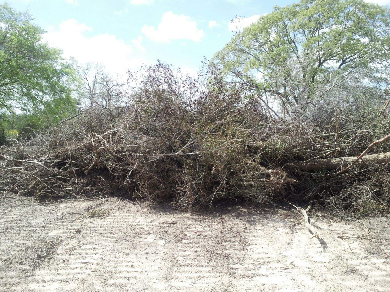

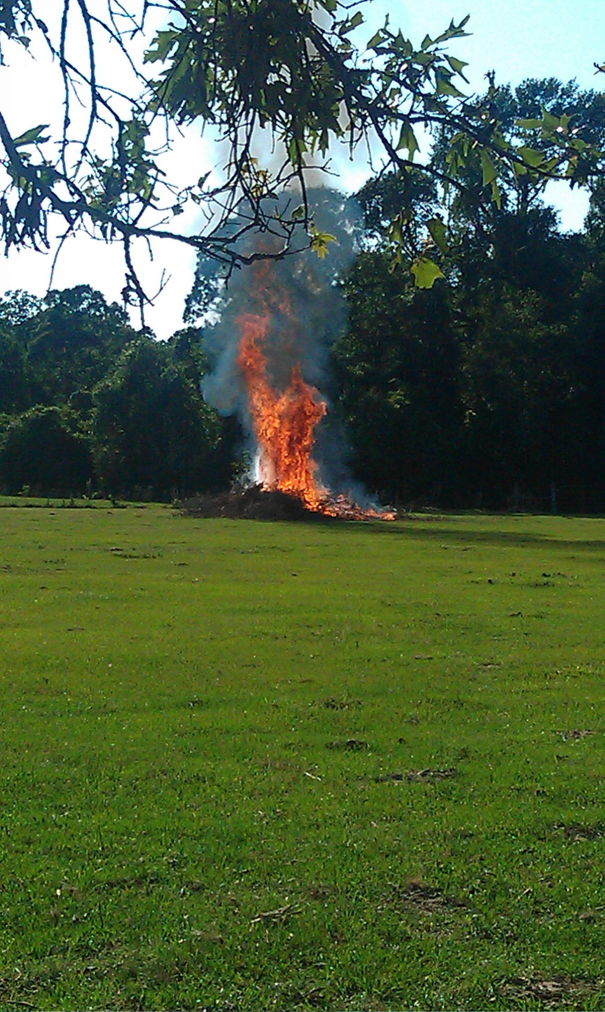

Yeah,its also alot of clean-up after burning it,I can get some photos of mine later,if you wont of how my pile is,should burn up 99% sometimes the bigger tree stumps have alittle dirt on bottum and dont burn up completely. I'll take a picture of my neighbors piles what not to do,when making brush piles(what you can look for. Just give me alittle bit for pictures..

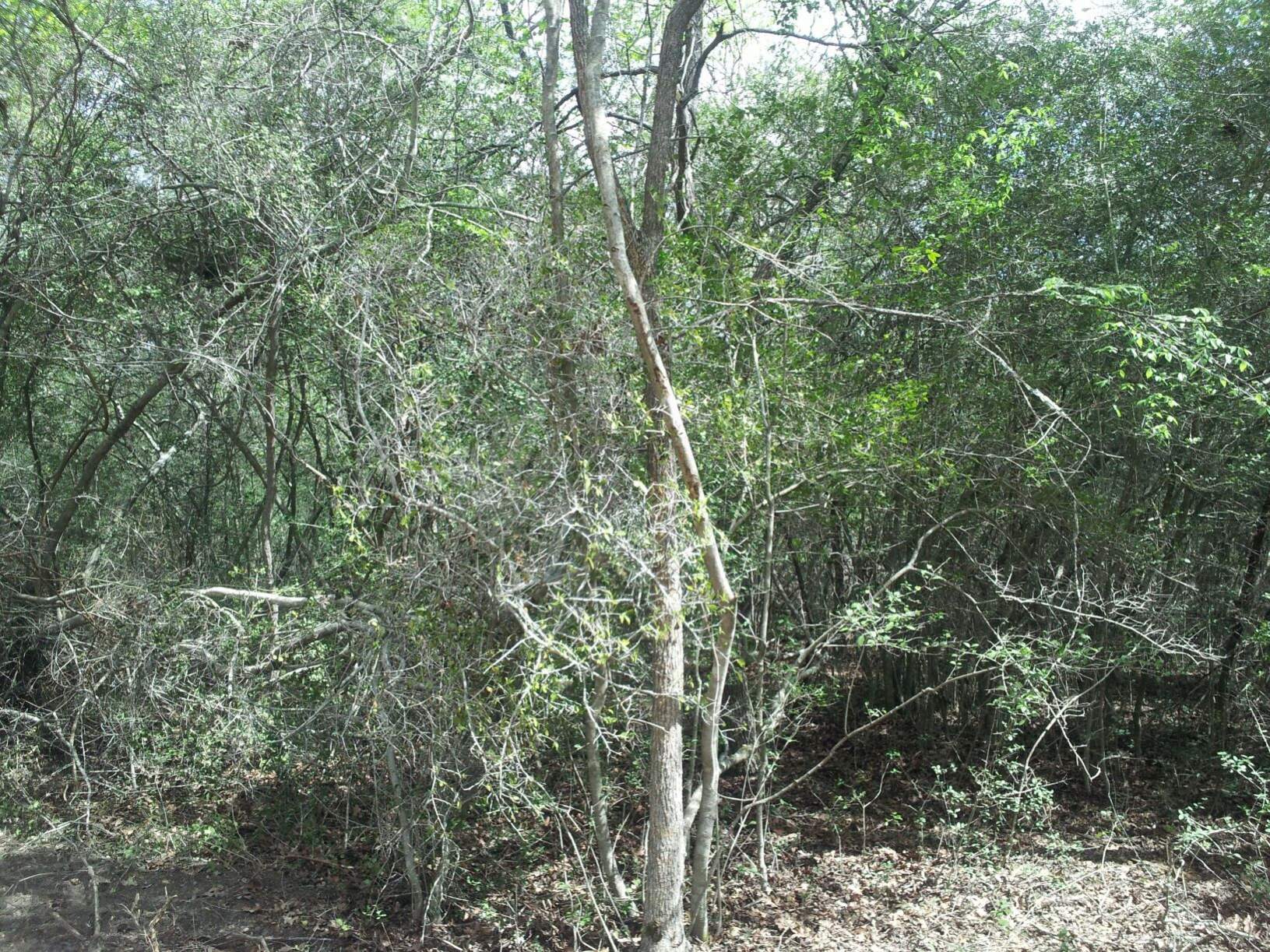

Post up some pics of the 3 acres.

Ya I saw rate for about that. Its actually cheaper to get it for a week. About $1500 for the week. When we do the burn do you normally call in a water truck or just drag hose from my well?
