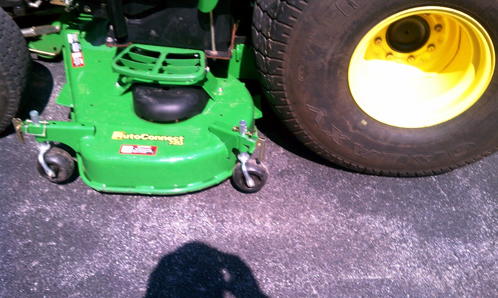

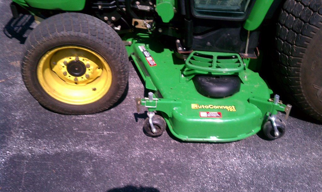

Update:
Dealer thinks the deck does not need any modifications to work with the Turf Specials. Deck seems to fit and clear the back wheels. Good for me. Need to get a couple of parts though as to mount the unit, apparently the mounting for my 3520 requires a couple of additional parts different from the 3320 to mount correctly.

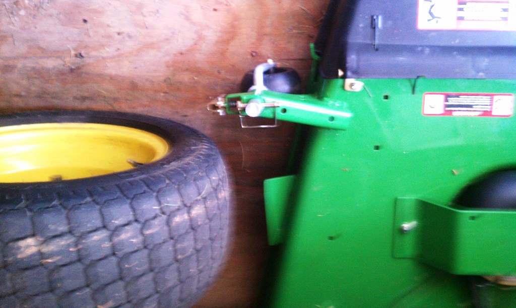

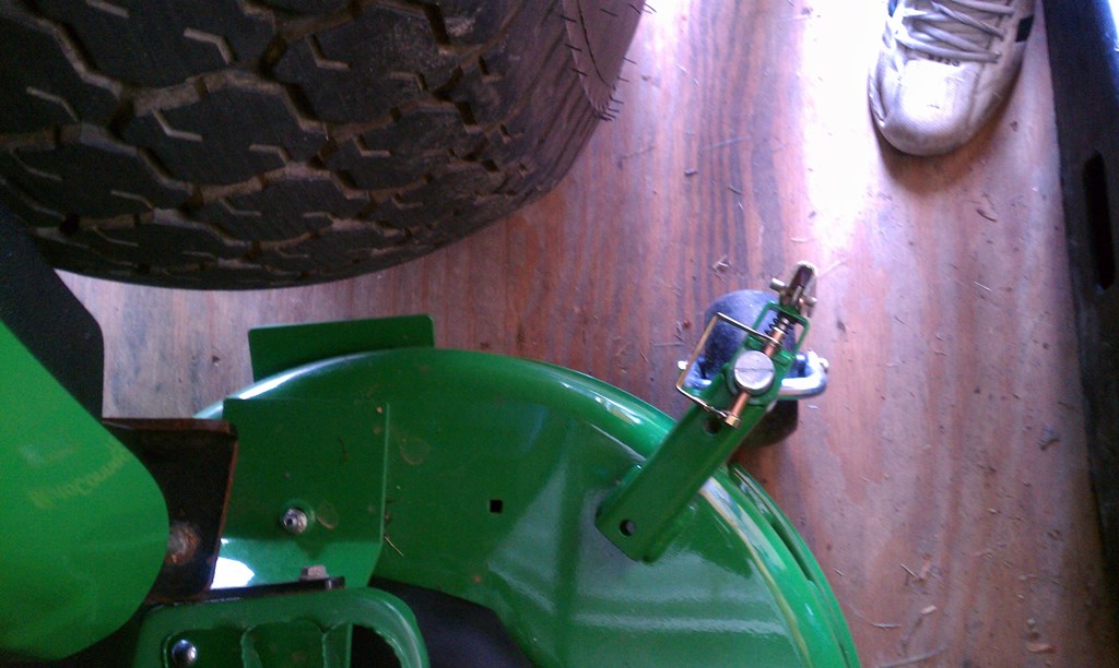

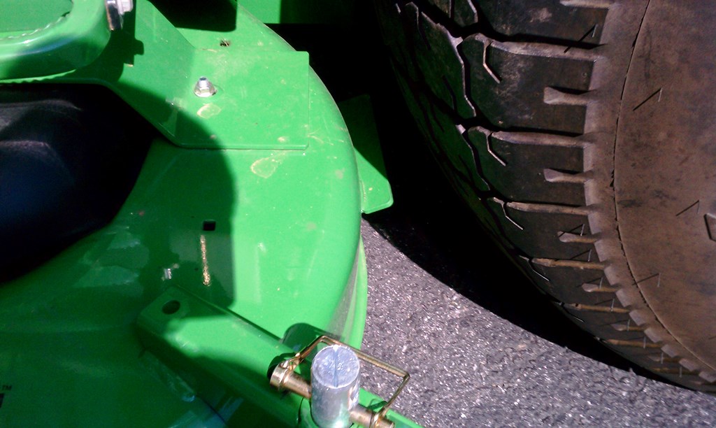

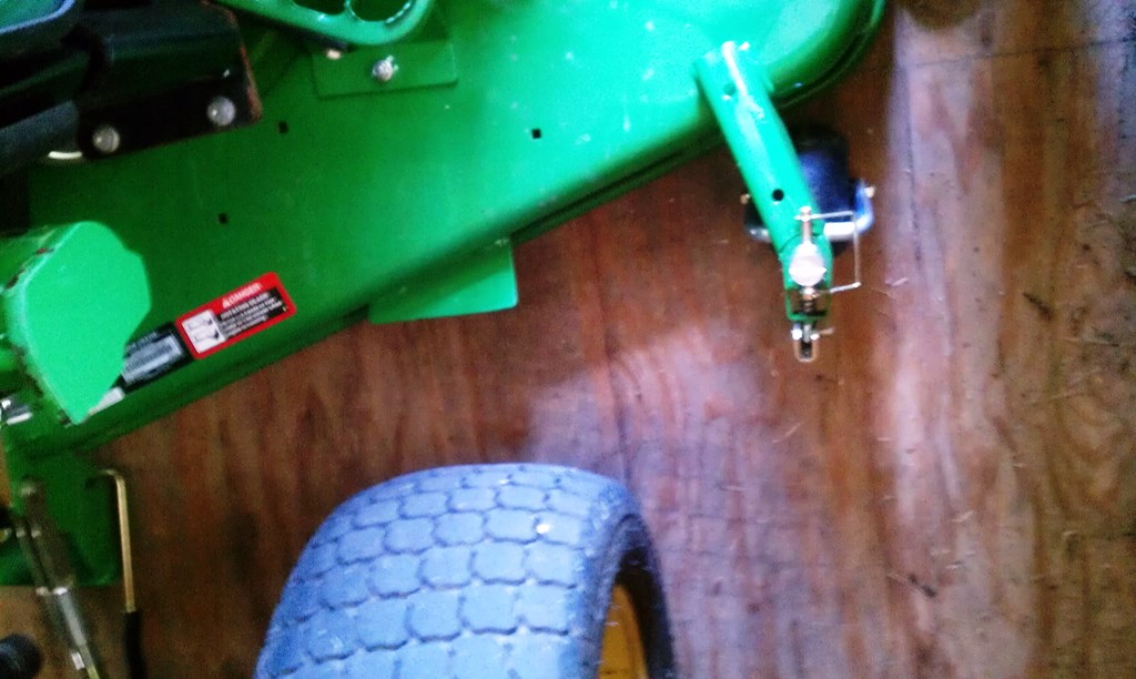

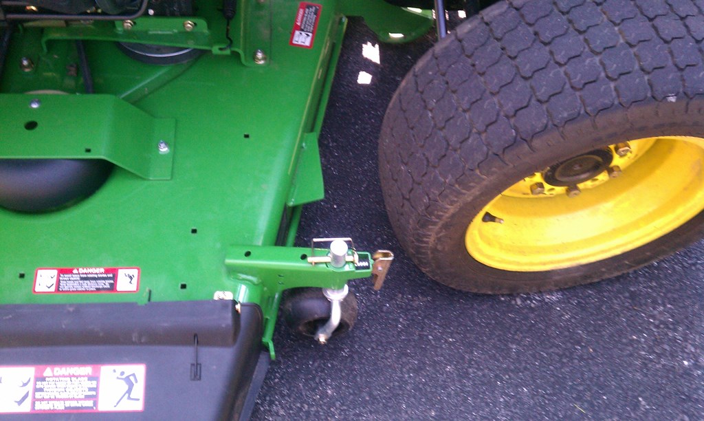

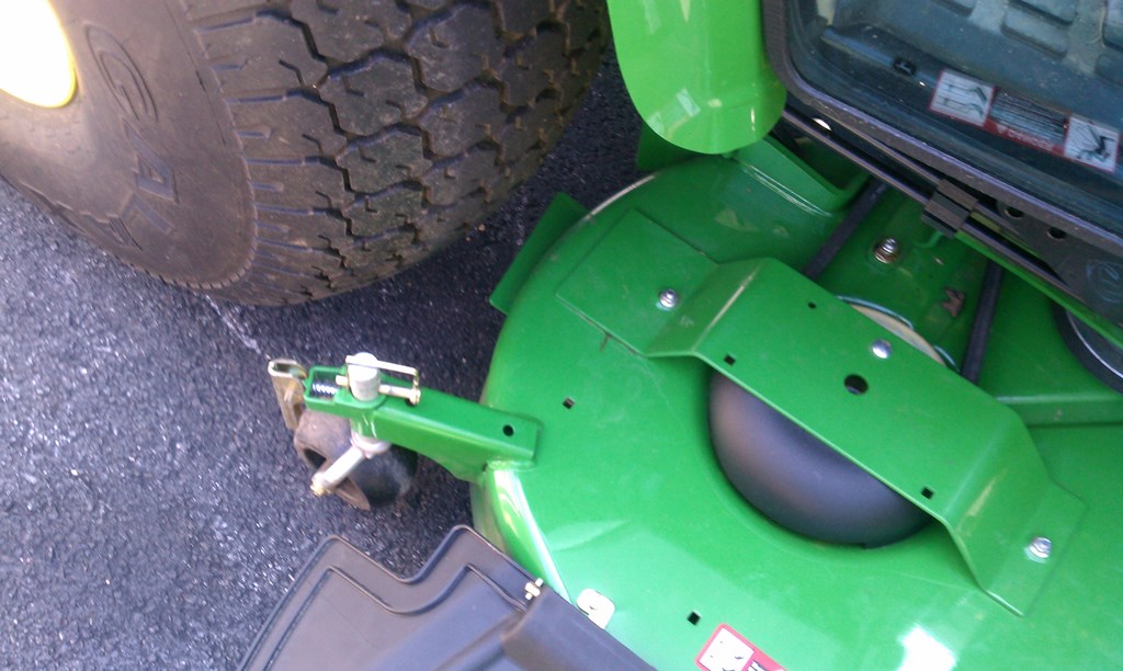

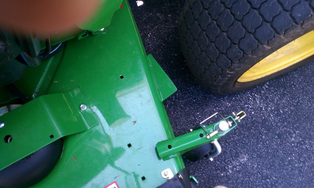

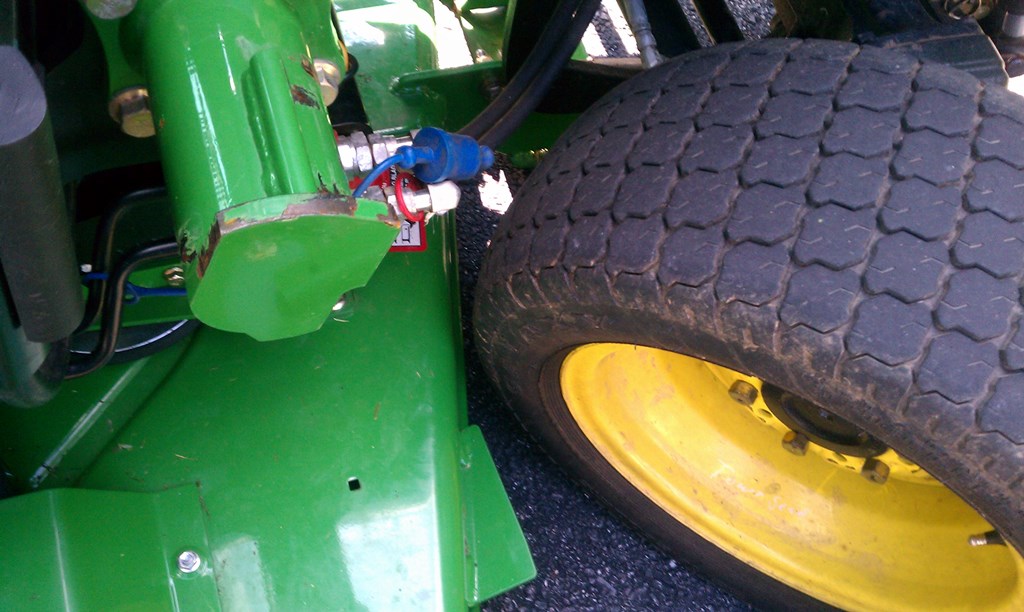

   / Pricing help on my MMM. Going to try to sell it. #28
Well now that the deck is on the tractor we did see where the interference is. The Front right tire makes contact with the deck where the protruding metal part is located that assists the tire when it starts its climb over the deck when removing the deck. Without this part the tractor will kick the deck around when you try to back over it to dismount the deck. I told the dealer to turn the tires over to the narrow setting to reduce the incidence of contact.
if that does not do it, then we will cut down the amount of metal on that side to further reduce/eliminate the contact. It only happens when the wheels are turned all the way to the right. No other contact happens. So that is where we are at this time. I hope to get it resolved next week and get the tractor back and post pics.
   / Pricing help on my MMM. Going to try to sell it. #29
The change to the narrow setting on the front did the job. The Front right wheel is the only one that is close. Tried the deck out, it cuts very well! Thanks again Chad!

   / Pricing help on my MMM. Going to try to sell it. #30
So the net result is no mods to the deck, flip the wheels on the front to narrow, and the deck is compatible with the Turf Special R3's!
