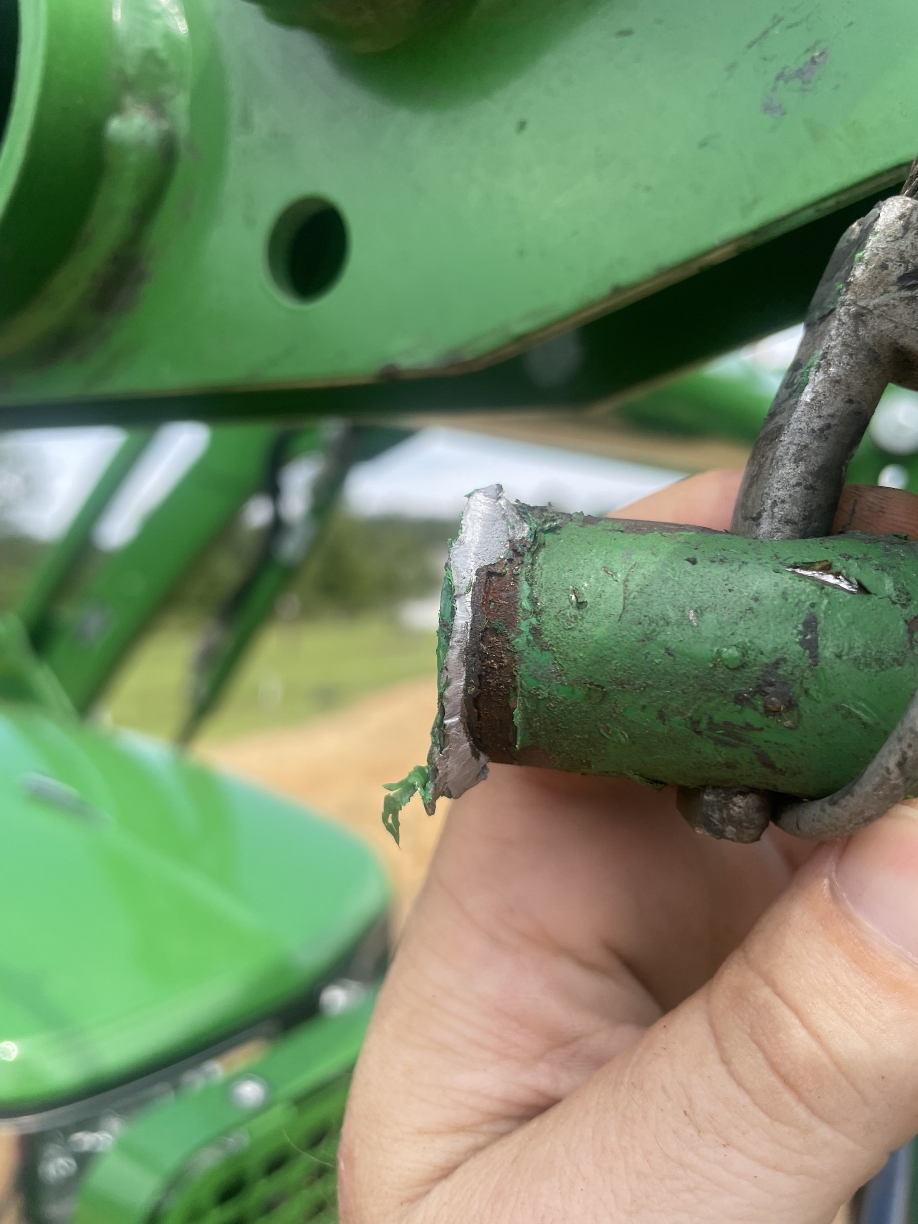

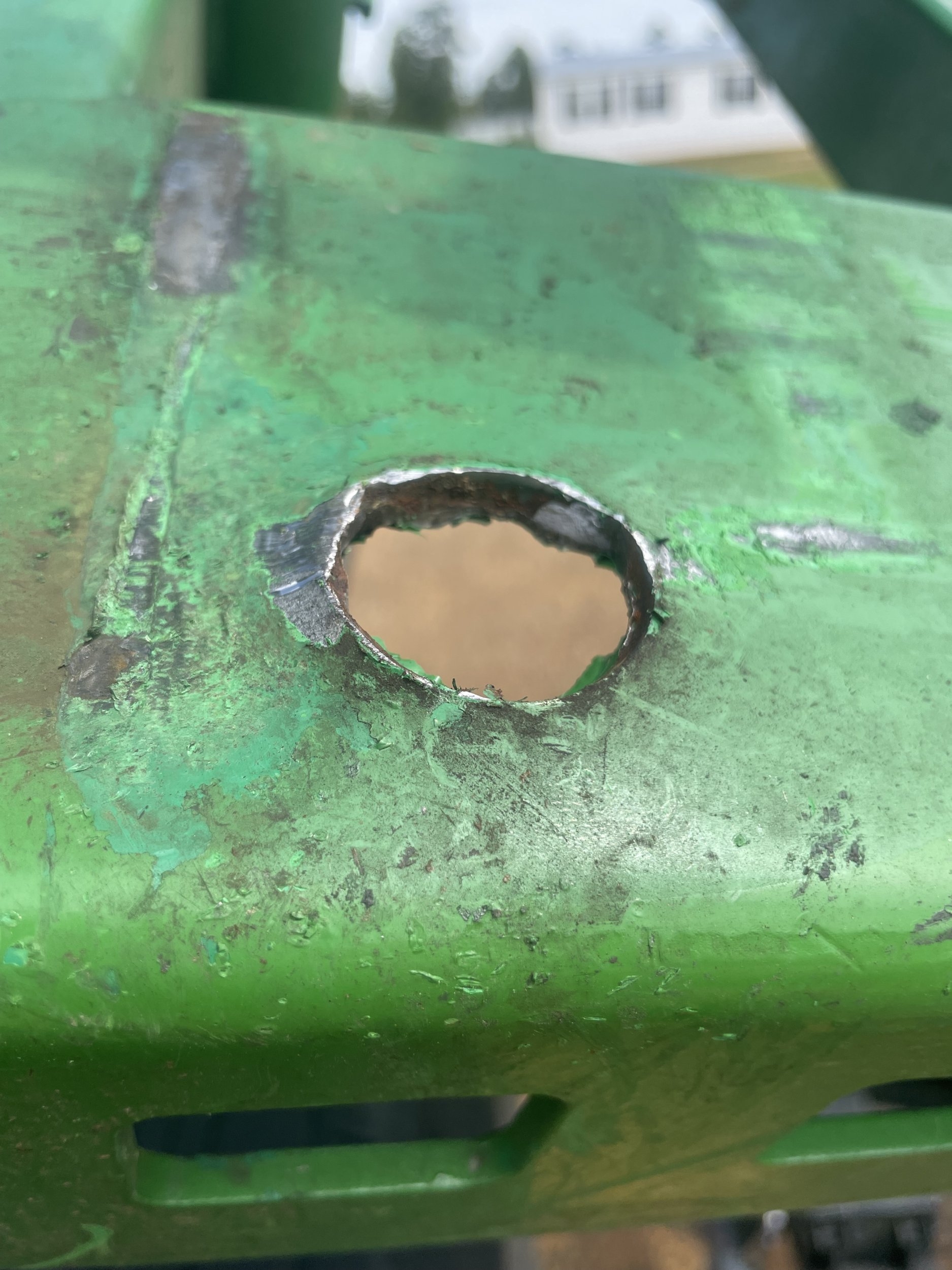

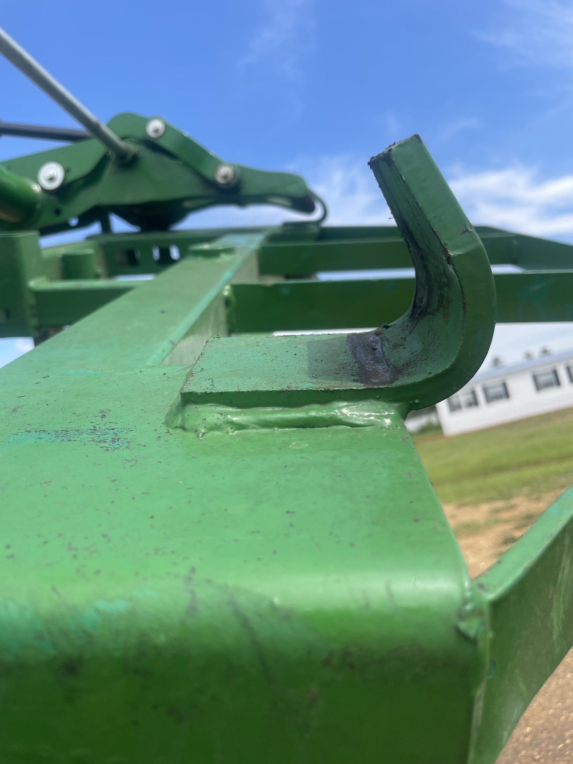

i have a 42" set for my JD from titan. i snapped off one of the pins and bent the hook on mine. my fault i stuck it in the ground when bush hogging but i let off te clutch in plenty of time, weld was penetrated less than 1/8 in. i doubt 4k lbs is achievable. they were a few months out of warranty. no help from titan
