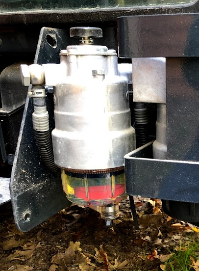

I have just changed the primary and secondary fuel filters on my MF 1840. I've turn on the fuel pump but not turned on the ignition yet. The pre-filter (clear plastic bowl) only partially fills. How do I get this fuel to fill? Thanks for any help.

Thanks, I've cracked the bleeder on the secondary and the injectors. Still doesn't want to fill.

So I figured it out (with some advice). With the 2 filters on my 1840, the key is to bleed the air from the top of the the "main filter" (steel canister), labeled #2 in the owner's manual. Once I opened that 19mm bolt, the clear bowl "pre-filter" filled right up. Thanks to everyone for their assistance. I was getting tired of swimming in diesel for the last couple of days trying to figure it out.

You were correct in pointing me in that direction. To be clear, on my tractor, I need to turn on the key so the fuel pump is on but not turn on the starter motor or ignition. The electric fuel pump is located between the 2 filters and pulls and pushes the fuel through both filters.
