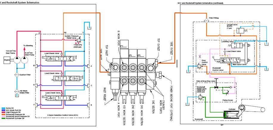

If a Prince SV stack valve (or any brand I guess) is placed in a hydraulic system that already contains a system relief valve (I am talking about a JD 3320 tractor here) can or should the Prince relief valve plug be removed and replaced with the optional no-relief plug assembly or can the Prince relief valve just be set to relieve at its highest settings thus turning into a no-relief plug?
The Prince valve comes from the factory set to relieve at 2000 psi and the JD valve relieves at 2500. I would think you should have only one system relief valve in the system. Setting the Prince to relieve at 3000 psi should make it to where it would never relieve, effectively turning it into a no relief plug.
Any help in understanding this would be helpful.

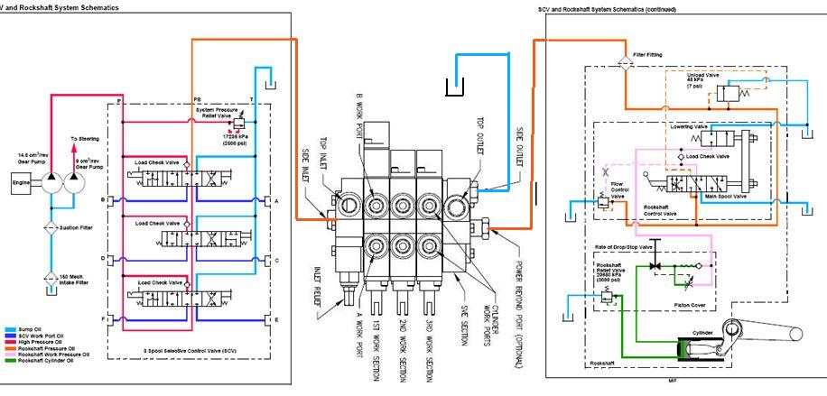

My crude hydraulic schematics.
Pic 1 is of how it is now. Pic 2 is where I want it to be (Power Beyond feeding Rockshaft).

Your new extra valve stack RV setting will basically not affect the RV (2500) in the selective valve because the new valve and rockshaft can not operate while operating the selective valve. For that case, the new valve stack RV can be set below 2500 psi like 2000psi. But then these 2000psi will limit pressure for the rockshaft to 2000psi. So best best is to set the new valve stack RV to like 2600-2700psi, and that way let it just be an extra safety RV.
I agree with you that pic #2 is the right way to plumb it. Pic #1, shows power beyond out from side outlet, which IMO is not good. I would not pressureize the return core of the valve.
Just make sure you have a "POWER BEYOND PLUG", in the power beyond port.
