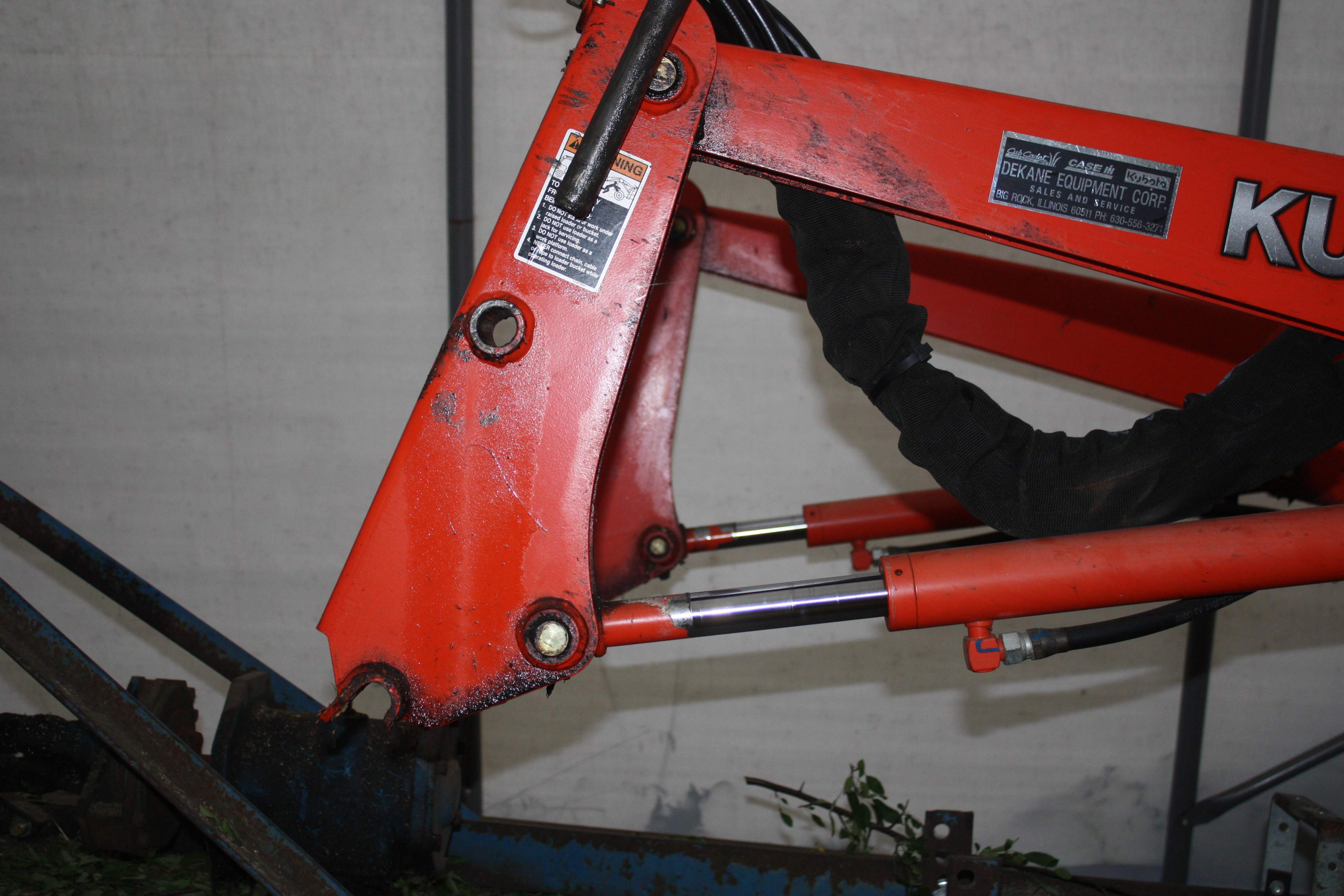

New problem mounting my FEL: When I tried to mount FEL I noticed the boom cylinders were extended by different amounts, see photo. One is extended about 2-3" more than the other. If I connect the FEL to the control valve (with FEL dismounted) and cycle the boom cylinders, they stay2-3" out of alignment until one fully contracts, then the other one finishes contracting. But when I extend them, one begins extending first, the other one doesn't move until the first one has extended about 2-3".
If I put FEL in float position (with FEL dismounted) I can manually contract one cylinder, which forces the other one to extend until they line up. But as soon as I try to cycle the cylinders again they get out of alignment.
So I managed to mount the FEL by pushing on one side with the frame. I get it all attached and cycle the boom and everything seems fine, so I dismount it and the boom cylinders are lined up. But as soon as I cycle the boom cylinders (with loader dismounted so there's no load on cylinders), they get out of alignment again.
What's causing this, it makes it really hard to mount the FEL?

One side has more resistance than the other. You might get lucky and just be able to lube the pins, or not. It really isn't that big of a deal. It is rare that both cylinders will have the same amount of resistance and hydralic fluid will always take the path of least resistance.

Something is leaking or bleeding. When I take my FEL off I lift it out of the pins while the tractor is running. Then I shut the tractor off and cycle the hydraulic control stick in every direction with the hoses hooked up until all movement quits. This completely bleeds all the pressure from the cylinders and seals. If your cylinders get out of time while the tractor is still running I would think it would be in the tractor control valve. If the cylinders get out of time while the loader is sitting I would think a cylinder is bleeding off.

Yes, this is what I thought. They both move freely, as evidenced by the fact that I can cycle them manually (with a little help from a 2x4 lever) when they are in float position. I'll try to make sure I only roll the bucket when I dismount the FEL. I guess I'll just have to bump the one side with the frame as I mount it. I have a dirt floor so there really isn't much resistance to push against, it tends to move the loader crooked before I can mount it. Maybe I need to pound a few stakes in the ground for it to bump up against to stay straight.

Rare, but a loose piston inside the cylinder that lags is possible, but doubt it.
Is the amount of 'lag' always the same ?
Once the one that lags starts to move, does it move the same speed as the other the rest of the way ?

My LA211 does this a lot too. Normally, after getting into position, one would engage "Dump" to lower the arms into engaged position. If they are too low, and/or out of alignment with each other, some adjustment is needed. Before connecting the hoses, you can bring them into alignment simply by pushing on the one that is extended the most; the pressure going in will force the other one out. Once the hoses are connected, if the arms are not extended enough, push the lever to the "Up" position. This will make them move back toward the mounts. If one contacts first, it will stop while the other continues, then makes contact.
If they become too far extended, you will need to retract them by putting the lever to "Down" which will pull them back toward the loader (they may retract one at a time, or not at the same rate). Ease the tractor forward, then go to "Up" again to move them back toward the tractor. When they are correctly aligned, use the "Dump" position to engage the end of the arms with the sleeve.

The amount of lag appears the same, but I didn't measure it, and I've only done this twice, so based on a vast statistical sample size of 2, it's always the same.
Once the one that lags starts to move, it moves the same speed as the other one the rest of the way.

2-3"
Is that actual cylinder movement ?
Yes it's actual cylinder movement, you can see it pretty well in the photo by comparing the amount of cylinder that is exposed on each side. I couldn't get up high enough to take the picture from above, it's easier to see from that angle.

I'm going to put another 2 cents in here. I'm quite sure my sample size is larger than many here. Having worked in Kubota dealers for 12 years and outside Kubota dealers for another 11 years. I have installed and repaired hundreds of Kubota loaders and many others too. As I said before, most will do this because the resistance side-to-side in the pivot points and internally in the cylinders is rarely the same. Hydraulic flow will always take the path of least resistance. It does not matter whether it is a Kubota, New Holland, John Deere, etc., the same laws of physics apply. Typically you can just push on the arm that is too high and the fluid will move to the other side and extend that cylinder. As soon as the operator figures this out, it does not change the ease or difficulty in installing the loader. If any operator were to take a machine to the dealer with this complaint, they would give the same explanation and send you home.
