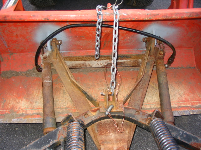

If you've read my " Hauling the bota" post you know I trailer my bota regularly. That being said, it often easier to pull the trilaier out or park it when I'm done with the tractor.
Problem is, I have my grader blade on the 3 pt, and bucket up front.
I have a 3 pt 2" receiver mount but don't feel like swapping the balde and hitch each time, I have a bucket clamp for my ball but you can't see the ball to hook up and there is a lot of stress on the bucket, not to mention the bounce in the FEL with the trailer weight on it.
I actually used the top of the blade pin, as a temporary ball but quickly bent it...
I then bought a ball and just dropped it in the rear blade but knowing that it 's loose it'll wiggle alot , I'll lose it and need to remove it when I angle the blade.
So I now have the first rear grader blade / 2" trailer ball.
Works great, and I won't lose it.:rolleyes:
And if you haven't figured out yet, I bought a welder and now need to weld EVERYthing:D

Just be careful on tight turns. I have a similar ball hitch on my blade and I was pulling a rented chipper and bent the heck out of the tongue jack on a tight corner.

No offense (because I suck at welding), but how much do you trust that weld? I wouldn't be pulling anything heavy up a hill with that setup, unless you really trust your welding skills.

Yeah, Pretty good welding. Took classes years ago, and have done a few welds here and there over the years , most good some not so good. But now that I have my own welder, Plenty of time to practice again. Like ridding a bike...
I trust that weld plenty!!! Trust me I swung a maul at it to prove a point to a buddy who was of the same thought process as you...
There is 4" of bead on that ball, Probably be metal fatigue and fracture of the ball before my weld let go.
Take a look at this pickture of my bucket with welded tabs for my plow...All season beating on it and they haven't budged.
Welding is an art.

I put a 2" reciever tube on the top of my box blade because I was always wanting to move one trailer or the other.
