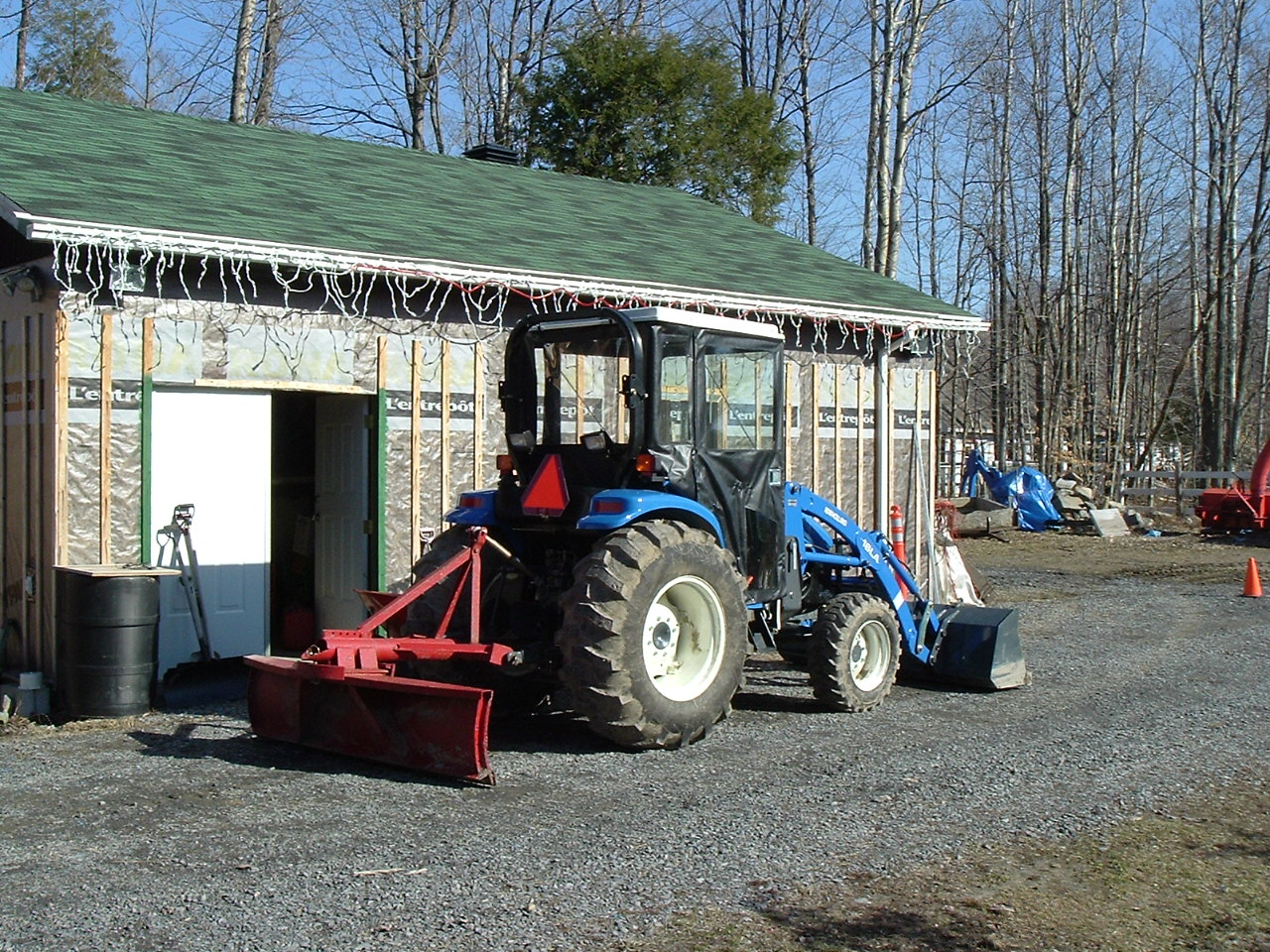

I have a Boomer TC45D and the PTO is turning non stop. Even when it is not engaged. The only adjustment I found is for the switch so that I cannot start the tractor with the PTO engaged.
Does anybody know how to adjust and/or fix this problem? The dealer was not able to tell me how to do it myself, I would have to bring it to their shop so that they can examine my tractor....

Boomerpier, your tractor has a completely independent PTO that runs off a hydraulic clutch/brake. The fact that it turns when the lever is OFF (and I assume also the light on the dash is OFF) means that the clutch/brake is worn and in need of replacement/repair.
Let me be a little more clear. I am guessing that your PTO lever works smoothly back and forth and the the dash PTO light indicator illuminates and extinguishes when the PTO lever is moved forward/aft in the slot on the fender. If the light stays ON, there is a chance your lever is bent or slipping and not functioning properly. The PTO lever on your tractor opens a hydraulic valve that pressurizes the PTO clutch and makes the splined stub spin. When the clutch is released, it has a brake that stops the PTO from turning and stops the splined stub in just a few seconds. If the clutch/brake is working properly, you cannot turn the PTO splined stub at all when the lever is off.
What happens in most cases, is that somebody doesn't know to lower the engine rpm before engaging the PTO and also lower the rpm before disengaging the PTO. When you have something big like a rotary cutter attached to the PTO the forces required to start it or stop it are tremendous. You can preserve the PTO and extend its life by slowly engaging at about 1000 rpm and disengaging only after the engine rpm is reduced.

Whitetiger, that is not true for this condition. The interlock to keep the tractor from starting works completely off the PTO lever. If the light on the dash is OFF, then the tractor should start normally. Pierre may find that with a rotary cutter or other implement attached, the PTO will slip, but he will have to have the engine completely shut down when he hooks anything to the PTO stub. I agree with you that this is NOT the best/safest way to operate, especially if the PTO won't slip at all when turned OFF. In an emergency, this would work, but not be something I'd want to do all the time.
Dopplegangar, you are correct that this requires splitting the tractor at the rear differential. That is the 1st step in the New Holland Repair Manual. That's easy to say, but a huge job on the TC45D, especially since the OP's photo shows a soft cab. The operator platform has to be raised up/removed to allow the differential split. The repair is fairly simple and straight-forward, but getting to the problem is where the big labor hours/cost will be.
Pierre: I'm very sorry you have this problem. My tractor has a few over 1700 hours and the PTO still works just like the day I brought it home. I've been extremely lucky and am very careful with engaging/disengaging. I think once your PTO clutch/brake is repaired, you'll likely never have another problem with it. I just wish it was not going to be so expensive for you.:(
