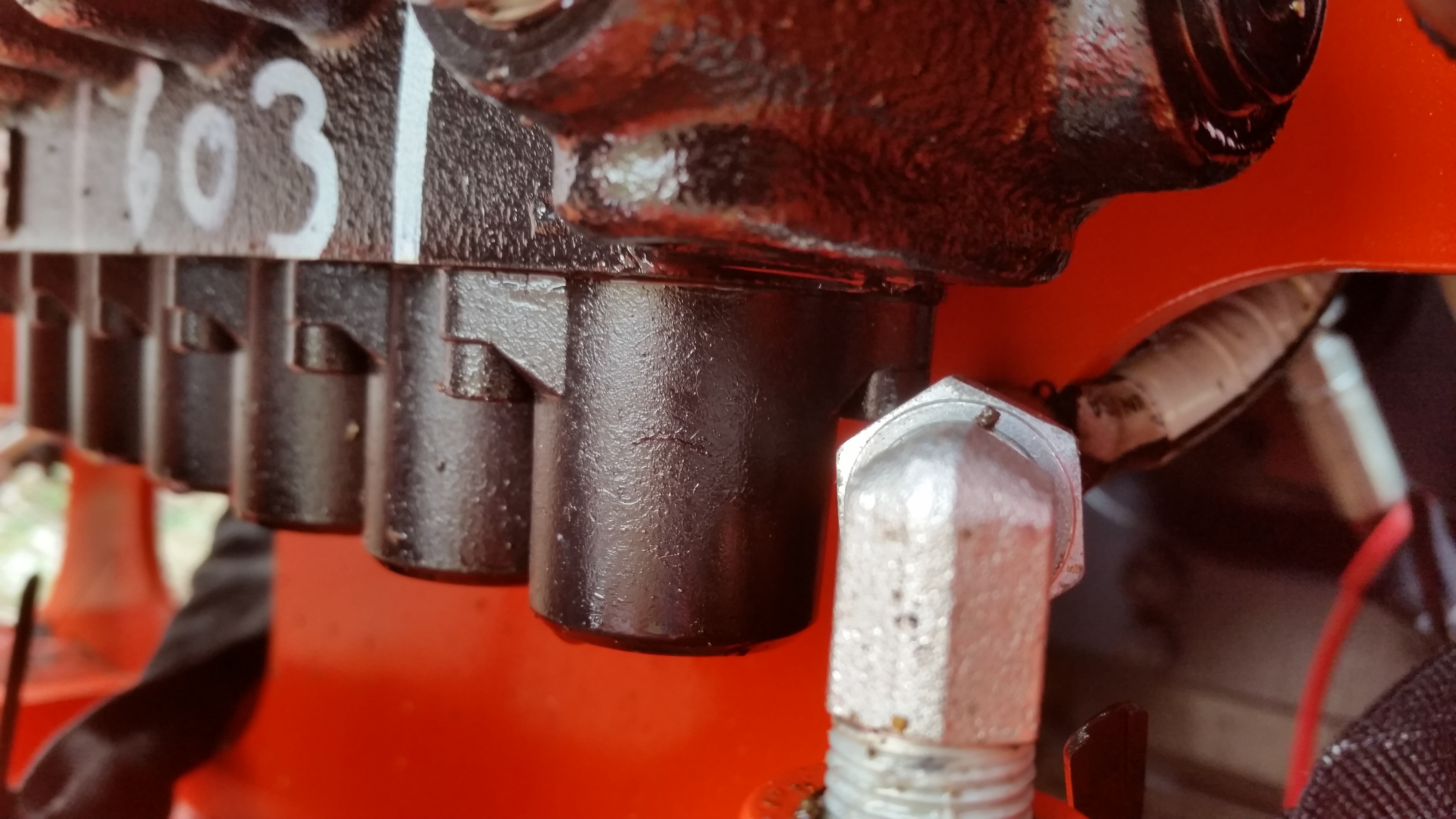

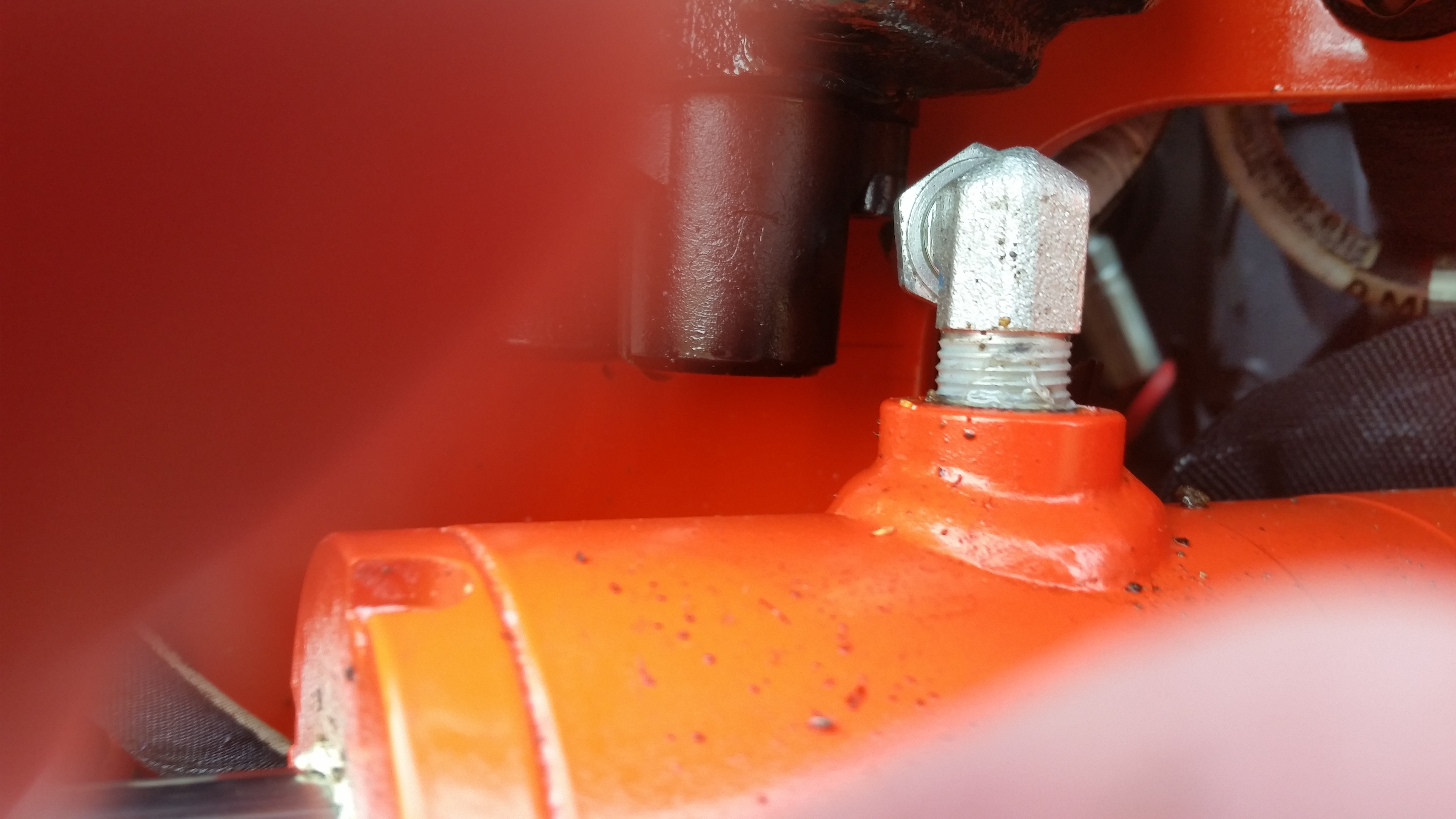

I tightened the fitting on the swing cylinder and the leak seems to have stopped. Took a pic of hose to check the clearance and wow, its rubbing.

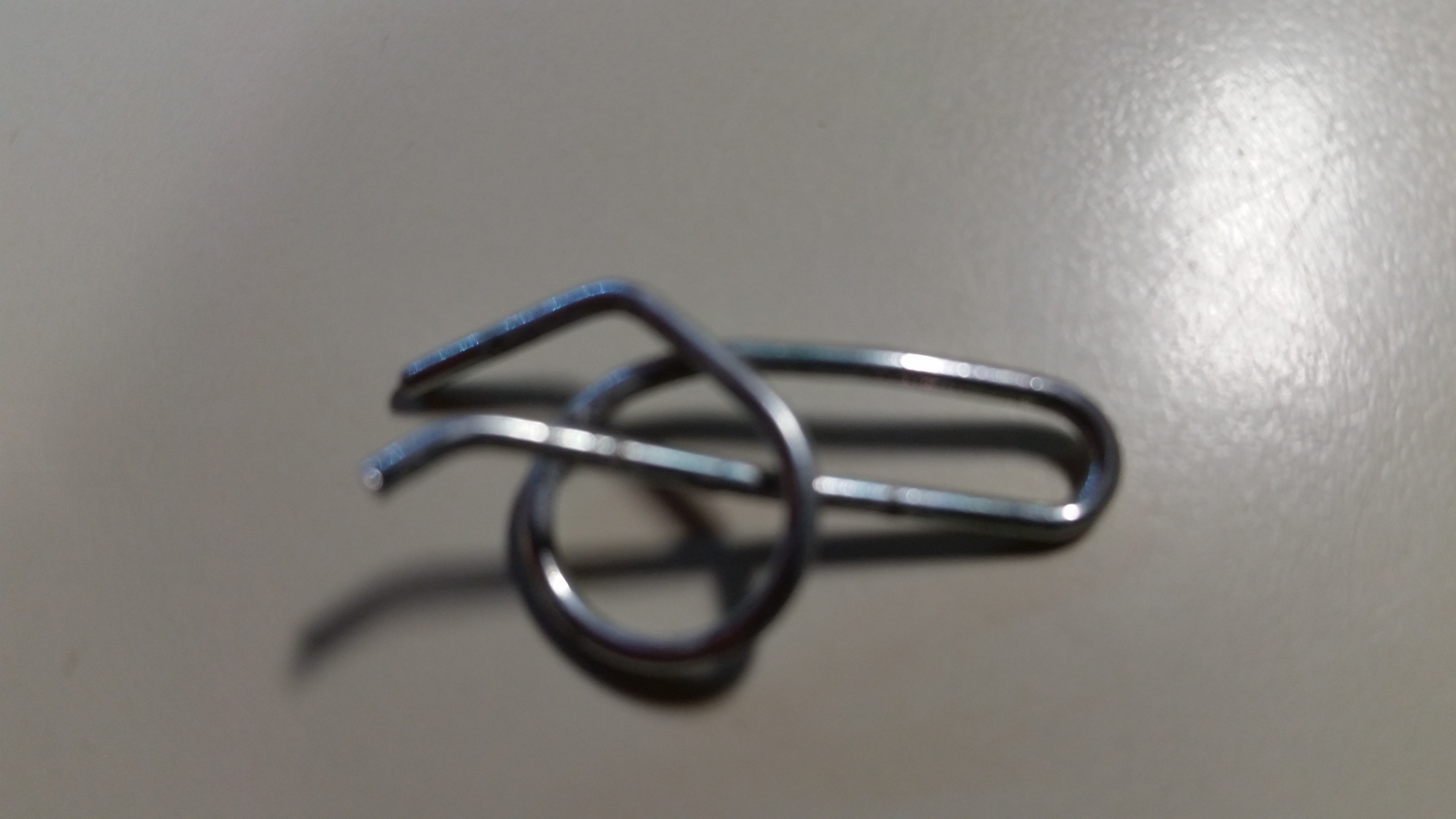

Ok dealer came out and replaced the hose for the swing arm. I told him about the post that says to move the angle of fitting (thanks RickB) so it don't rub and he agreed. Problem resolved. On the tape job on the seat switch, we untapped it and there was nothing wrong with the wire or switch but someone thought it was better to tape it up to keep water or what ever out and just didnt do a good job. I retaped and dont think there will be a problem with that.The seat lever I think the whole problem was the cotter pins they use on the Kubota tractors will add pic.I put the old fashion cotter pin back in. seat should be good.

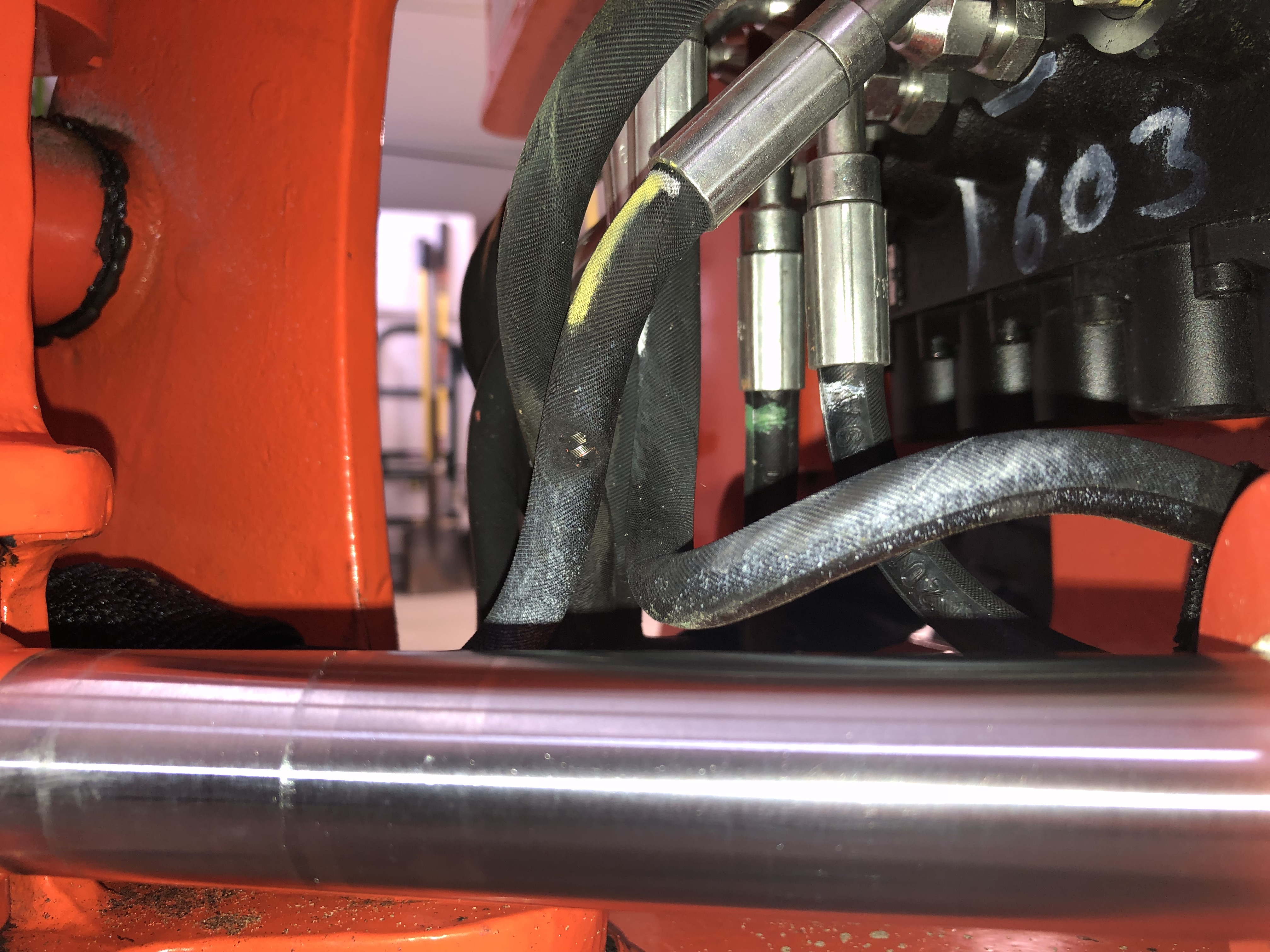

New SC-TLB owner here. Just picked up my new BX23S last Wednesday. First day of use, after about 3 hrs, I saw hydraulic fluid spraying out of a BH flare fitting. Two of them were loose and a third hose was rubbing on the swing cylinder at full left. Tightened the fittings and moved the one hose slightly to avoid rub. Should I worry about the amount of rub I have on this hose? Second question / observation. 11/16 does not seem to be an exact fit for the flare fittings, there is a tiny bit of "slop". Is there a special wrench for these?

I think all of the kubotas are metric so try a 17 mm instead of 11/16. I love my new bx23s now that things are working right on it . I used it sat and sunday clearing trees and brush and digging out trunks hope yours works out. also looking at that hose I would get that replaced under warranty
