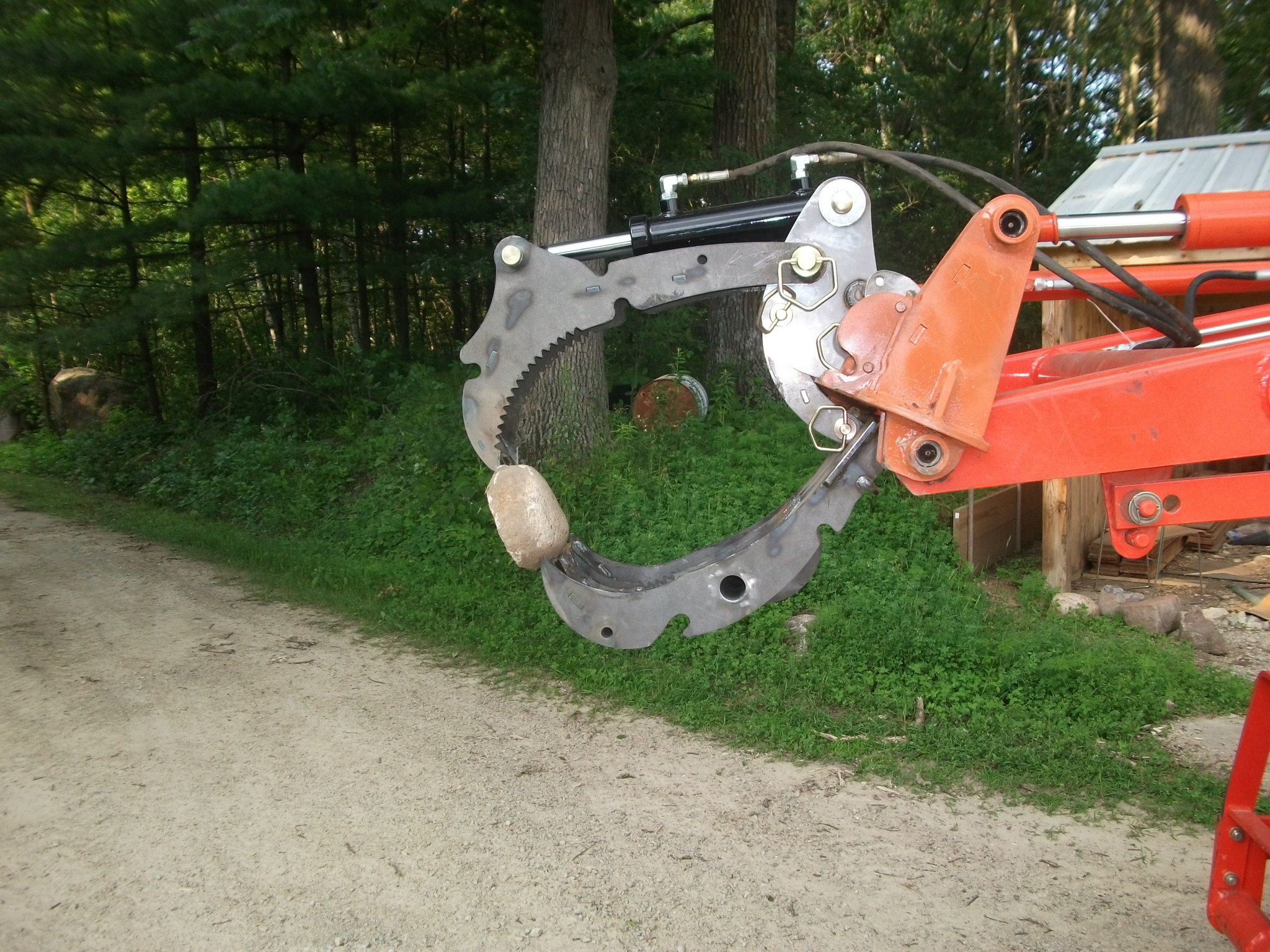

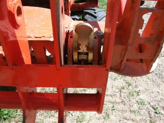

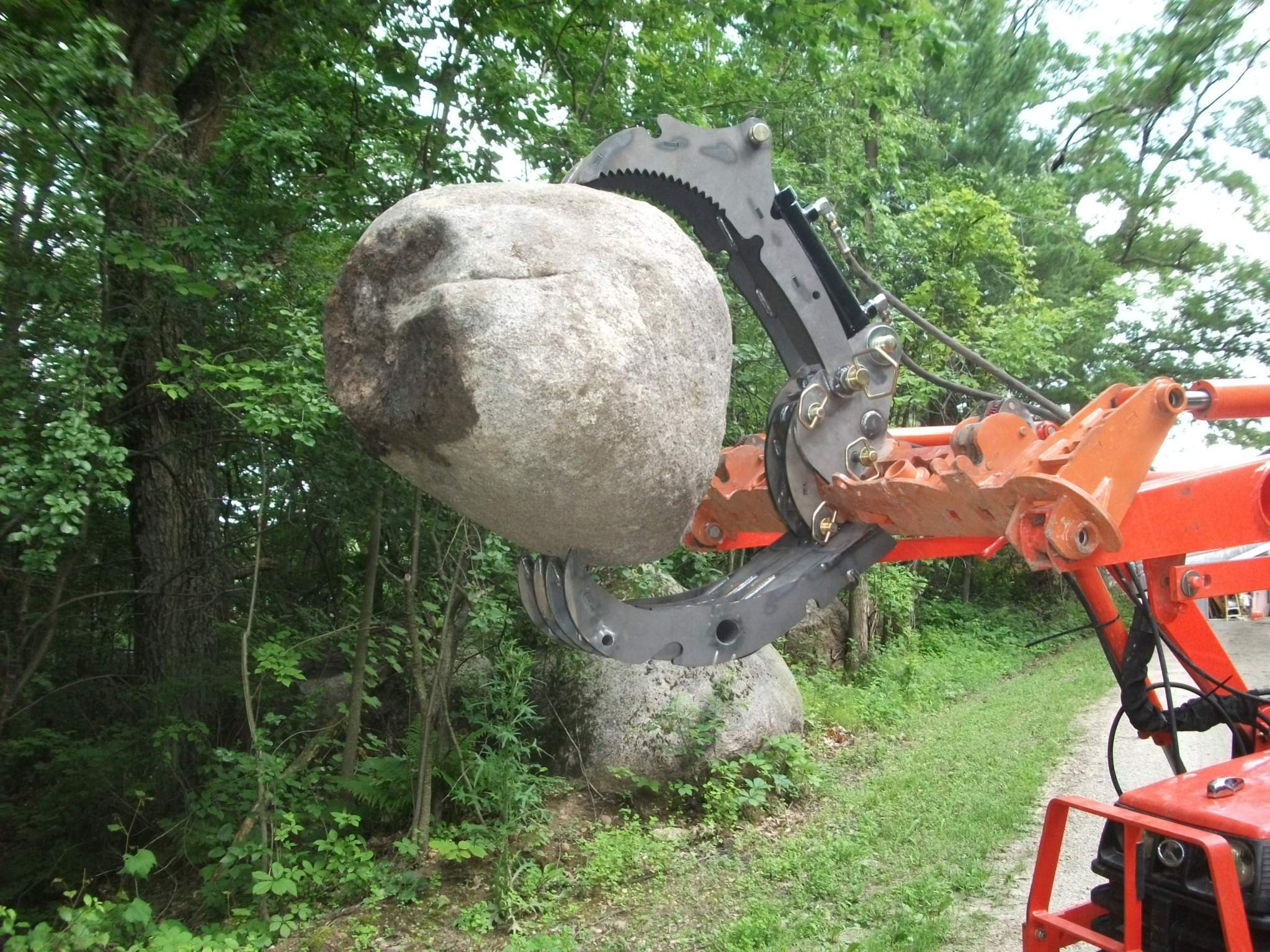

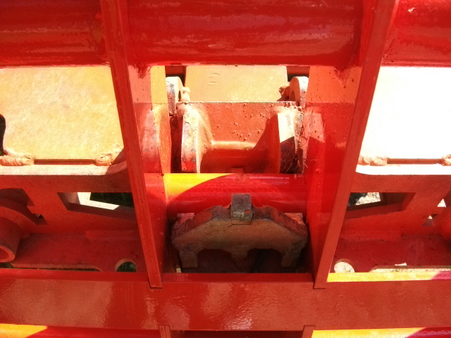

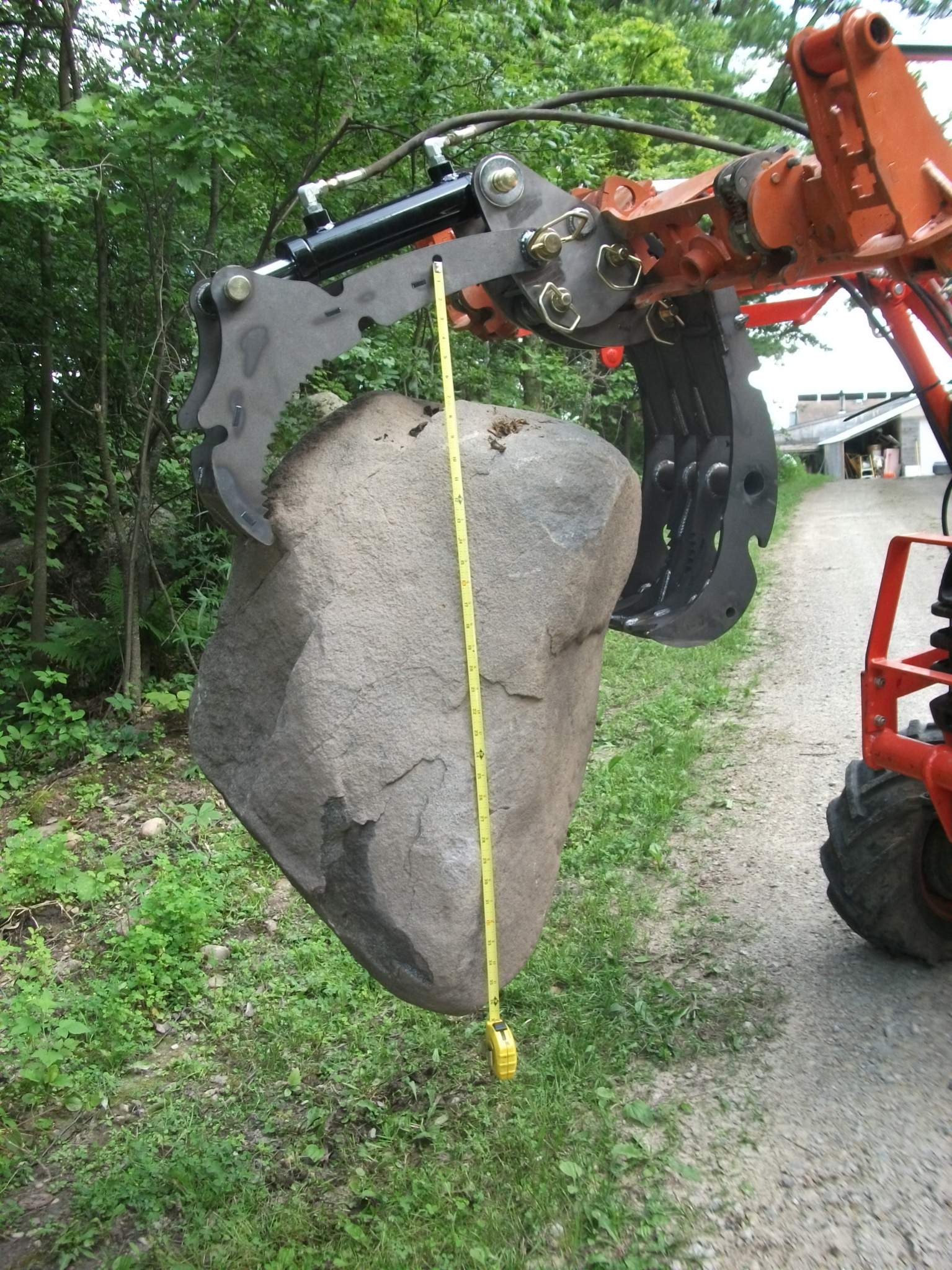

I made my own and couldn't be happier.

so the man with the big rock, is your a Q/A? i couldn't tell from the pic, it it is do you have any more pics?

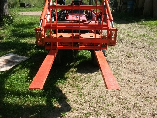

I have the ATI SSQA and love it. I worked it into the deal when I bought the tractor last yr. As for the bucket the dealer kept my original bucket and put on a Woods 60" bucket that comes predrilled for a reversable cutting edge. All in all I think the setup is great, i use my forks as much as I use the bucket.

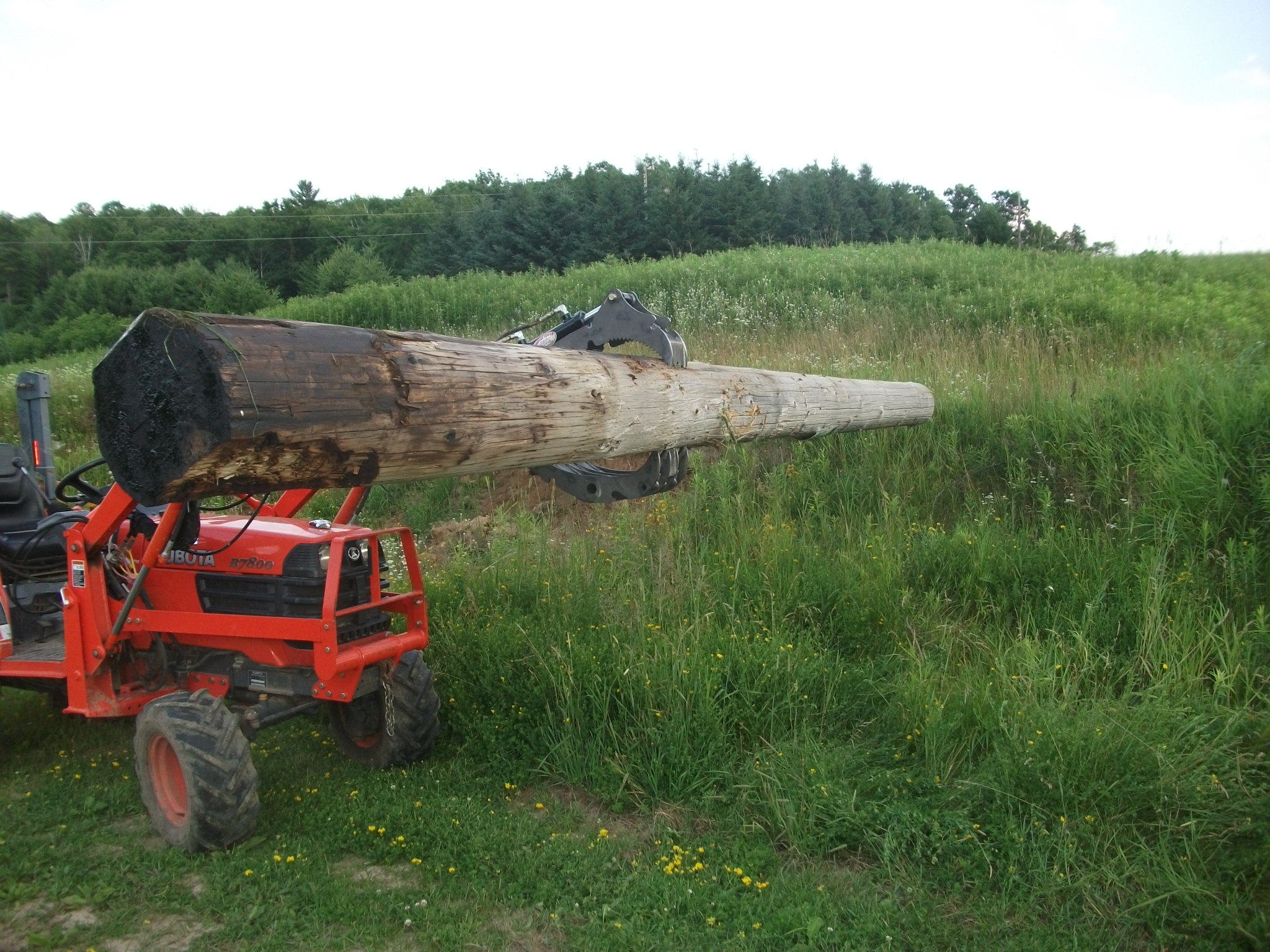

Yes it is. I took the BX Tach-n-Go and adapted it to my B7800. The grapple is a Q/A as well, #100 including the cylinder. So basically all the stuff made for a BX you can use on your B7800. If you want more pics just ask.
