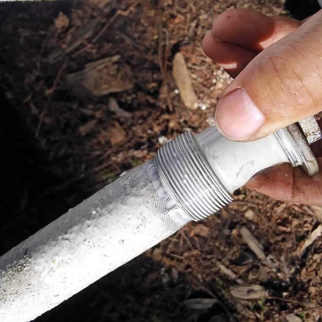

There is a hydraulic filter and a hydrostatic filter. There is also a screen in the rear sump. You definitely need to drain the oil for the screen. I recommend cleaning the screen. Both I have done, the screen was filthy. You need to order the gasket for it. If you dont know the last time it was cleaned then you should do it. It is on the suction side to the pump so can cause problems if it gets clogged.
Yes, there is a suction filter, and I agree it should be cleaned. On both 4300s I had, I also removed the PTO cover in the rear to full empty the sump. There was a lot of debris in there, primarily from wear and breakage of the PTO clutch and brake.
If you get any water contamination, cleaning the suction screen is critical as the boogers that build up there resist fluid flow. I am working on a Kubota now that had significant amounts of water get in.
   / procedure to change hydraulic fluid 4410 #17
Yes. I was surprised how much shiny and black stuff was in there when I removed the rear cover. And no damage or repairs, just preventative cleaning.
