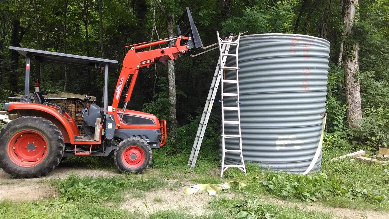

Side hill & doorway. Make the cut 8-10" off the bottom, drain pipe to daylight, then fill with gravel. I can cut it out with a zip saw, insulate both sides with 2" high density foam. Didn't get a chance to tip it up yet....maybe today.........
   / Project Root Cellar ......out of a 8' tall x 14' metal culvert
#24

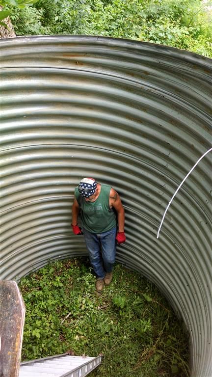

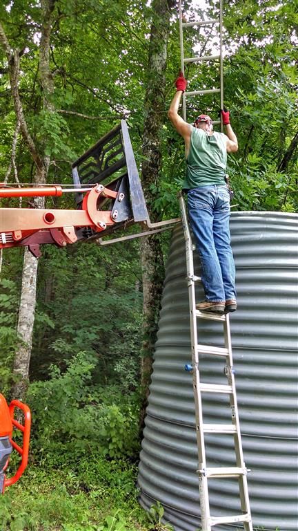

I flipped it with the tractor forks:
I'm 6'4"' and it made me look small:
Ok, Vertical it is...the thing is bigger than it looks, plus I can use the interior posts to help support the roof, and build a "attic" in the ><3' of dead space above our heads. Cost will be minimal and then there is the cool echo factor :)
   / Project Root Cellar ......out of a 8' tall x 14' metal culvert #25
That picture really shows the space you have in it. I was worried that you would not have enough space once shelves were in place. Cant wait to see it finished!
