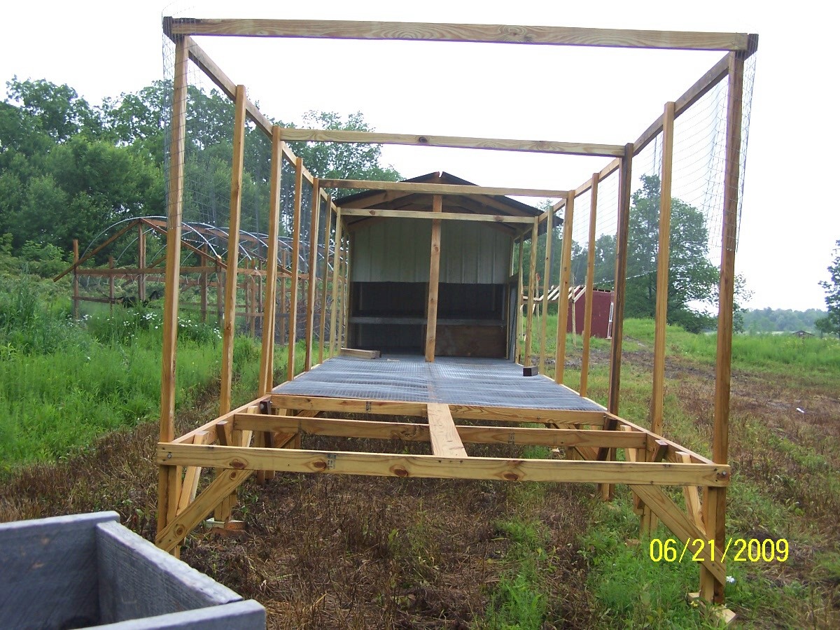

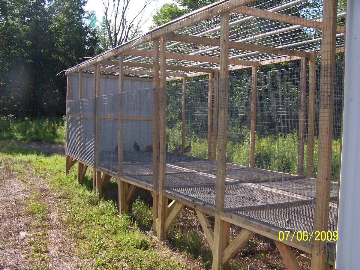

After we got a few frames built we started to lag them together. There is two section which is 16 X 8 that have a roof to protect young birds and the their food from the elements. We found it easier to do wire in one big piece it take a few hand but once you have in place goes quick.

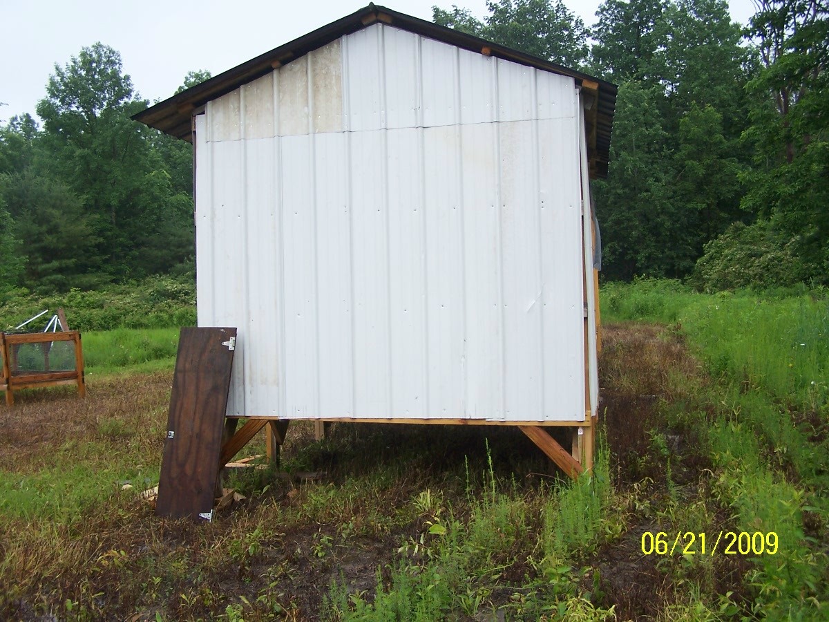

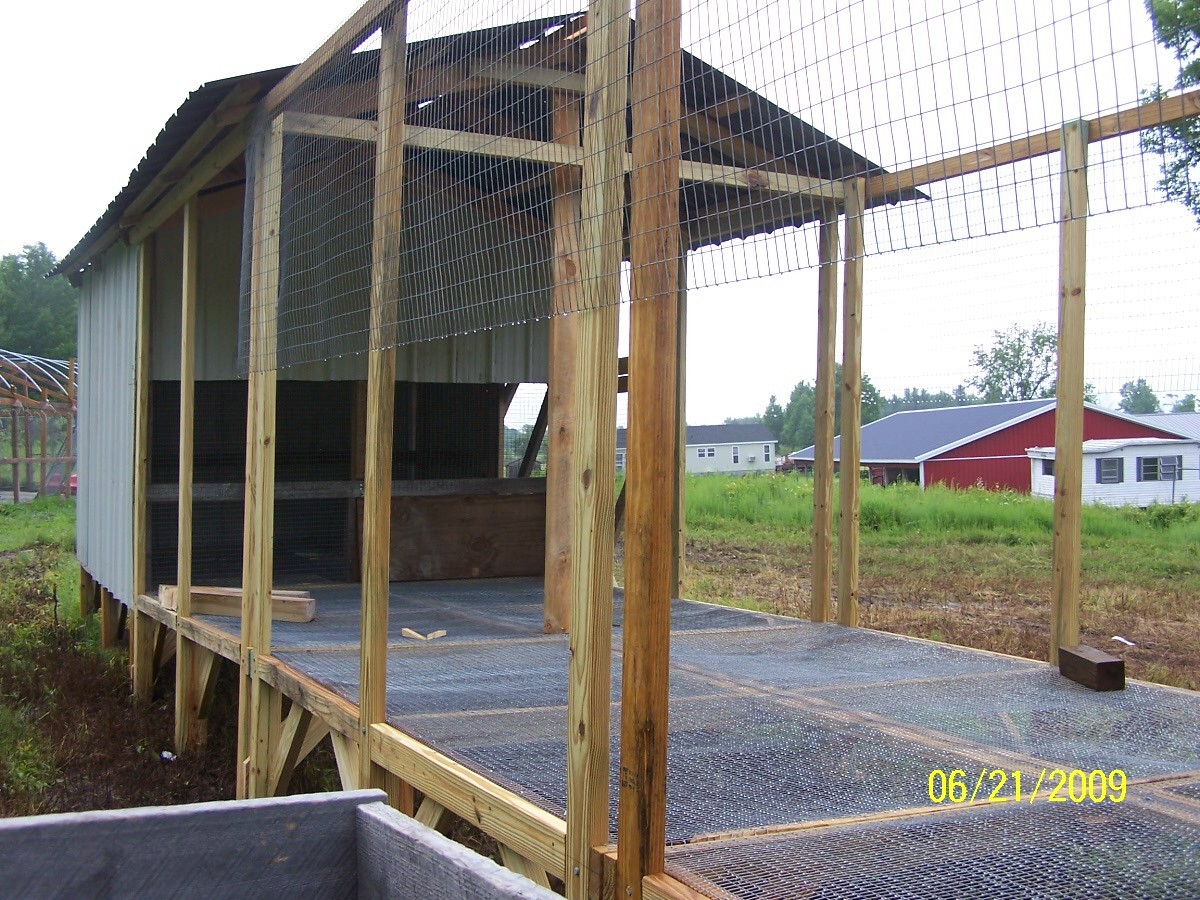

I am not sure how many chukar or quail you can fit in the pen I do not remember the square footage per bird by my chuckar pen will hold a few. I made the top out of cattle wire panels and chicken wire. Somebody I know had two inch pvc they pulled and was going to throw out so I used that tie chicken wire to. And the top is supported with the 2 X4 from each frame it could be stronger but I have not had trouble and we have some pretty good snows here.
My plan is to add on the end sections of this pen with a drop door so it is easier to get into pen for feed and water and also catch area also I can drop door and brood two different age groups until they are same size. they can used to each other thru the wire. chukars are adults when they are 8 weeks. The addition will only be a 10 inches off the ground, and have a full size door to go in and out of.
And have a plywood floor to step into so you do not have to worry about your footing. It is h*ll to get old.
Did a duck tractor this weekend almost finished will post pics when done.
IF you look at last pic careful I combine pheasant and chukar in one pen while we did maintenance and you can see eggs it was in the spring.

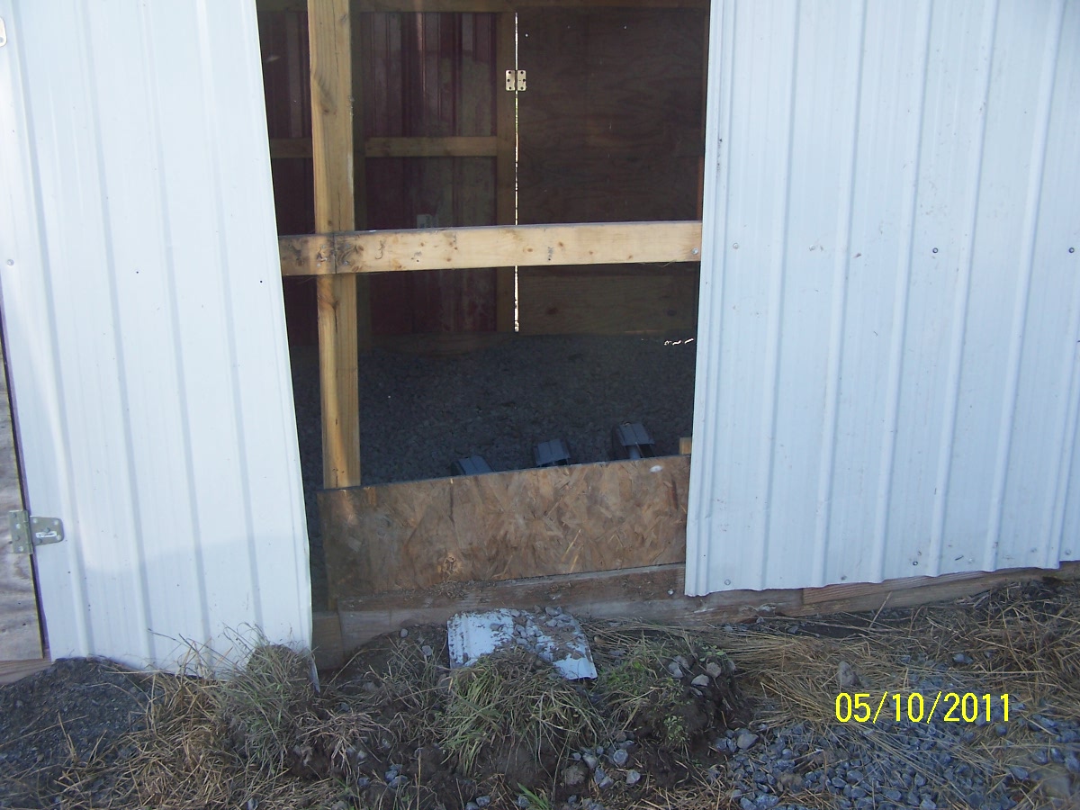

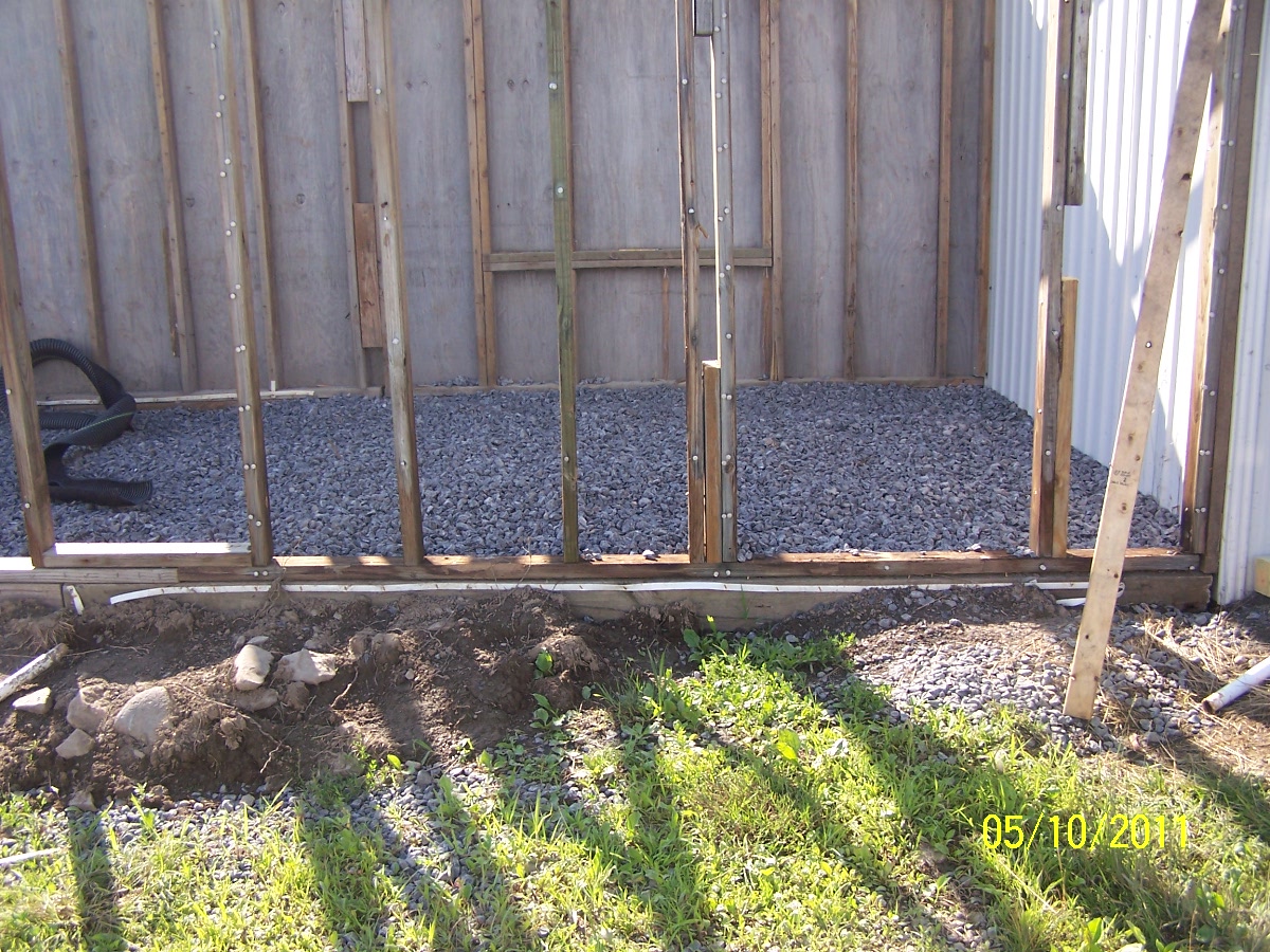

PLEASE SOMEBODY COMMIT ME A 3RD PHEASANT PEN
Well I was not happy with the drainage inside my barn for pheasant pen and I am adding more stone and also adding a third pen. I would like to be able to brood 3 different age groups and that is not possible with out 3 pens. I am also able to save almost $6 a bird buying them at 8 weeks ready for flight pen. Well buy 300 and that is $1800 savings. I can buy my food for $10 for 50lbs. I have range feeders that hold 800lbs each and the water totes with auto watering systems. So in bagged feed I get a 1/2 ton at $200 I priced it with Cargrill and it was $400 a ton, and you must take a 2 ton minimum. So I save $1600 by having enough pen space to brood 300 it is not hard to figure pen will pay for itself pretty quick. 1200lbs of food will last
them a little while so even with $250 a food you are $1350.
So we continue on the same line as the current barn and built the base up 2 1/2 feet this will have to be dry!
It can not do any but drain.

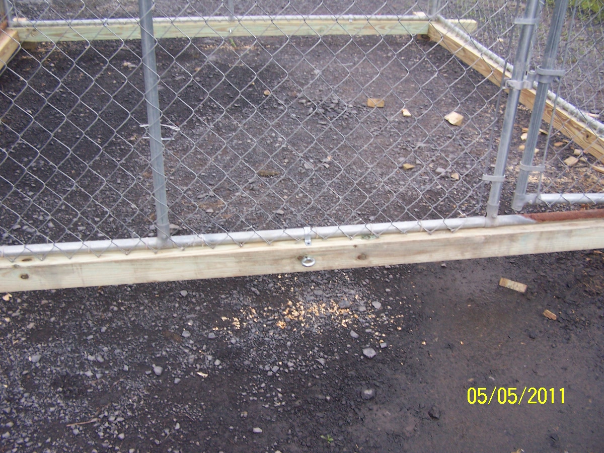

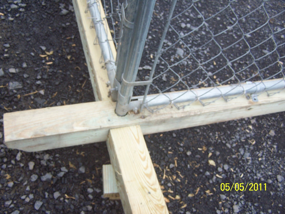

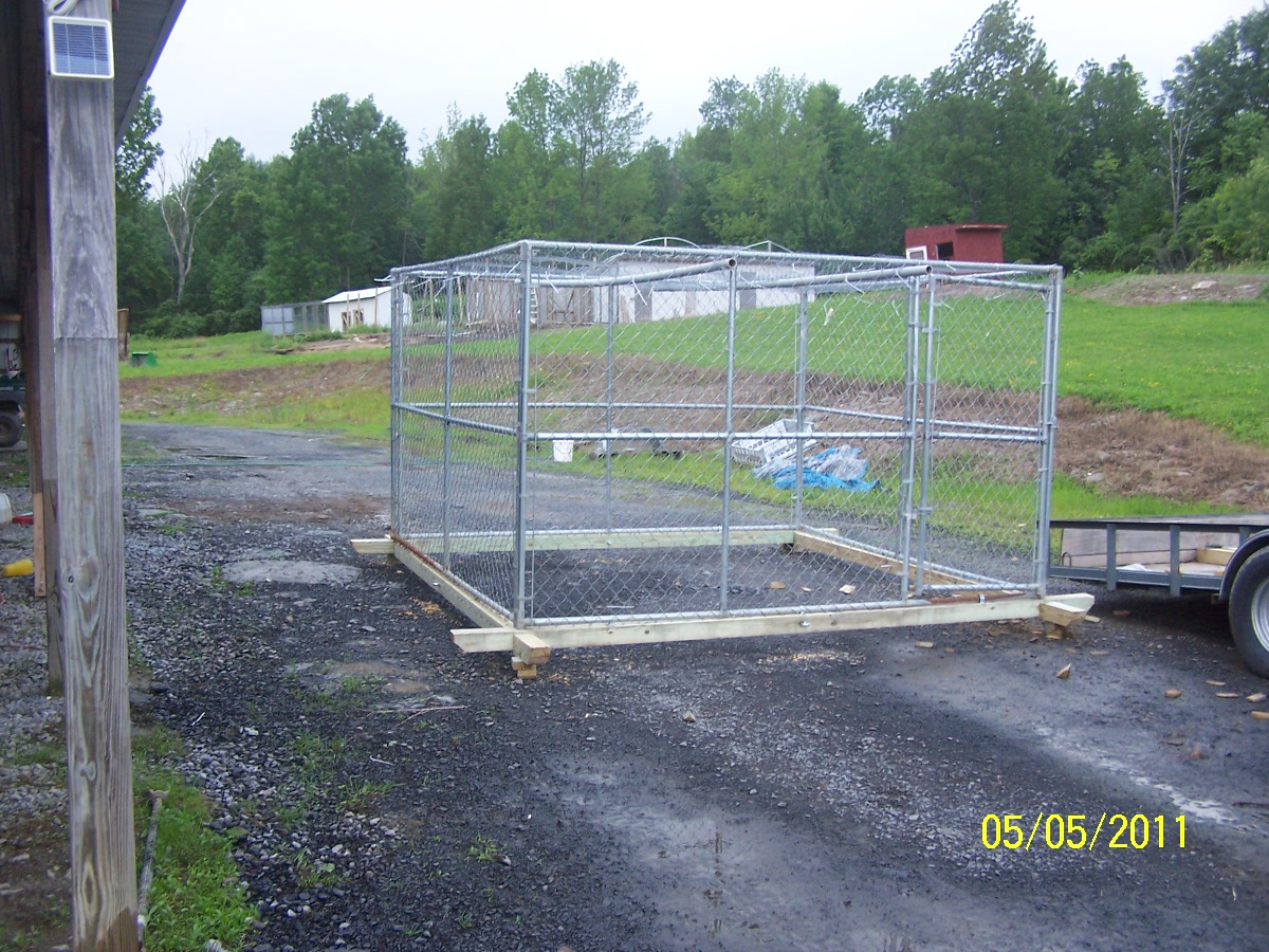

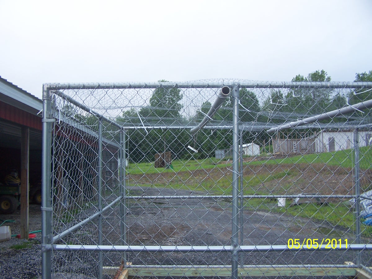

My idea of chicken or duck tractor.
I have kennels laying all over the place not really what I want to use for dogs. But make a great chicken or duck tractor. this was what we did last weekend. The sched 80 is good for frame for chicken wire. If I wish to place tarp on the sched 80 will hold it when it rains. We placed eye hooks to drag to fresh place every day. Cuts down food by 30%. Great to reseed after a move. Throwing in some glover and Timothy and a little lime as it is already Fertile Ground. Great pasture not bad for hay and does not grown real high.
Very often you can find old kennels for about $150 and 4 4X4 with a little hardware save time and are very predator proof takes a lot to get thru chain link. Move with ATV and not bad. Will send more pics I have two. Will make some for my new turkeys

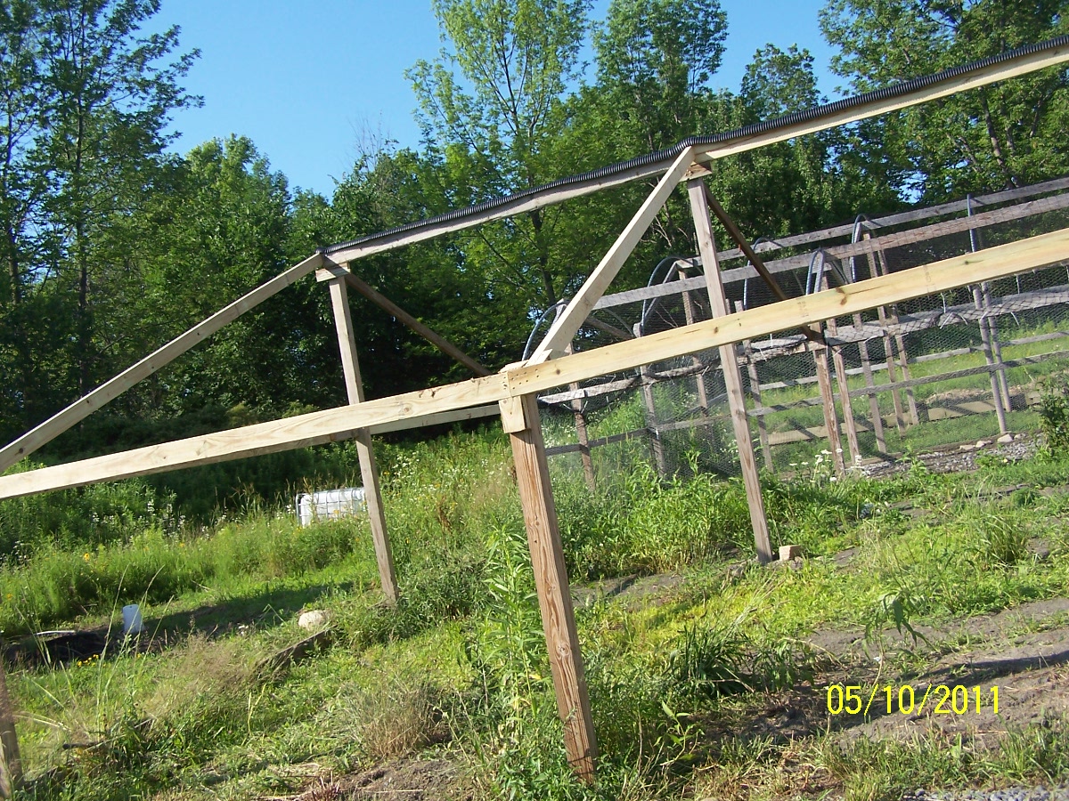

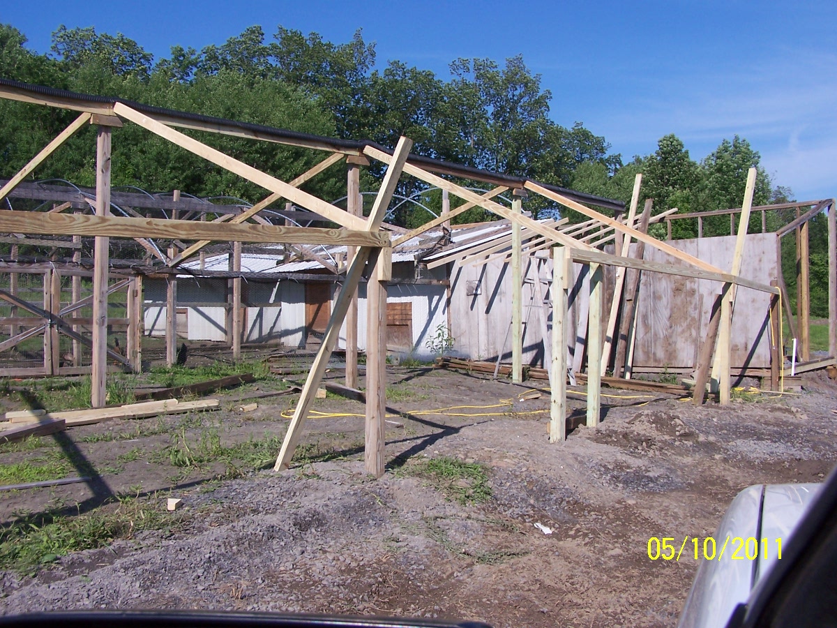

Being a three day holiday weekend gave me a chance to work on pheasant pen that I started last fall and did not get a chance to complete. This one is 24 wide and 70 feet long an addtion 1680 SQ feet. The other pens are 18 X 70 and can hold 84 birds. The new one will hold 112. The guy helping with the pen can not understand why I would not make the 3rd pen exactly like the last one. For an extra 6 feet I gain another 30 birds. He was worried about it looking square I do not care so long as it is well built and will hold up this is all I am concerned with.
We tried something new I did not want to bother with green house hoops this time. So I bought 4 inch flexible pipe in a roll of 100 feet for $39 from tractor supply. We laid out pipe and Glen cut with circular saw like nothing he was cutting faster then I could hold in place. You can see it is attached to main beam or ridge beam.
I bought used shed that where attached to green house only two sides and they are all PT and well built they are a little higher then I need. But we used the already built shed ways and cut to right height and save 1/2 the time it takes to do the pen. So in 2 weekends this is what we got to here. May not seem like a lot, but as you know takes time. So this last pen is 2 X 4 construction on a base. I will finish the metal outside on the barn so it all looks the same. So with the three pens when we are done will have a 8 X 52 foot barn all together. Each pen will have a place to barn so birds can come and go out as they please.
I also spread 9 1/2 ton of stone in the shed to help keep dry. Ordered more for tuesday. And of course last year I spread two inch stone and then stone dust on top of that. So again this pen should not be muddy. After we get done I running electric up there for heat lamps and lights I am done with cords.
