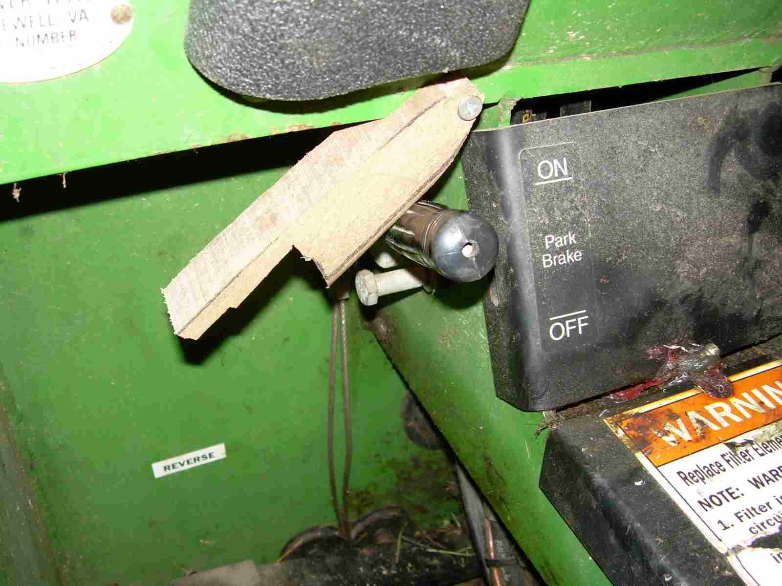

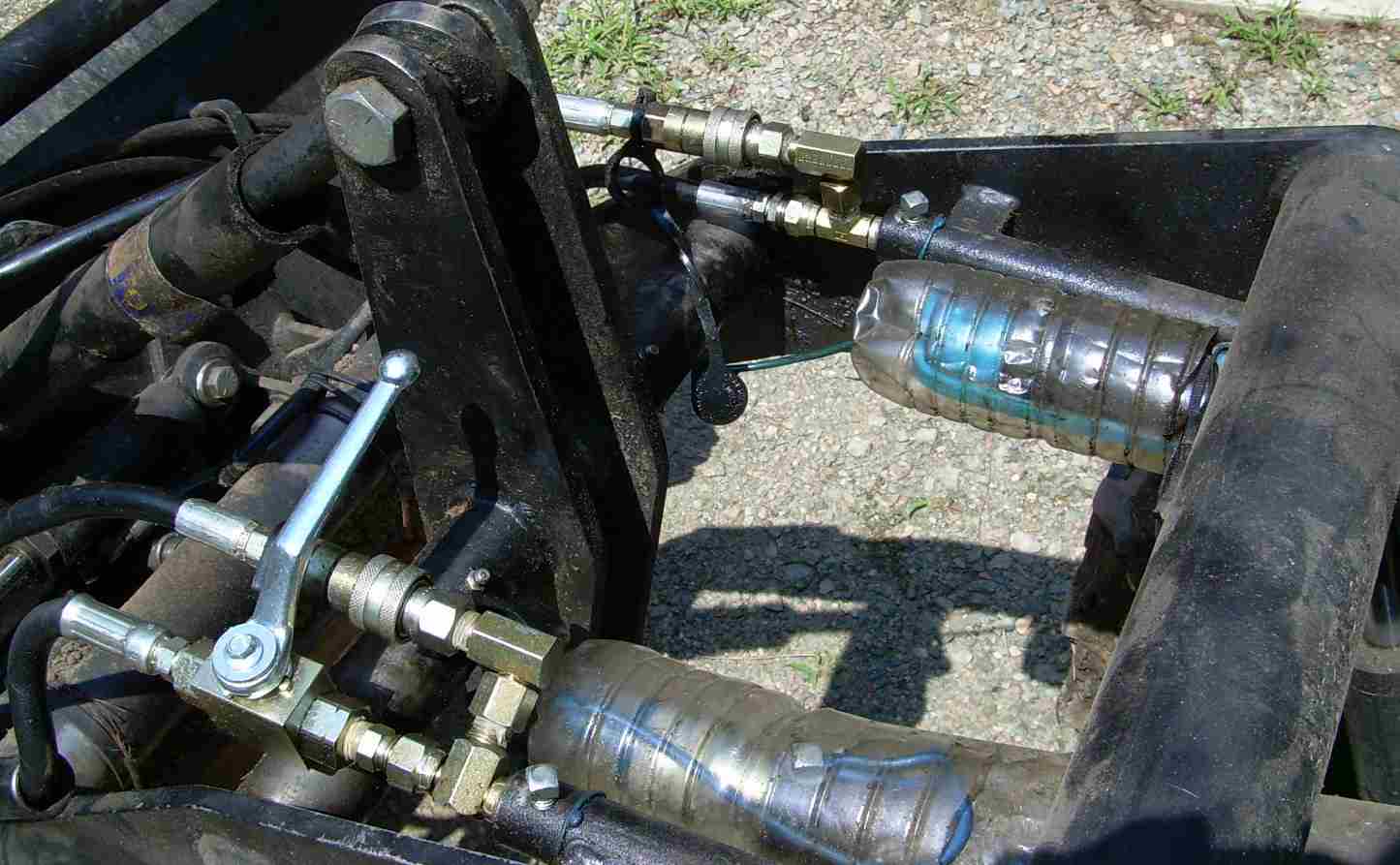

Just thought I would mention a couple.
The brake handle modification has worked great for at least a year. See attached picture.
The aux PTO modification has also been extremely handy.
I highly recommend both of these modifications.

1. Moving Aux PTO handle to left side of steering wheel. After 250 hours, I just wonder why Tazewell doesn't make this standard equipment. Thinking about using a cable control someday to replace my shade-tree engineering, but couldn't be more pleased.
