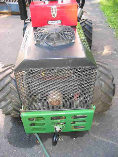

On your post about wanting to find a quieter muffler, perhaps you can try this. You probably have noticed the sound coming from different mufflers, and the young guys like loud noise, so they find an outlet tube that is really big, 3 in and larger, even into a megaphone style. What I am trying to get at is this, big pipe openings make loud noise. Years ago I saw some cars and trucks with a modified outlet pipe. The end piece was much larger than the pipe, and it had many smaller holes for the output. The frequency of the noise coming from the single opening is very loud , sort of like a straight pipe motorcycle. You can have the same amount of gases coming out the exhaust by having many smaller holes, therefore changing the frequency. I noticed this change on one of my 5 HP motors. The muffler was about 4 x 5 in, with a plate over the output that had many holes. When the center part with the holes rusted or burned out, the sound got louder and louder as the rest of the grid rusted away. Anyway, it would not take much to try, just make a clamp on outlet with many holes that is equal to the area of the single pipe.
The point of this post is about changing frequency.
   / Project Status Update #12

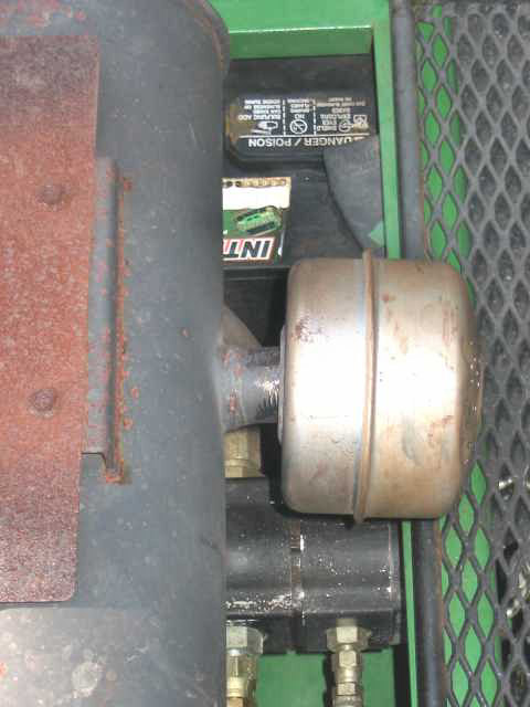

JJ,
That's essentially the way this aftermarket cannister muffler is made. The holes are barely visible through the rear mesh of the PT's hood...

   / Project Status Update #13
JJ,
Hey, that fit inside the cage? Did it help much?
   / Project Status Update #14
Actually the cage helps hold it on -- because I couldn't thread the tailpipe to screw it on (metal was too thin), I ground some of the threads off inside the cannister muffler and forced/screwed it on. It's kind of a "wedge fit" if you know what I mean... :p:D
It deflected the wire mesh out maybe 1/4" or so -- enough to where you notice a bulge only if you look for it.
Meanwhile, I'd guess it was good for 5-7 decibels less -- noticable improvement, but still not quiet by any means. Now, it's no noiser than my Simplicities which came with a Nelson muffler, not the cheap Briggs cannisters. Before then, it was simply too loud to use for long periods without earplugs/headset. Now that I have a set of AO Worktunes (I didn't then), the noise isn't bothersome at all. My knees tire out first now, during extended work, not the noise wearing we out and making my ears ring. When I'm in Tennessee, it's not unusual for me to run it 8 hours a day, and the noise would wear me out...
