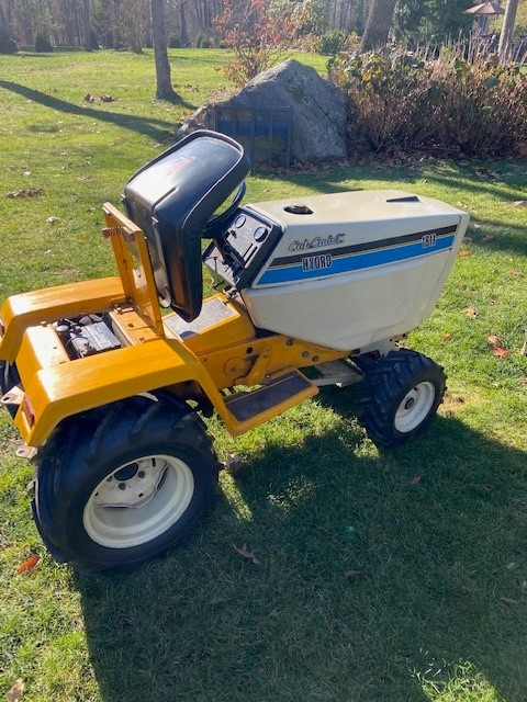

Very nice work and craftsmanship on that rear blade build.
Also very nice condition for the 1450 - but the seat suspension is reversed!
I had a 1250 and traded for my 1811 in 1989 - most of the seat suspension the U faces the rear, but I don't know if it makes a difference?
