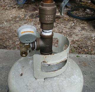

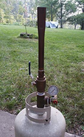

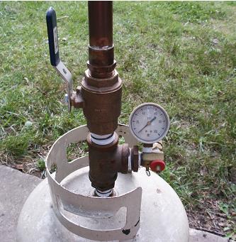

I removed the propane valve and replaced it with a nipple, tee, and ball valve. I also added a gauge and hose fitting. I just put a piece of copper on the ball valve and squeezed the end a bit. If you make one of these make sure you hang on to it when you open the valve.:D

Are you guys using some type of safety pop off valve on these home made tanks ? I think the air tank that I bought was only 25 bucks & comes with a safety pop off valve. It pops off at around 125 psi
   / Propane tank converted to air bladder... any comments? #29
I bought the fitting with the safety valve from Tractor Supply....I think.
M.D.
   / Propane tank converted to air bladder... any comments? #30
MD, I guess I missed the part about what you use the tank for. It could be a bubble blower on steroids but it would probably seat tire beads on loose fitting new tires instead of having to use the explosive fuel air bomb approach.
You ruined an other wise decent start on a 'tater gun but the bent/deformed exit "nozzle" is NOT an improvement for that use.
Pat
