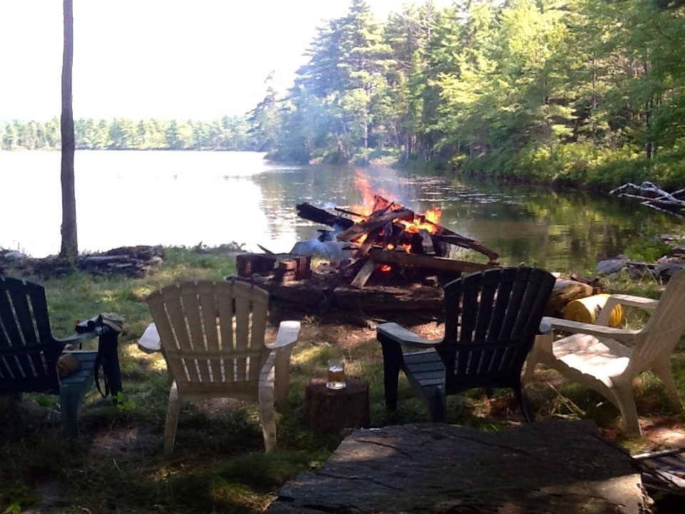

I've never used one of those cutoff wheels in a circular saw. I wonder if I could set the blade so that it's poking just a 1/16" of an inch or so below the shoe and very slowly go over the line taking off a small amount of metal each time until I break through? The thought of it jamming and exploding if I go too deep is a little scary. As for using both ends, might as well! Maybe I could sell the other one. I need a steel pit for my patio-the only other pit I have is back by our pond which is just a bunch of stone I gathered up from the property.

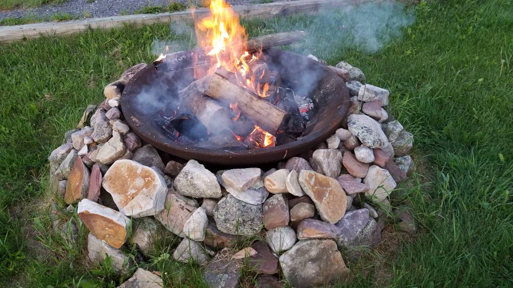

I used an aggregate cone crusher mantle for my fire pit. Even worn past its usable life at the quarry, a two inch thick chunk of manganese makes for one heck of an outdoor living experience! 20180609_203147.jpeg
