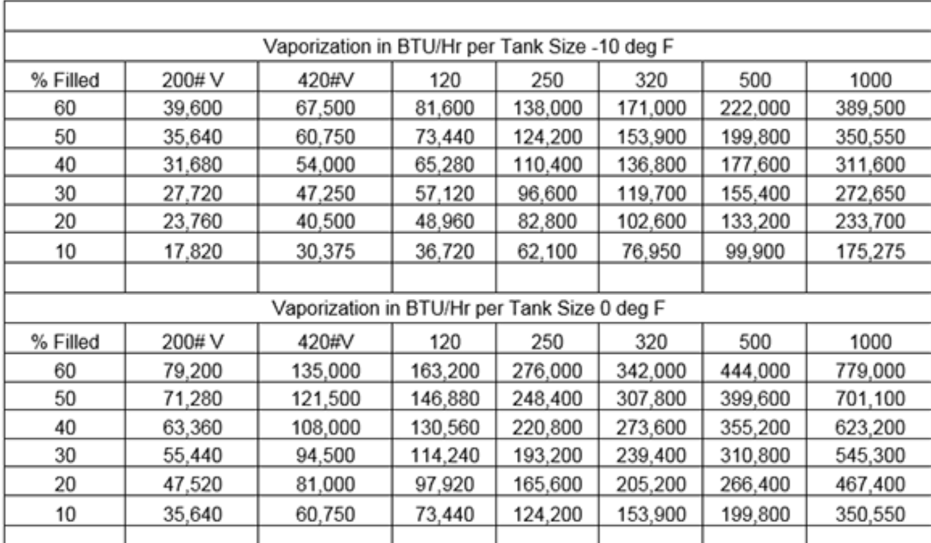

As an, ahem, former northerner, who still gets snowed upon regularly, the downside to LPG in the winter time is that the evaporating (boiling) propane in the tank needs to absorb heat from the environment to evaporate. So, the issue is rate. If you aren't pulling very much LPG off of a full tank at -10F, it isn't an issue. If you are pulling a lot of a close to empty tank at the same temperature, it can become an issue.
The takeaway from the top chart is that going from 60% full to 10% full can reduce the available flow rate by half or so. Going from 0F to -10F will also reduce the flow rate by half or so. Net, net, you could lose 75% of the flow rate as the tank empties, and the air temperature drops.
Burying a tank keeps the tank much warmer, reducing the issue. The downside is that you should periodically do a cathodic test on the tank/cathode system. If you can't remember when you did the test, it is time. (In my book, at least.)
And, yes, in any place with wildfires, burying reduces the fire and explosion hazard to you and firefighters. Our above ground tank is well away from the house and other buildings for fire reasons.
