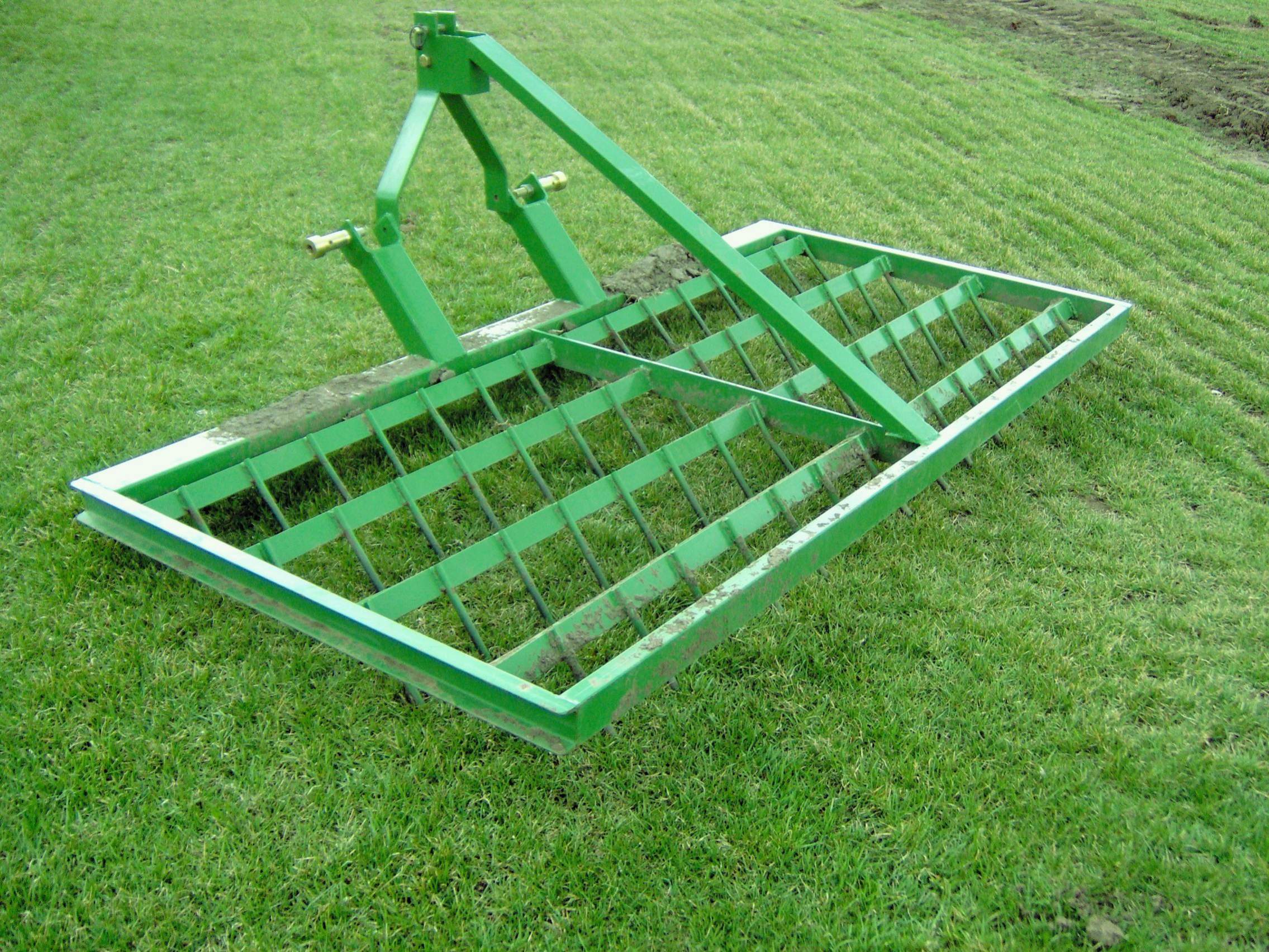

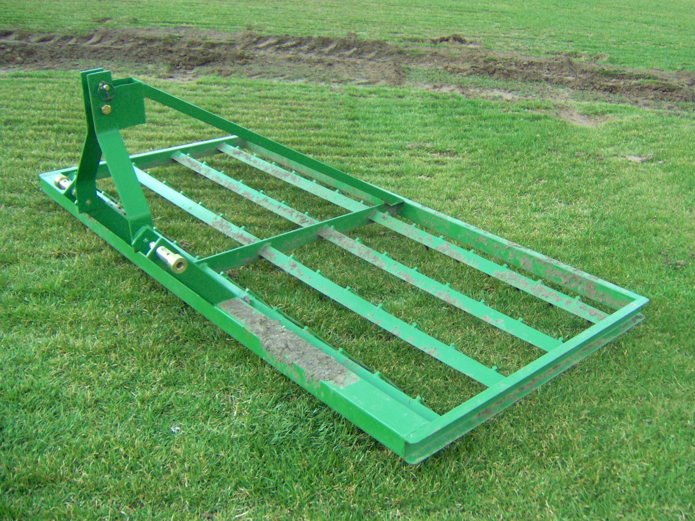

Something like a chain link fence panel or stock panel comes to mind. For a few more bucks you can build a spiked tooth harrow if you have a welder, I built this one complete for
$250.
