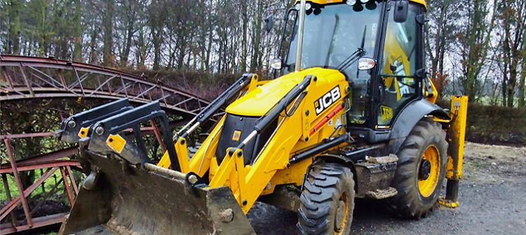

I seem to have unintentionally offended you Cougsfan, I'm sorry if I have. To be quite honest, until I started looking at TBN and also OTT, I was unaware of bucket clamp on pallet forks. The use of the flip over type of forks fitted to a back hoe buckets are pretty much standard equipment over here. A 4in1 back hoe bucket is a much stronger than an ordinary compact tractor one of course.

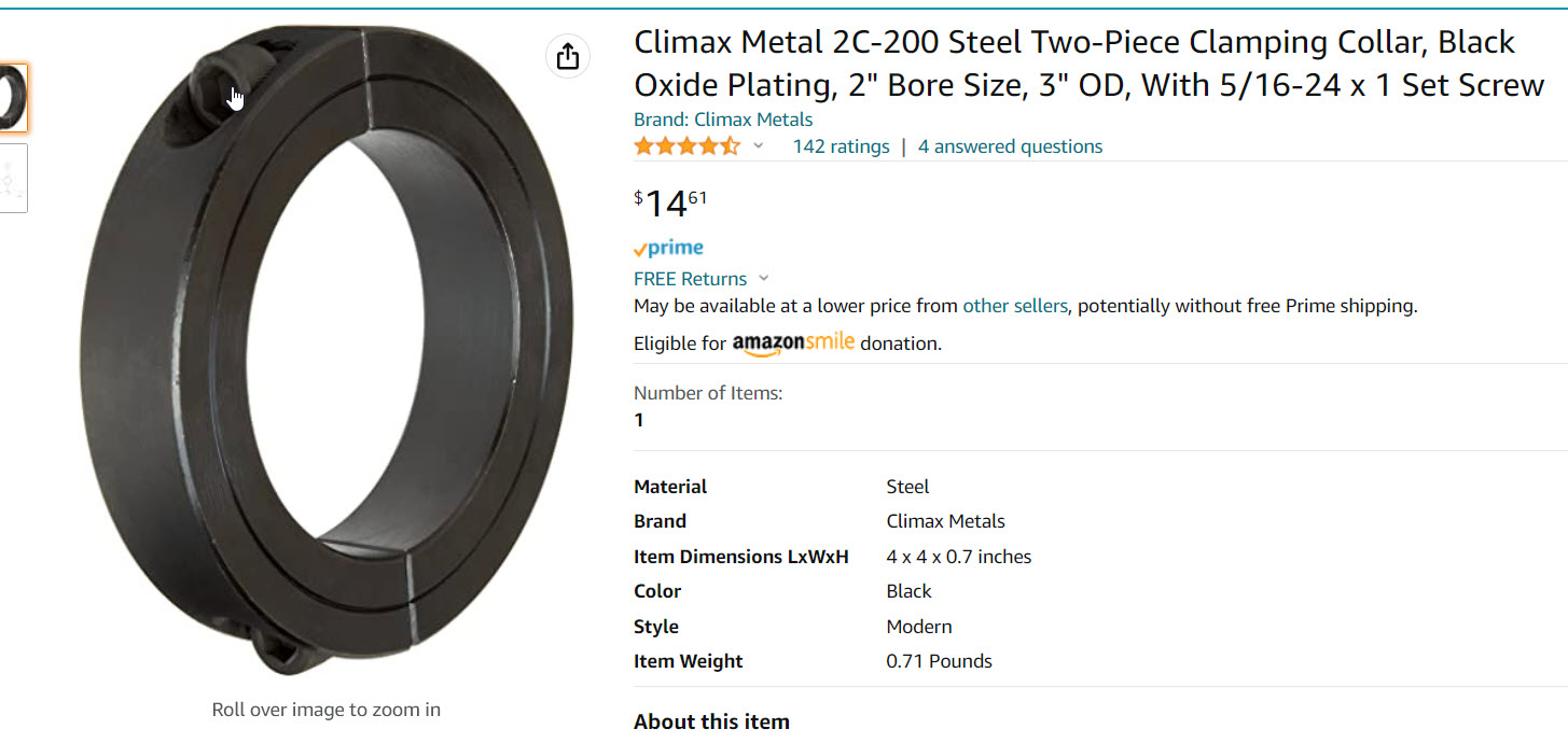

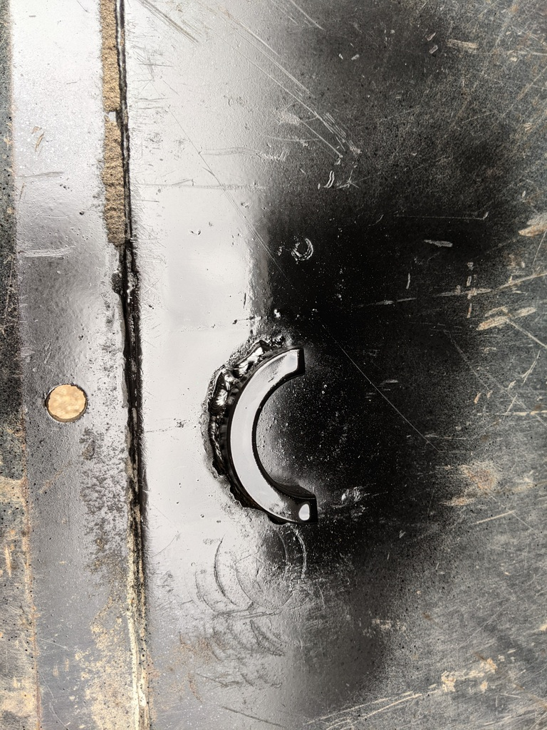

I took this, removed the screws, and installed my pallet forks. My Kioti bucket is reinforced at about a 32" spread, I put them there. This split ring is the exact size of the clamp buttons on the Titan forks. I then welded 1/2 at each mount point. Now if the forks simply loosen, they won't fall off and I'll see them wiggle and can retighten them. Sure, I could have purchased the skid loader forks but I didn't, nor am I likely to.

I'm sorry, I wasn't clear in my post, I was talking about the flip over forks you see on 4 in one buckets on the front of a backhoe loader, not the buckets of the actual backhoe, ie on the rear of the tractor.
Like this:
I kinda get it,and I kinda don't. It would be nice to see a pic of them mounted.
   / Proposed Idea for better clamp on forks. #29

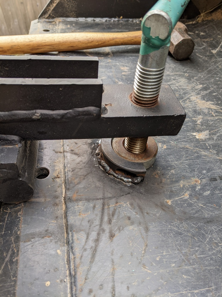

Here's the attached pictures. Please ignore my crappy welding.
Not bad and help keep the forks tight.
I weld a straight bar to the forks to catch the underneath the back of the bucket cutting edge to lock the forks in place.
Use both ssqa forks and clamp on forks at different times and find them very useful. Sometimes being able to have clamp on forks wider than 4’ on a bucket helpful.
