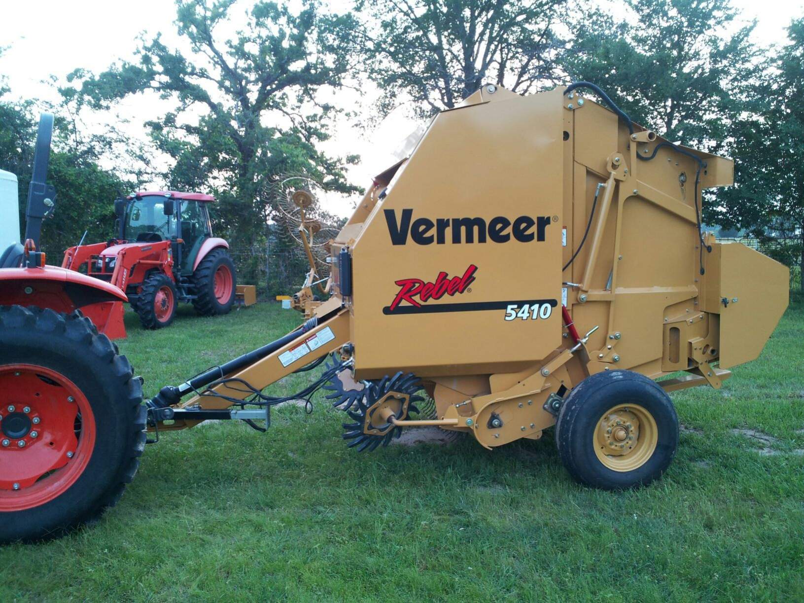

I run a 5410 with a Kubota M7040(64pto) its matched good. I have the net. and string,usually string the bales that are not as good grass in areas,just so I know but I prefer the net. for baling and feeding. I wont to say my baler new last year was around 19,500 with net,expert.bale monitor... rebel 5410.jpg

looks likely I'll buy a rebel 5410 net and twine.. next spring..
in the meantime .. i just bought a 1992 ? ... john deere 2755 with a jd245 loader...
didn't want the loader .. but he wouldn't separate them... i wanted the tractor . i know the guy . and it was
local .. and has only 1900 hrs on it..
this tractor should pull the rebel baler no problems.. dyno says 78pto and motor 92hp...
a wee bit better than what tractor data . com says..
peabody
   / pros and cons of net wrap ? #35
Oh yeah, that is plenty tractor. We used to pull a Rebel behind our 2355 with no problems.
