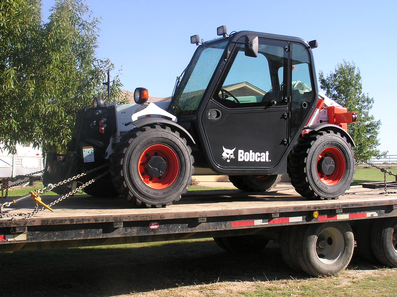

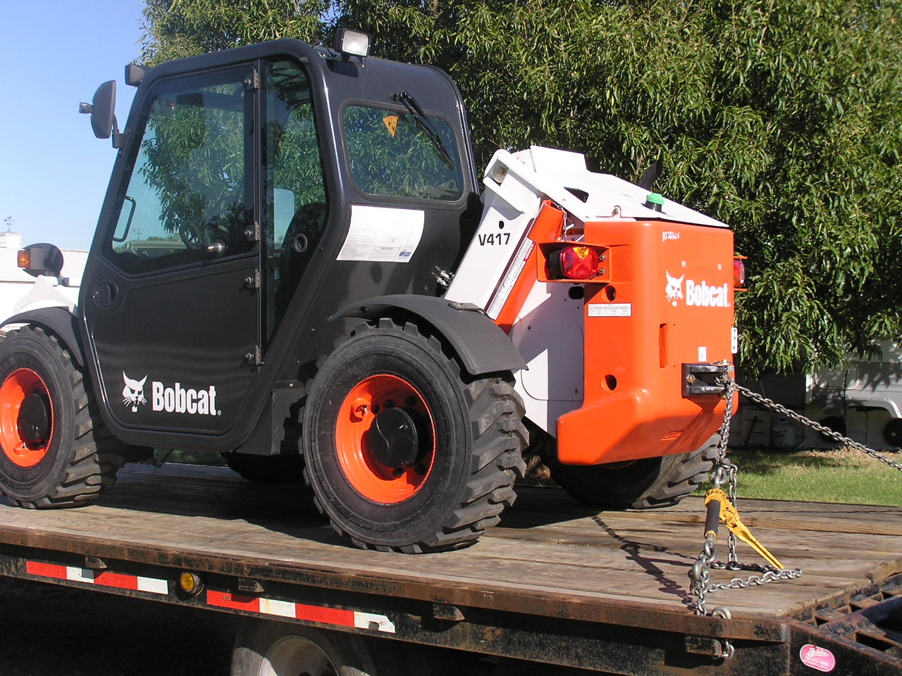

Since you didn't know about telehandlers, this is what I have, a Bobcat V417 Compact Telehander.
It has a standard SSQA (Skid Steer Quick Attach) and auxiliary hydraulics on the boom.
With the 7' brush hog.
Click for more info and pictures: http://www.tractorbynet.com/forums/...mpact-telehandler.html?highlight=#post3243370
Thats sweet! I could use that on my creeks for sure!
View attachment 389985 View attachment 389986 View attachment 389987
View attachment 389988 View attachment 389989
