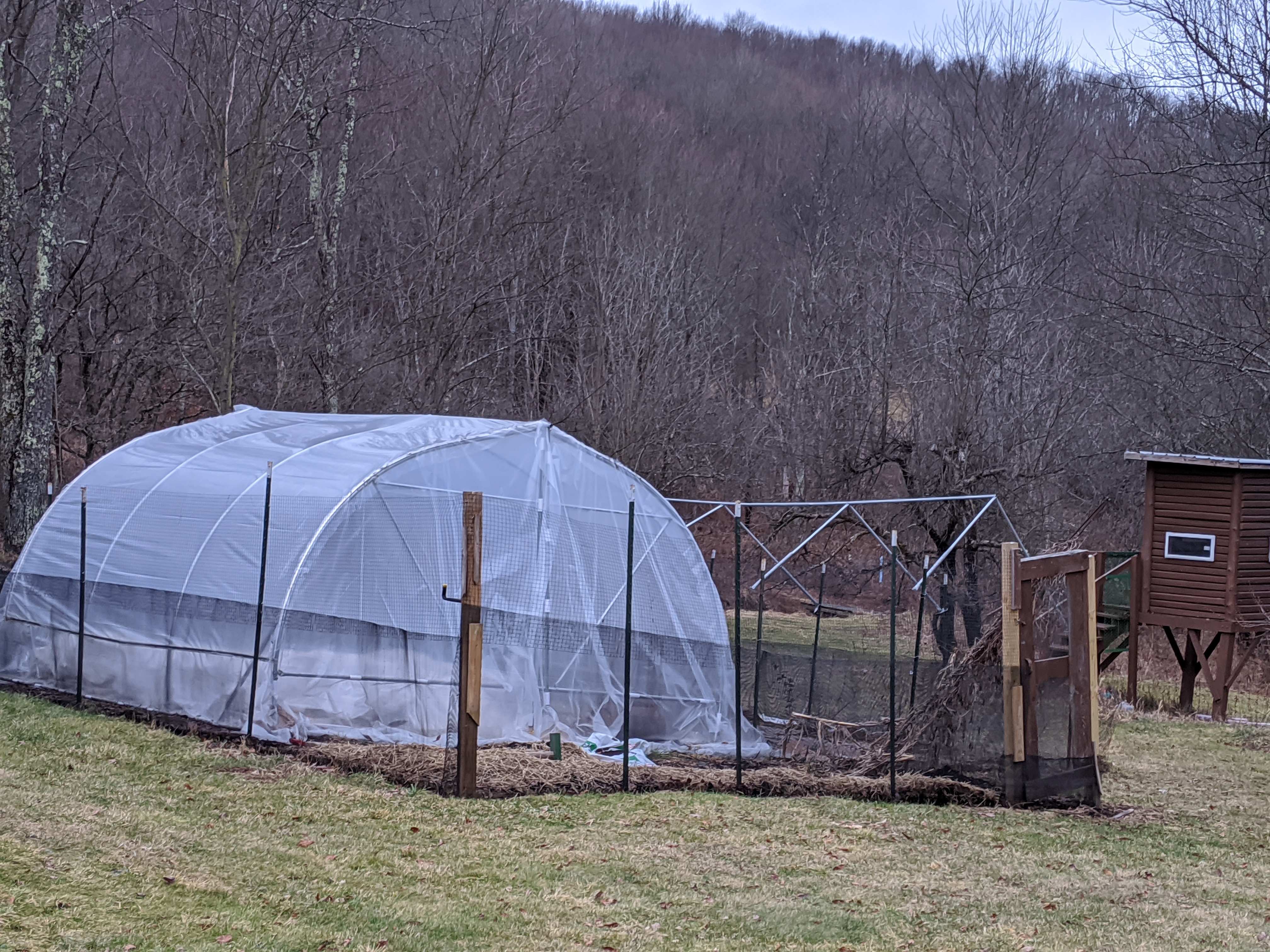

What I did is make a blueberry cage. Drove tposts into the ground. Then bought some tpost brackets at tsc. I then took 3/4 emt and made an A flattened the ends of the emt and bolted them to the tspost brackets. I have 6 A's that are then bolted to each other to make it a sturdy structure. Bird netting will go on top, I then took hardware cloth that I hand and burried it about 6-8'' into the ground and then above that chicken wire. I have had deer, rabbits, groundhogs eat the small bushes so we went and bought a bunch (10) large ones from Blueberry Plants For Sale | Buy Blueberry Bushes excellent product btw.
   / Protecting Blueberries #20
You can see it on the right of the greenhouse.
