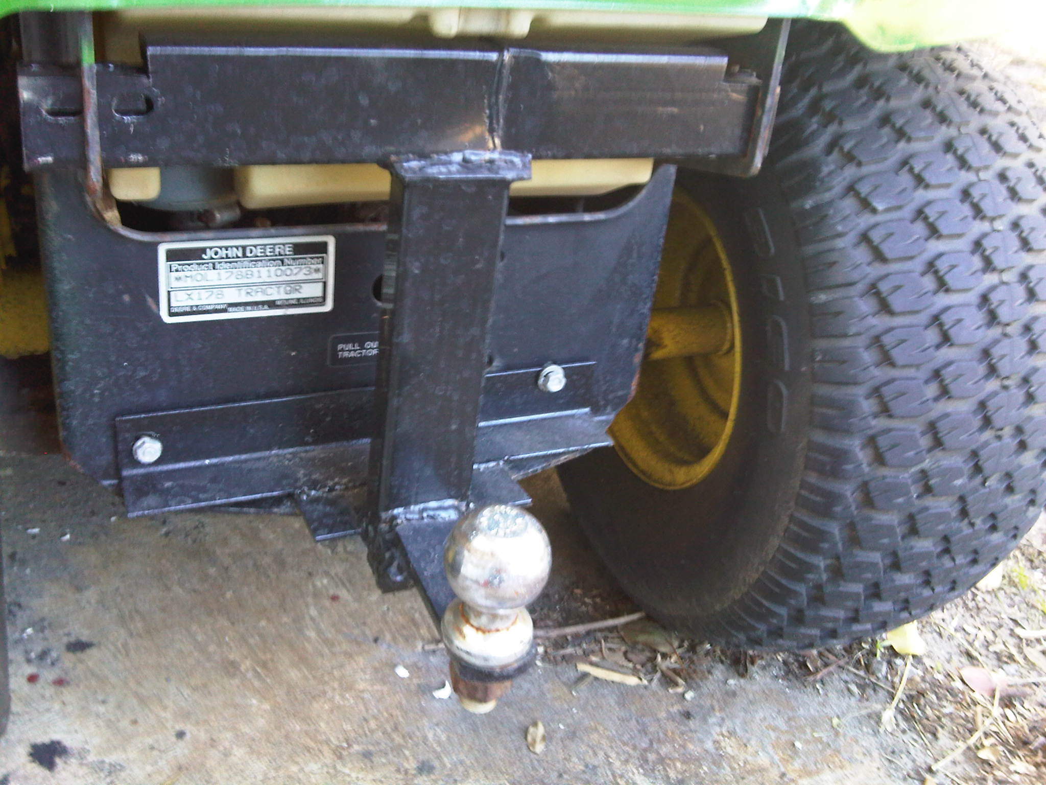

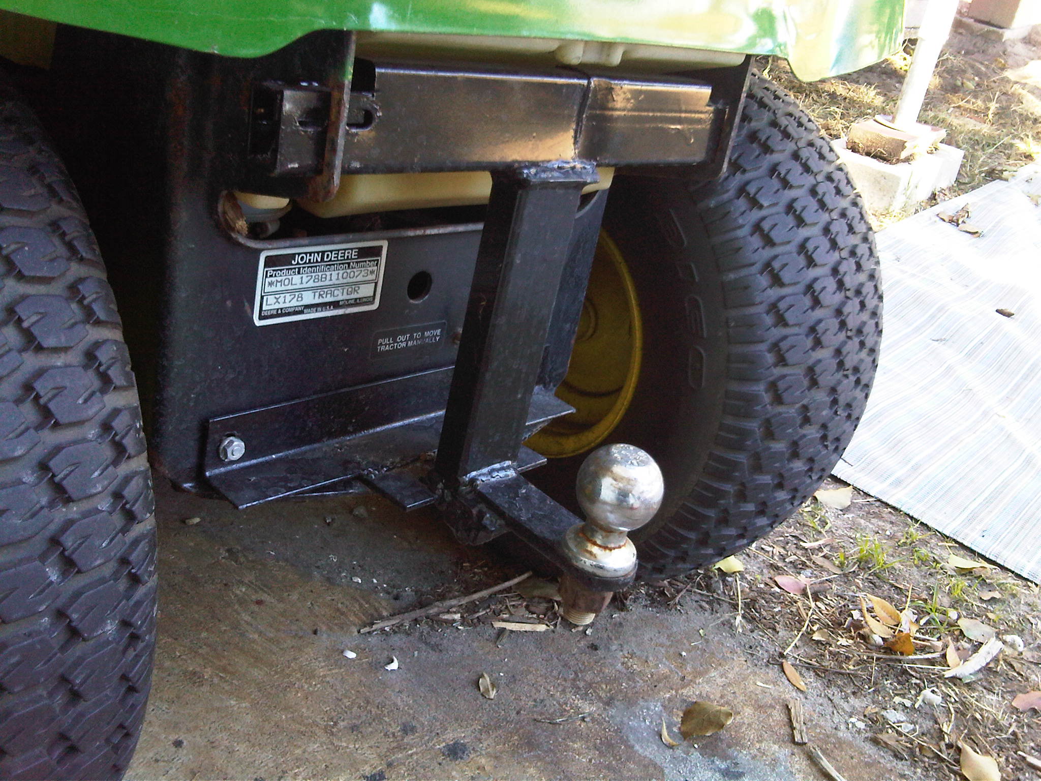

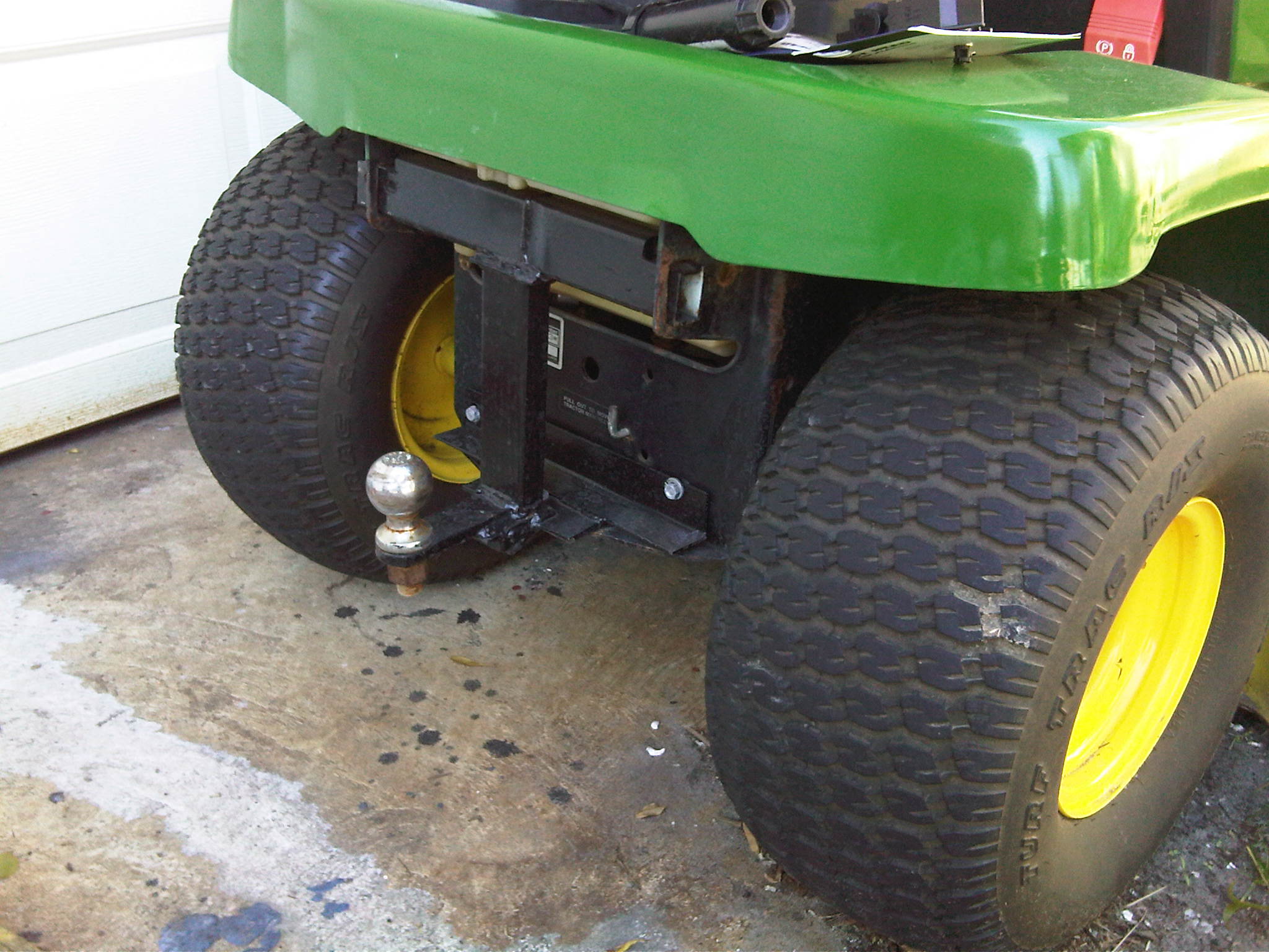

I use an LX176 lawn tractor to move trailers around at our Florida house. (We use a ball in one of the forks on the skidsteer to move trailers at our place in Tennessee). I was concerned about that weak looking little metal flap on the back of the lawn tractor bending - had an old Craftsman that bent under the same type of hitch over many long years of pulling boats and such around..., so I welded up a "t" bracket out of rectangular stock (scrap I had laying around) to better distribute the load - bracket then bolts onto the sheet metal back of the garden tractor frame for a stronger attachment point.

As requested, here are a couple shots of the lawn tractor trailer hitch I built. It bolts/fits onto the back plate of the LX 178. I fabbed it out of scrap metal I had laying around. It's a little bigger than it needs to be - I built it to be able to add a carry bucket and some other stuf onto the bracket later.
Weak point is still the tongue that the ball mounts on, but it is much heavier (1/4" bar) than the thin sheet steel of the tractor....
Since it mounts on a LAWN tractor, I built it light duty, but you could add a couple gussets to stiffen it up substantially.

Wow, that looks like it'll do a nice job for you. Thanks for posting the pics!
