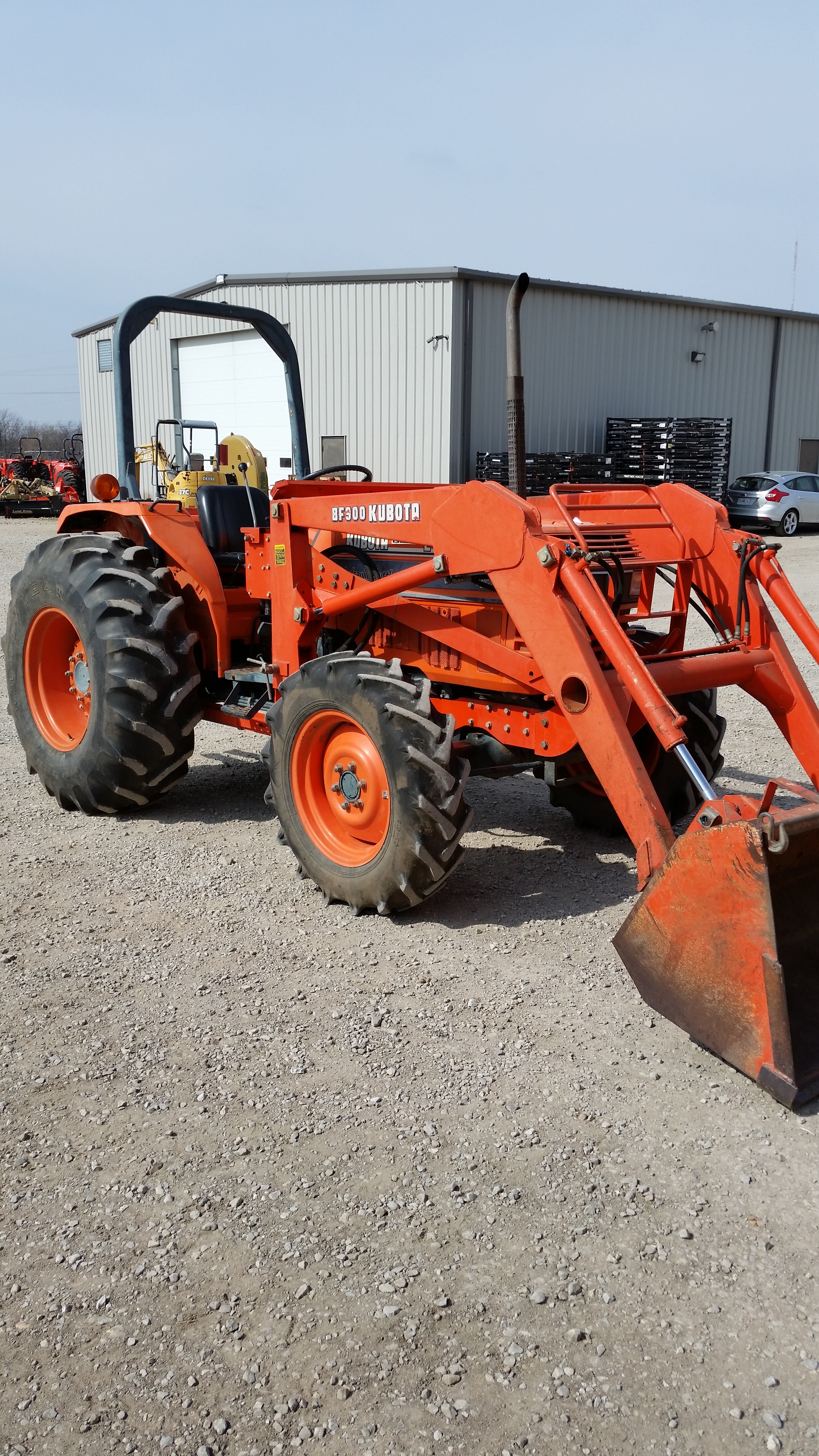

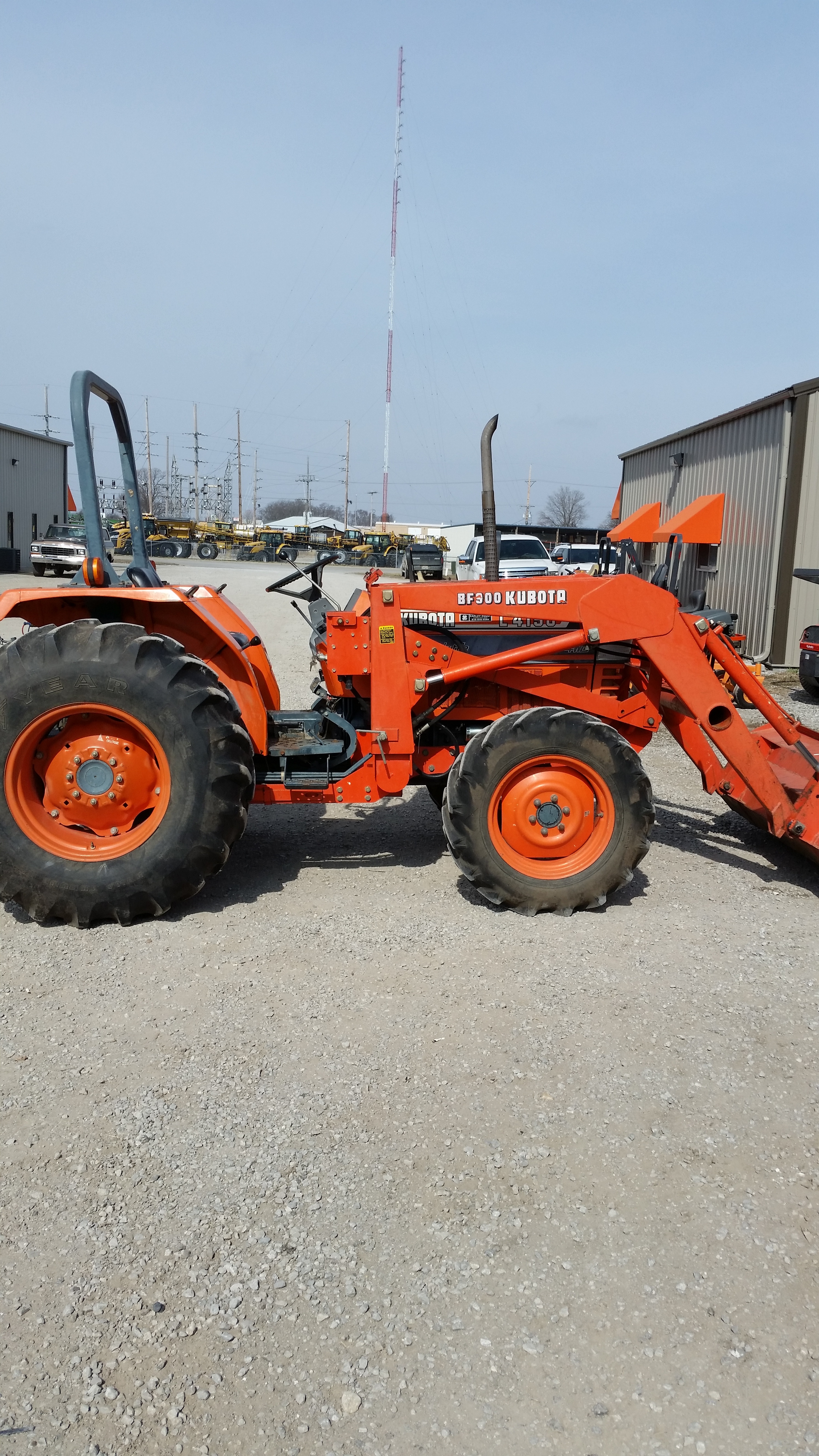

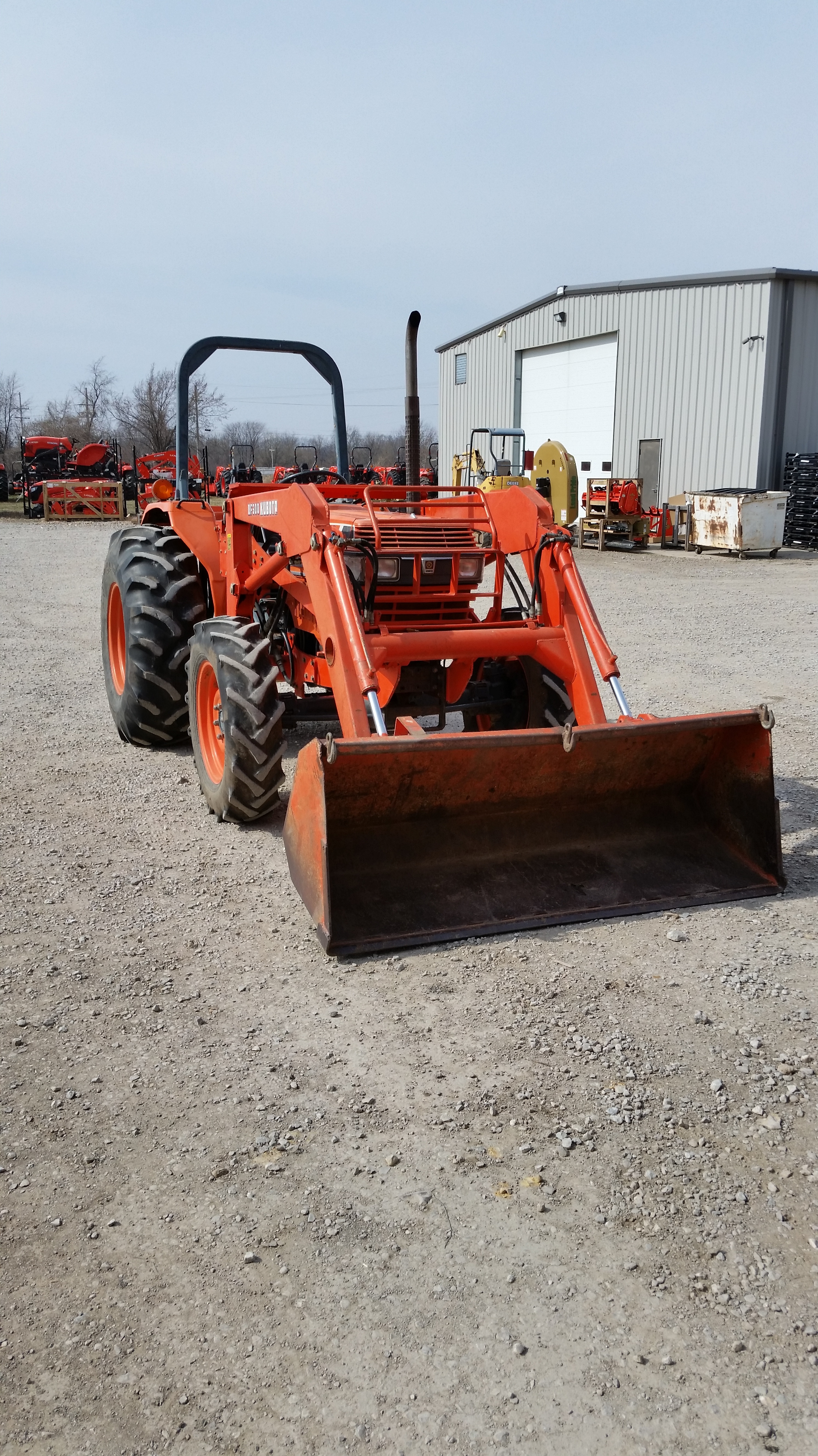

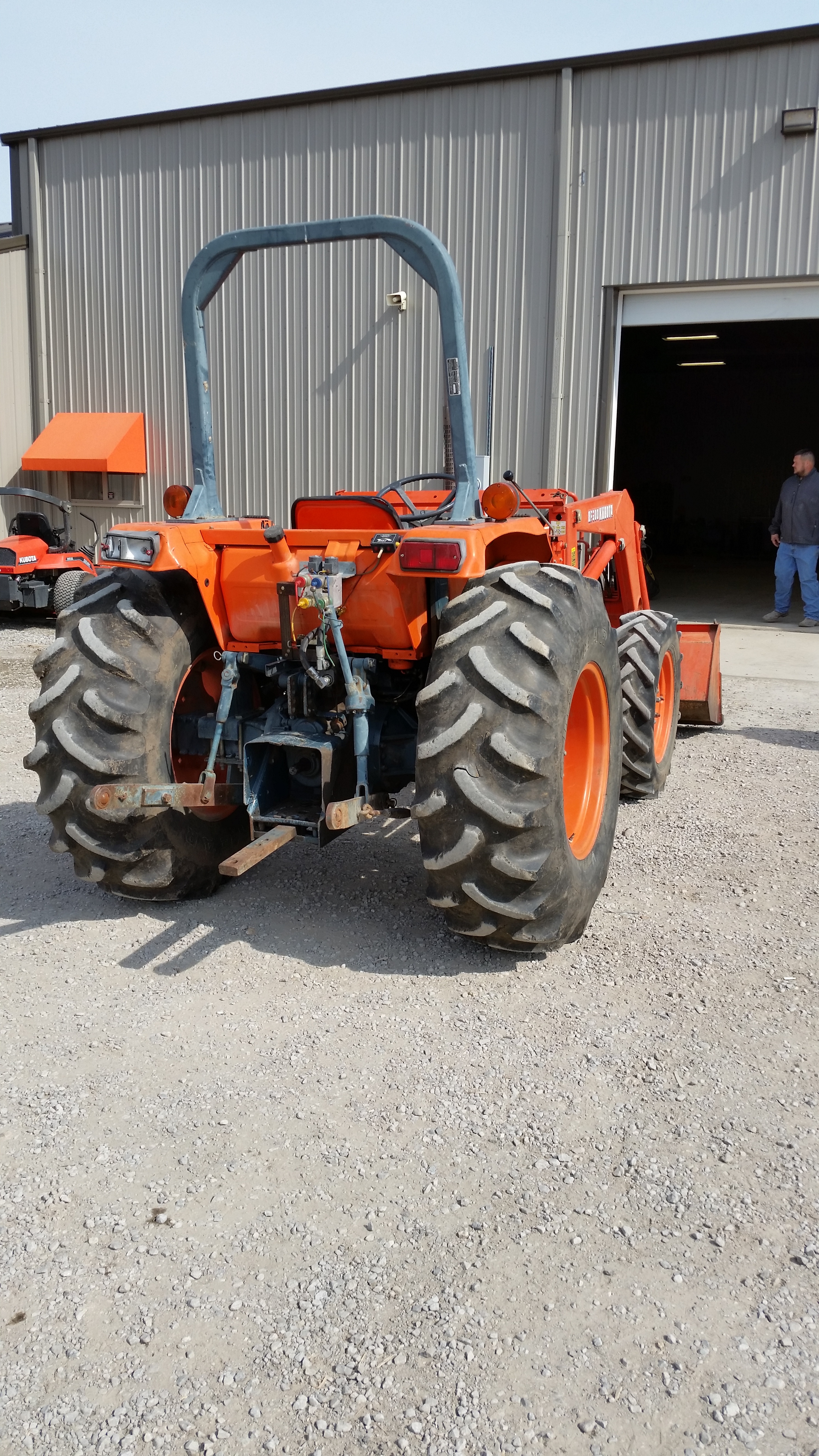

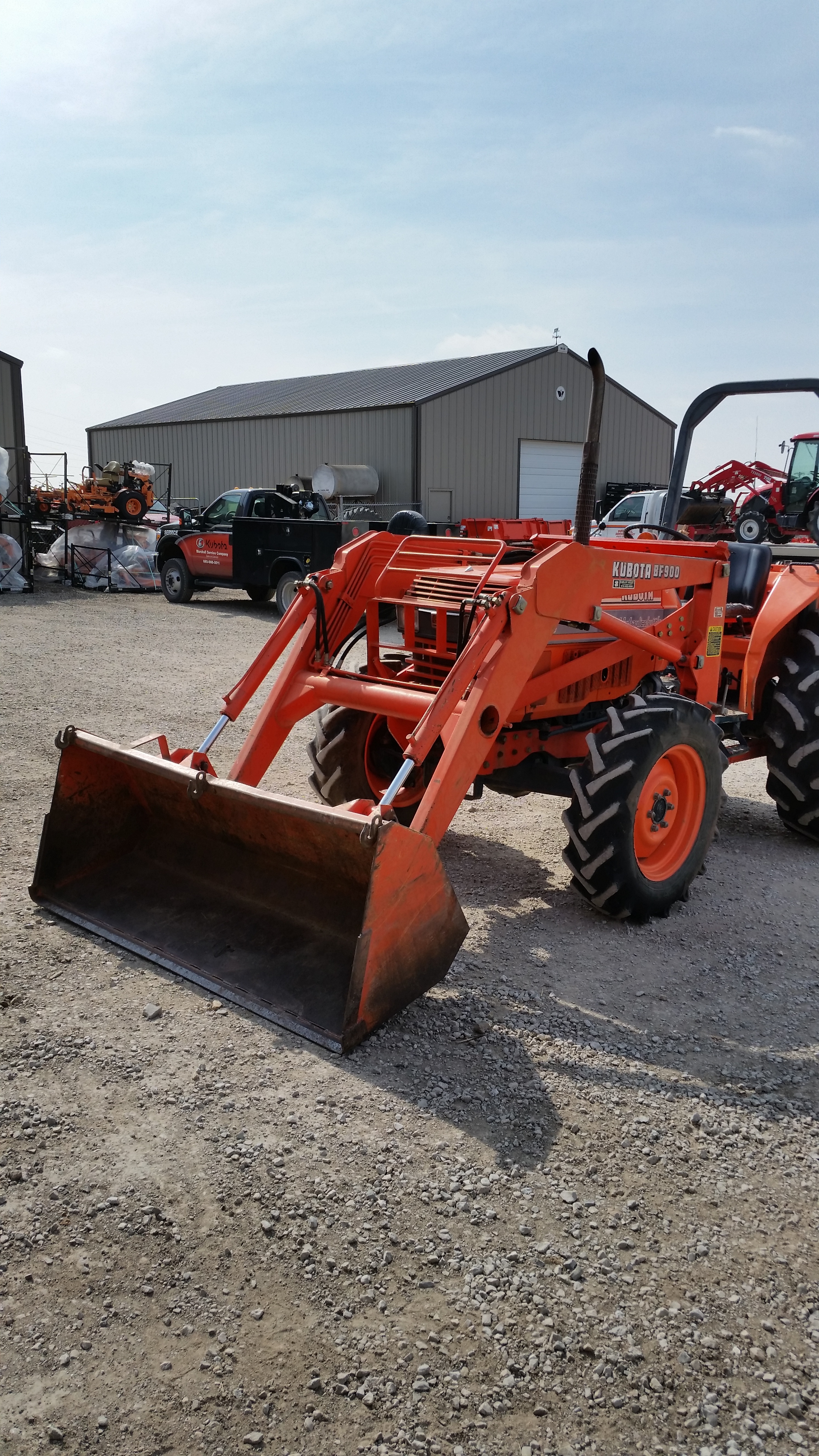

After months of looking and searching for a Kubota L4150. I finally found the one that I think is the perfect one, at least for me.
It seems to be in mint condition. Dealer is prepping it for delivery. I'll be needing a service manual, they have they original owners manual
that I will receive. I looking forward to many years of service from this machine. Enjoy the pics.

What a GEM !! I zoomed up all the pics and looked close. This tractor has been stored in a flannel mitten all these years - little or no UV damage, careful operator(s), stored inside, easy hours in a good environment - how nice that it's going to be in new hands that appreciate the fact that it is among Kubota's very best products ever, and that this one is a pristine example. Congratulations.

rbargeron, I was hoping you would see my post, I've looked at several and finally found this one. I am just stoked about this find. It was an older gentleman that owns a cattle ranch, used it mostly for moving round bales on the the 3pt had a bale unroller. It has 2300 hrs. makes me a little nervous however it is in such great shape and taken care of, not as bad as some of the other ones I have found with less hours. It never sat outside, the control decals look as though their brand new. It is amazing at how good of shape it is in. I look forward to more conversation about this gem that I now OWN. It will be delivered in two weeks, having a hard time waiting that long but I've waited this long so another week isn't going to hurt. Here's something that will make your heart skip a beat they also have an L5450, that they are currently using and at this keeping.....

You should have a very useful machine there! 2300 hours aren't an issue at all if it was serviced according to schedule, and being stored indoors most of the time means rubber and paint will be in very good shape for what must be at least a 25 year old tractor! Most likely the owner put less than 100 hours a year on it!
Already has the rear remotes, chain hooks on the front, so you'll have to think of something to mess with adding when you get it home... maybe a wash and wax?
