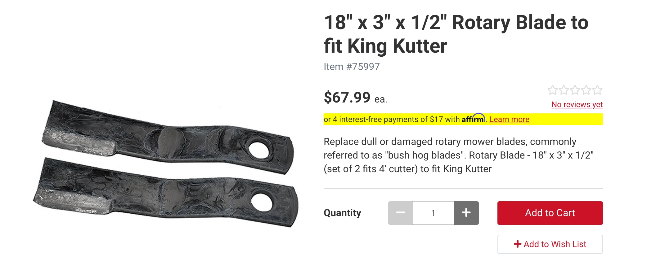

I've thought about cutting the drum down a couple inches and shortening the shaft so I could raise the drum up 2", then adapt some gull-wing brush hog blades. They wouldn't be able to hit the each others bolt heads.

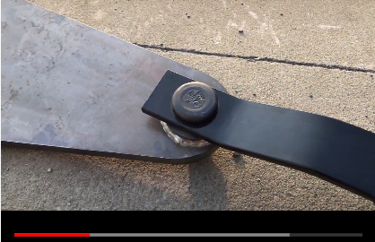

Sorry to be the odd guy, but aftermarket cutters seemed to have worked out all the PT deficiencies. They have no wheels, but that could be good or bad, I think the wheels are more for a finished area. And for example the bottom line RUT I ordered uses a 3/4" thick blade carrier/hub (think of the mass and stored energy when you tackle an object), you can see in the pic the gull wing blades and flat head bolts with minimal area for impacts.
I think it depends on your particular situation, apples to oranges. PT makes a good cutter for most uses, but there are options. The PT machine is just like a skid steer with 100s of tool choices.
