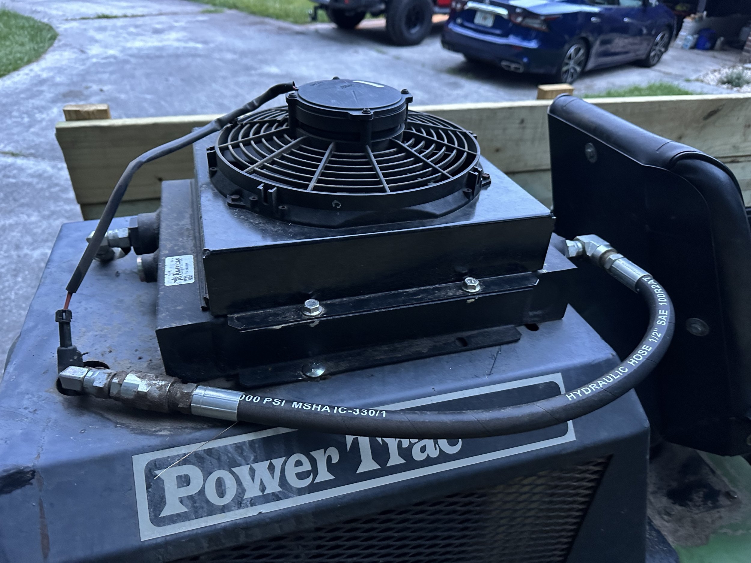

Anywho, I keep noticing that I am getting a steady drip from the male quick attach. Yesterday I installed a rather large hydraulic cooler and then tried to see how hot the hydraulics would get (pics coming soon) and attached my stump grinder. When I was removing it I had it idled down all the way with the PTO off and when I disconnected it fluid started spraying out of the quick attach. I **** down the tractor I checked the PTO lever and it was definitely off but I don’t know why fluid would continue to come out when disconnected. It didn’t happen again when I started the tractor back up… any ideas? Should I just swap the QA fitting?
BTW, the hydraulic cooler worked great. I used my weber IQ with a probe in the resovoir to see how hot it would get and the max temp I saw was 153 with the brush cutter while trying to heat the fluid. I will post up pictures when I clean up the installation b/c I am NOT proud of how it looks. I have to wait for a fitting to come in to mount it straight.

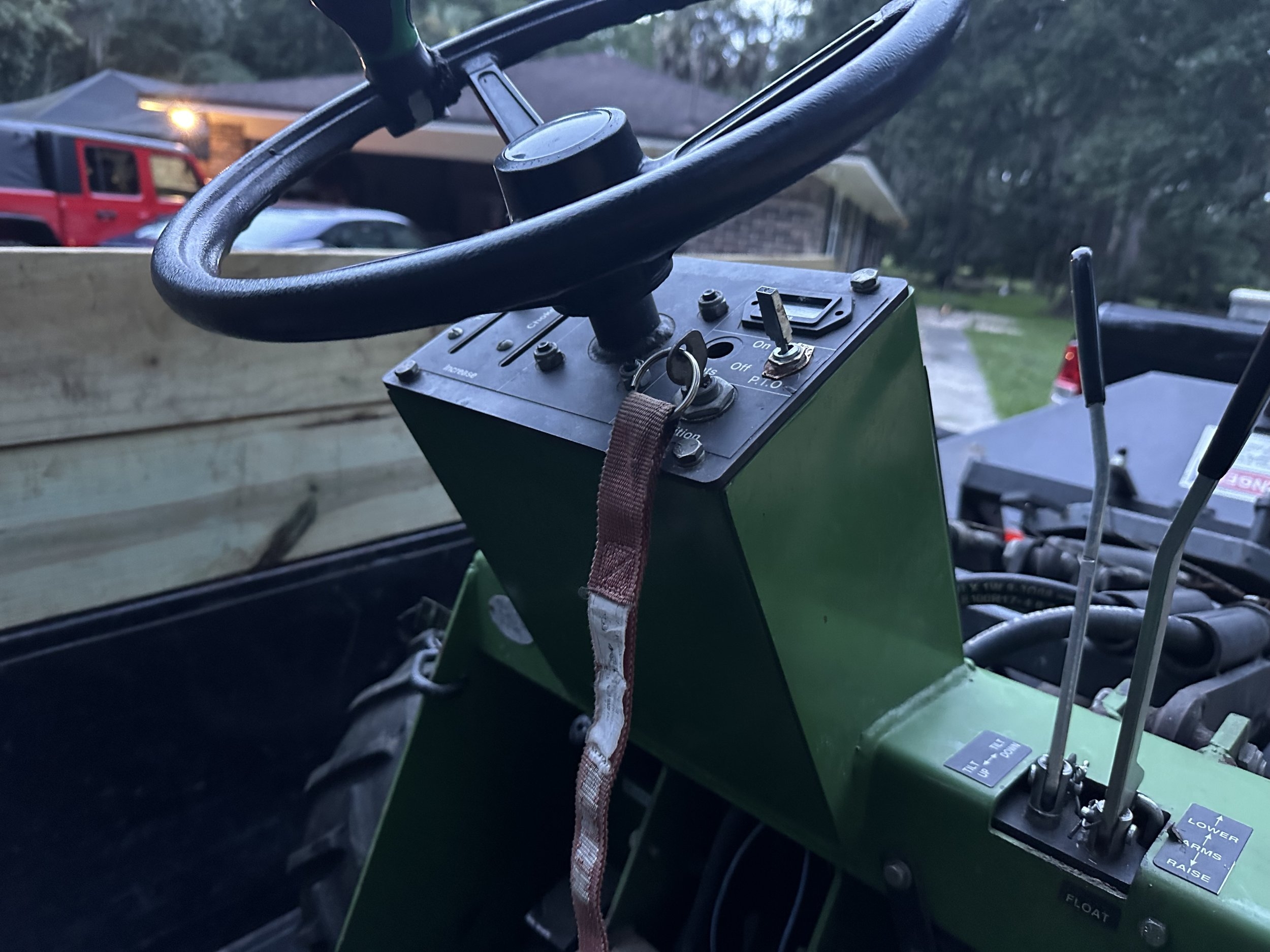

As a side note, did this the other day…
Time for a joystick loader valve…

Ouch! Old age or is there a story?
FWIW: The internal valve cartridge might be available as a separate part.

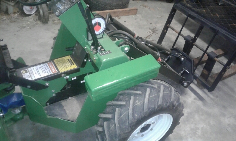

Since yours broke, you may want to consider a mod I did on mine. I bolted a strip of metal to the back of the "dash" and drilled and taped. I then installed the control levers on the other side (you then have to switch the lift/bucket cyl hoses to work in the right direction).
This gives you the industrial standard for 2 joystick loader controls. I did an old post on it with all the benefits like not having to go through the UP detent before the FLOAT is reach, which is backward.

But if you ever find an easy way to install a one stick control, please post.
/ PT-180 quick attach issues
I bought one and was about to install it because I want a joystick, but when I had finally got all of the fittings I needed and was about to install I figured out it did not have a float Function so… useless… sorta… and they would not return it because I had “installed” it.

Here is my cooler I added. When I get around to it I will swap the hose looping around it to a hard tube. Until then. It works. And after 8+ hours of brush cutting yesterday and 4 hours of mowing today, it works. 😁

My cooler is much smaller but give me a few hours of work in hot weather. I had the stuff laying around.

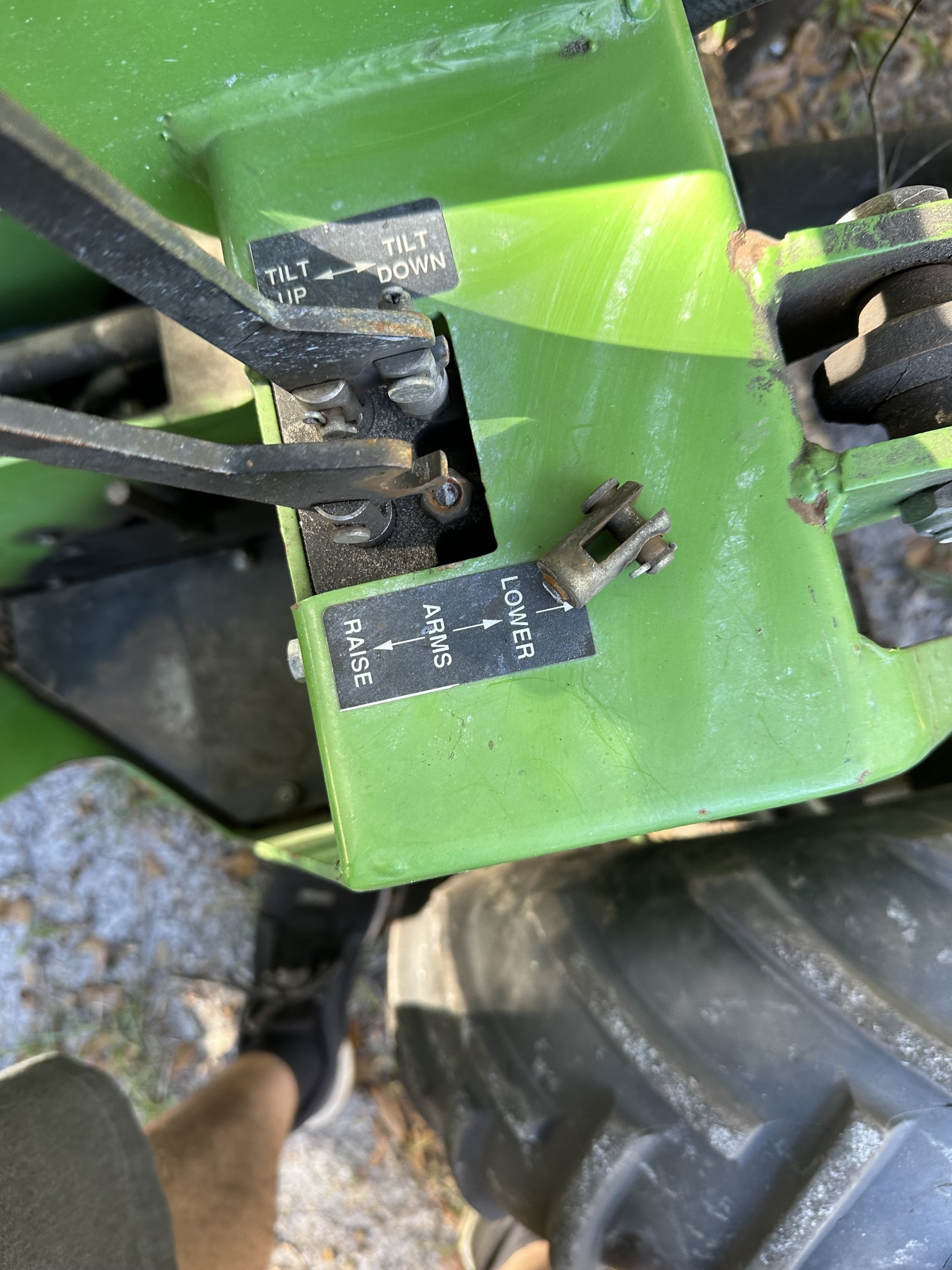

As far as your single stick control lever, the float function is in the valve. Are you changing out the complete valve? You only need the linkage and stick, I recently made one and it works ok.
The float function will need the spool push in the valve deep and against a spring. You would need the leverage of the control to push it in and the linkage would need to be adjusted to push it in adequately. It would be the only spool that would go in that deep, a full notch deeper then the others.

Yeah, I was swapping the whole valve. I need to see your creation
/ PT-180 quick attach issues #12
Pics of my creation. I cut the tolerance too tight and the ball pivot should have been at least 1/4" further away from vertical piece.

I know when i replaced my oil cooler with a larger unit it made a world of difference on my little machine. Im running a 60 inch bruc cutter on my 2425 and have no over heat issues here in Ga with 95 degree temps.

Tchamp, I think we have the same cooler…
