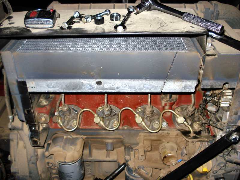

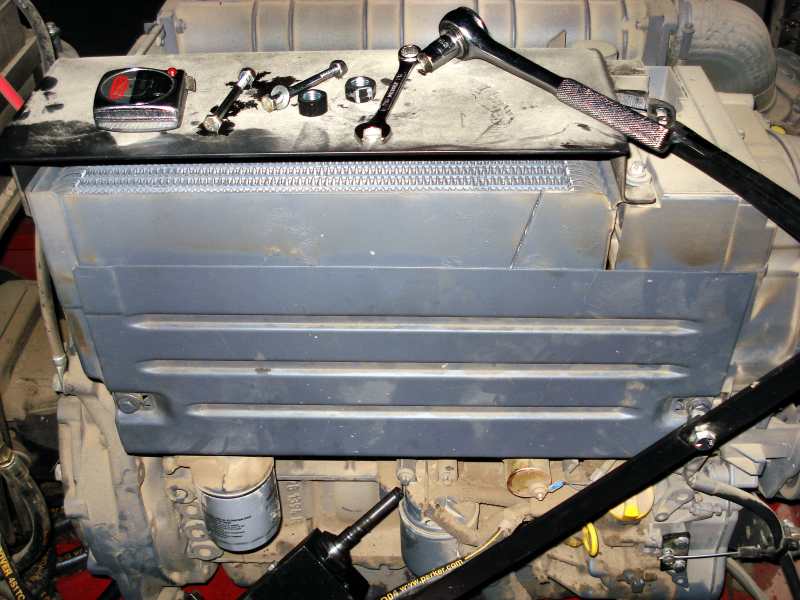

The "start the day" routine for me and my 1850 is to use the air-hose to clean both the oil radiator AND the air-cooling fins in the engine. About every 10 hours I give the air-cleaner a squirt too.
I've attached a couple photos to show you those engine air-cooling fins. Pay no attention to all the tools up on top -- they're not standard equipment, unless you're rebuilding your accumulator pump like I am.
My experience is that on a cool day, I can go all day without overheating. But on a hot day (80+) in the season when the dreaded Little Fluffy Seeds are flying about, I'm only good for a couple hours. Then, out comes the 13mm wrench (yep, gotta have metric AND US wrenches to work on your German-engined, American-made 1850), off comes the cover plate and lots and lots of crud comes off of those fins. I got me one of those right-angled air-squirting heads so i could get in between the top of the fins and the cover that sits above them. It's really hard to get in there with a straight head. If you haven't been cleaning those, I bet that'll help.
I keep thinking I'm going to put window screen over the whole engine cover to see if I can cut down the LFS, but I haven't gotten a round tuit.
If you have, you may be coming to the same realization that I am. I'm finding that the 1850 is great for smaller mowing projects, especially on hills. But when I've got a LOT of field mowing to do, I like my Kubota 6800 a lot better. My 1850's been down for a couple weeks while I get that pesky pump rebuilt. So I fired up the 'Bota and in one day ripped through 38 acres of mowing in glorious air-conditioned comfort. Even the 'Bota needs to have the dreaded Little Fluffy Seeds cleaned out, but he can go all day before he needs it where the 1850 is a lot more finicky.

My experience is that on a cool day, I can go all day without overheating. But on a hot day (80+) in the season when the dreaded Little Fluffy Seeds are flying about, I'm only good for a couple hours. Then, out comes the 13mm wrench (yep, gotta have metric AND US wrenches to work on your German-engined, American-made 1850), off comes the cover plate and lots and lots of crud comes off of those fins. If you haven't been cleaning those, I bet that'll help.

Well, to answer your first question, I don't think your experience is unusual. On a hot day, 2 hours is about what I expect to get out of the machine. It doesn't peg 300, but once it starts to lift off of 240 I head for the barn 'cause it won't be long before it's heading seriously north.

But overheating's only partly due to things getting plugged up, it's also because there isn't enough cooling capacity. JJ's saying that we should put another radiator in the hydraulic system. I think that in addition to that, we need some way to cool the engine itself, since that's really the problem child. That Deutz is air cooled, so we need more heat-sink. I wonder if there's a Deutz engine hacker out there who's figured out a way...

I talked to a Deutz mechanic about adding a cooler to the engine, but he said an additional cooler on the engine would mess up the oil pressure. I don't think those engines are designed for agricultural / construction use...too much dust, its probably perfect for powering big generators, or boats where thers little to no dust.
