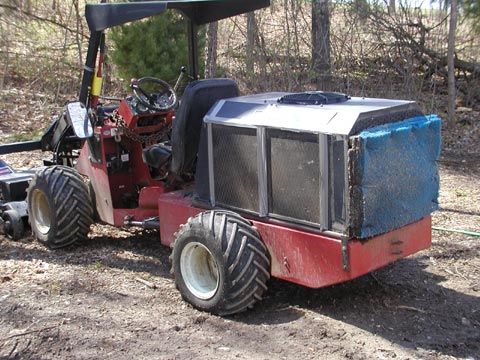

Oh... I read the rest of the thread -- there's lots of goodies in there I'd forgotten about. Like this shot of John Coxon (Sedgewood's) screening system;
http://www.tractorbynet.com/forums/attachment.php?attachmentid=37712&d=1114712854
But overheating's only partly due to things getting plugged up, it's also because there isn't enough cooling capacity. JJ's saying that we should put another radiator in the hydraulic system. I think that in addition to that, we need some way to cool the engine itself, since that's really the problem child. That Deutz is air cooled, so we need more heat-sink. I wonder if there's a Deutz engine hacker out there who's figured out a way...
This cooling/chaff problem has to be the biggest design flaw in the Deutz based series.
My screening system works fairly well, but like Mike I still have to clean the engine cooler every couple of hours in really chaffy conditions (I use a water hose with one of those little fire-hose style nozzles that puts out a concentrated 1/8 inch streams). The little stuff still gets through my screening. I've modified my mowing routine to do two cuttings in the early part of the season while the growth is still green. That helps a lot by avoiding the driest chaff. This year I changed out the blue screen on the rear if favor of a screen made of three layers of the black nonwoven fabric stuff sold as a roof ridge vent. I just finished up my second cutting for the year and went about 20 hours with the temp gage hovering right about the 240 degree mark for about the last 10 hours.
I agree with Mike that it's the engine cooler that's the culprit here. The hydraulic cooler seems adequate and the hydraulic temp stays in range between cleanings. It's that darned undersized engine oil cooler. If you look down into the finning you see that it's stamped in a way that catches the small chaff as it passes through. Definitely not designed for chaff.
Be sure your engine oil cooler cleaning is thorough. I've found that a sloppy cleaning is only good for a couple of hours at best. It takes me about 15 minutes with the nozzle, spraying bot down through and up through the cooler repeatedly to get the chaff all out. If you hold a white card under the cooler and look down through the fins you can tell if you really have it clean. I was surprised to find how much effort it takes to get it clean.

I don't have a picture handy, but it wouldn't be very instructive, anyway. I just cut ordinary insect screen to size and then taped it over every expanded metal part of the hood assembly. Then I cut a round hole for the exhaust and an oblong one for the cooler exit.
I agree that cooling capability is limited, but with the screen I've gotten as much as a two-hour run without clearing the circle of chaff off the back, and six hours without lifting the hood to clear the coolers. Unless it's really dry and clouds of chaff, the machine may be good for more than that, but I'm not

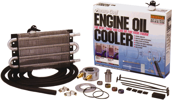

Who on earth did you call about oil coolers. The oil coolers that I am talking about run from $30 to $120, depends on the core type. This is very similar to the transmission oil coolers used on millions of cars, to cool the transmission. Like I said before, I had one of them on my 25 hp Kohler, and onother to cool the hydraulic oil. Yor can get all the fans you want at the junk yard.

This is the oil cooler that I am talking about.
