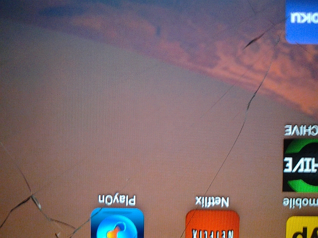

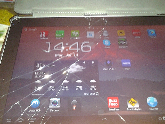

Now that I'm at a real computer, instead of on my wife's tablet
[don't ask me what happens to a 10.1" Galaxy Tab's screen when you forget to close the folio cover and it falls face-down on a ceramic tile from 24":censored::duh::censored:]
Broken Tab screen2.jpg:banghead:
Broken Tab screen.jpg:hissyfit:
