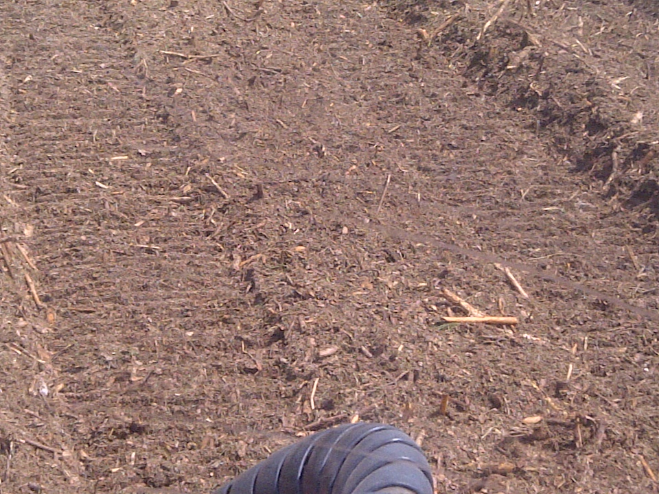

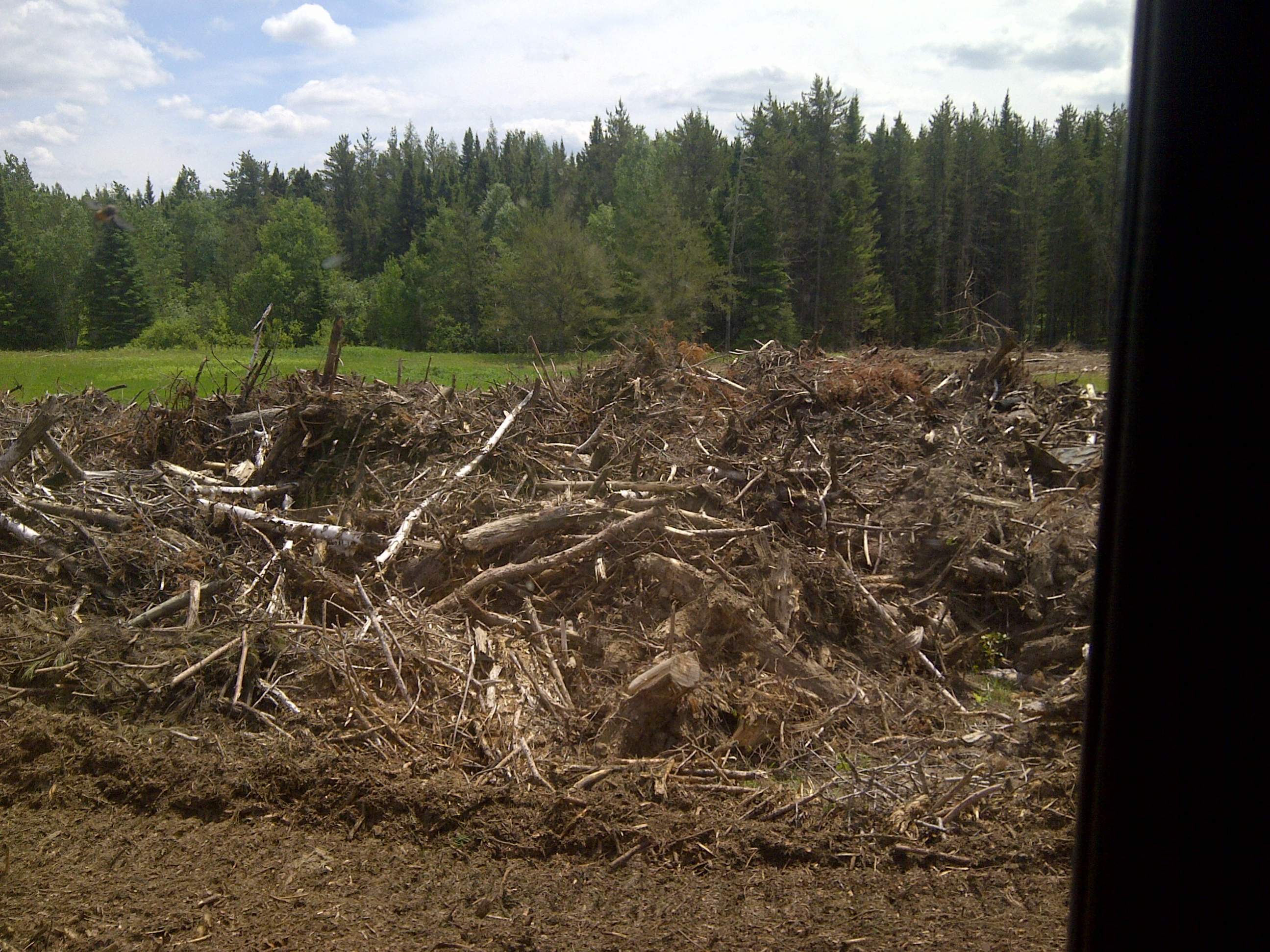

Here's some pics for ya guys were subsoiling this site so they can use the material for the final lift on the front slopes of the cell. Also because almost no grubbing has been done. Very sandy/rocky conditions so they need all the overburden to be mixed with the woody material so they have a usable "top soil" to plant.

Nice end product!

Great results. I've considered a fecon soil hog before. What kind of production are you getting with it in the conditions like the picture?

Should be able to do a acre or two in a 10 hour shift, this is multiple passes though like 5. The subsoilers don't leave a very nice product kinda like a iron wolf. But they grind everything. They're great for grubbing. Its a by the hour kinda thing, conditions greatly affect production.
