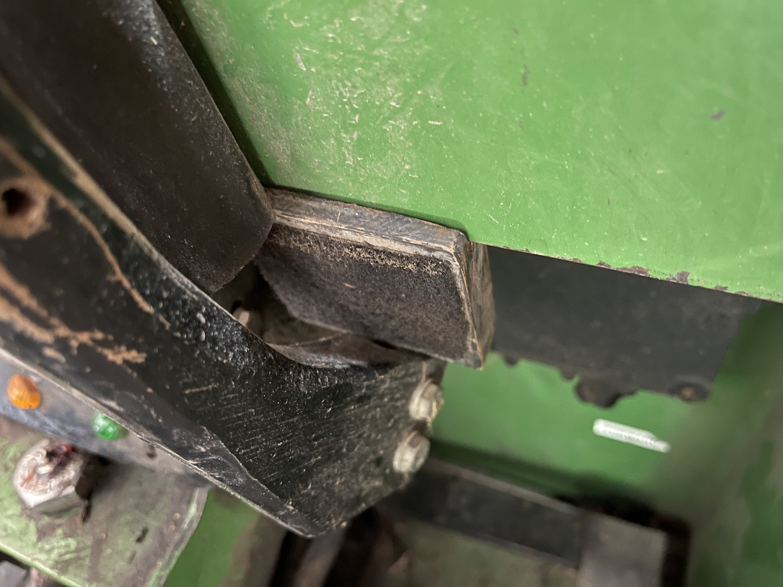

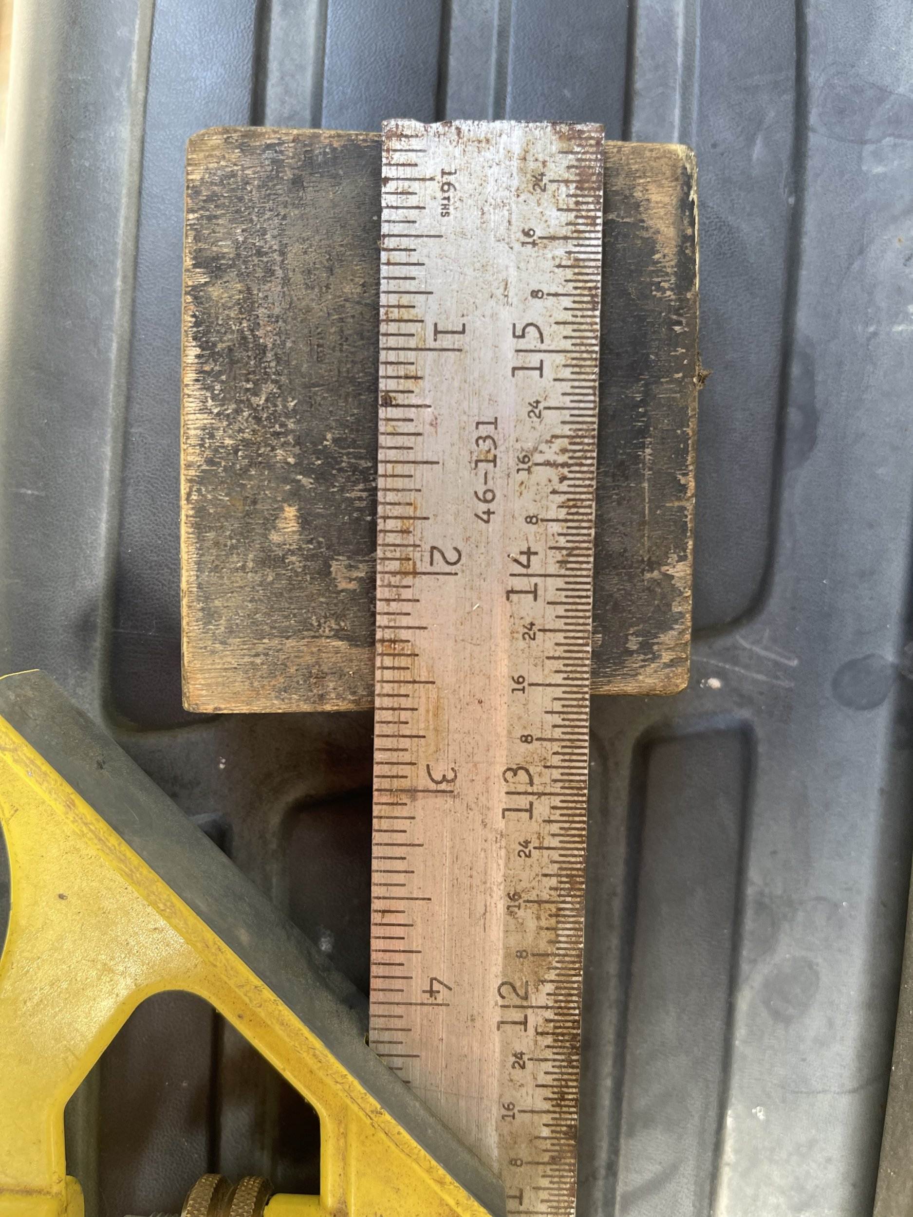

Try searching for wood latch pawl auxiliary PTO modification, etc...
Was it Bob that did the mod?
Yes, it was me. Search on Bobrip for details.
