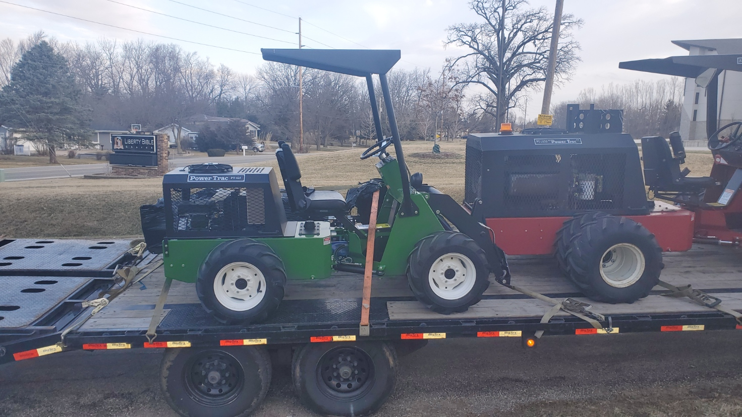

Our new PT arrived this week! Here's some initial pictures...
Ours is the small one. The red one was a factory rework heading up to Wisconsin.

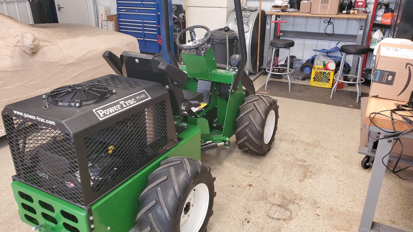

There was a fair amount of paint damage in shipping, so first stop after unloading was into the shop for some rework.
PT is going to ship me some matching green paint, so in the mean time I've at least covered the bare metal with a good coat of primer. The rear corners were torn up the worst (see back left corner in the previous picture), so I decided to make lemonade out of those lemons and add reflective silver corners to it to make it more visible if working in the ditches or moving snow in the winter. It came out OK but I think we can do better, so I've got another idea I'm going try next (stay tuned).

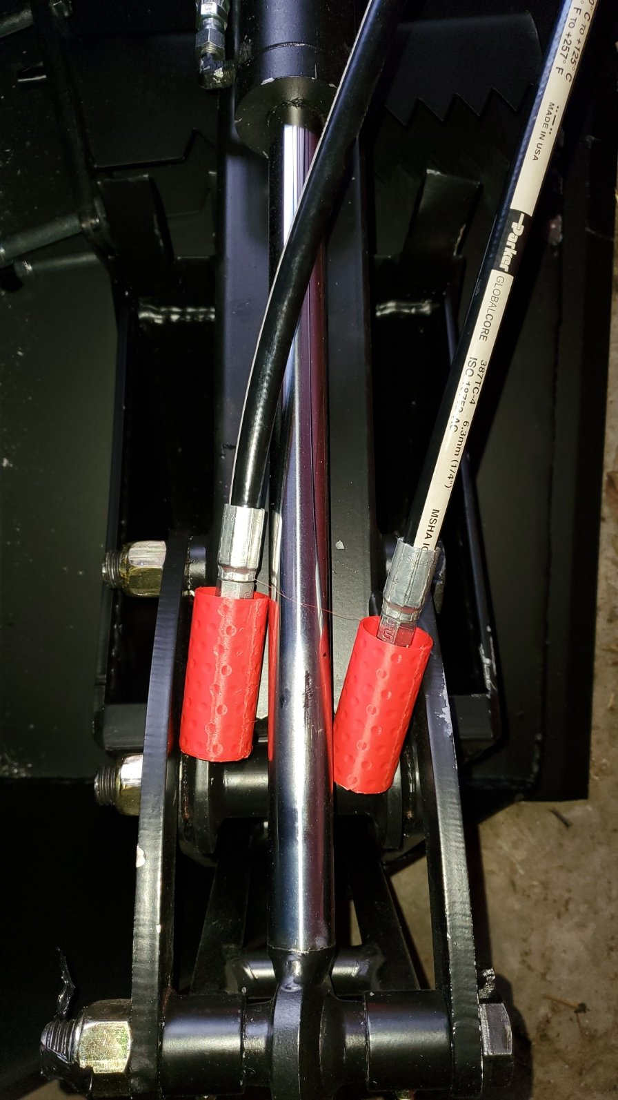

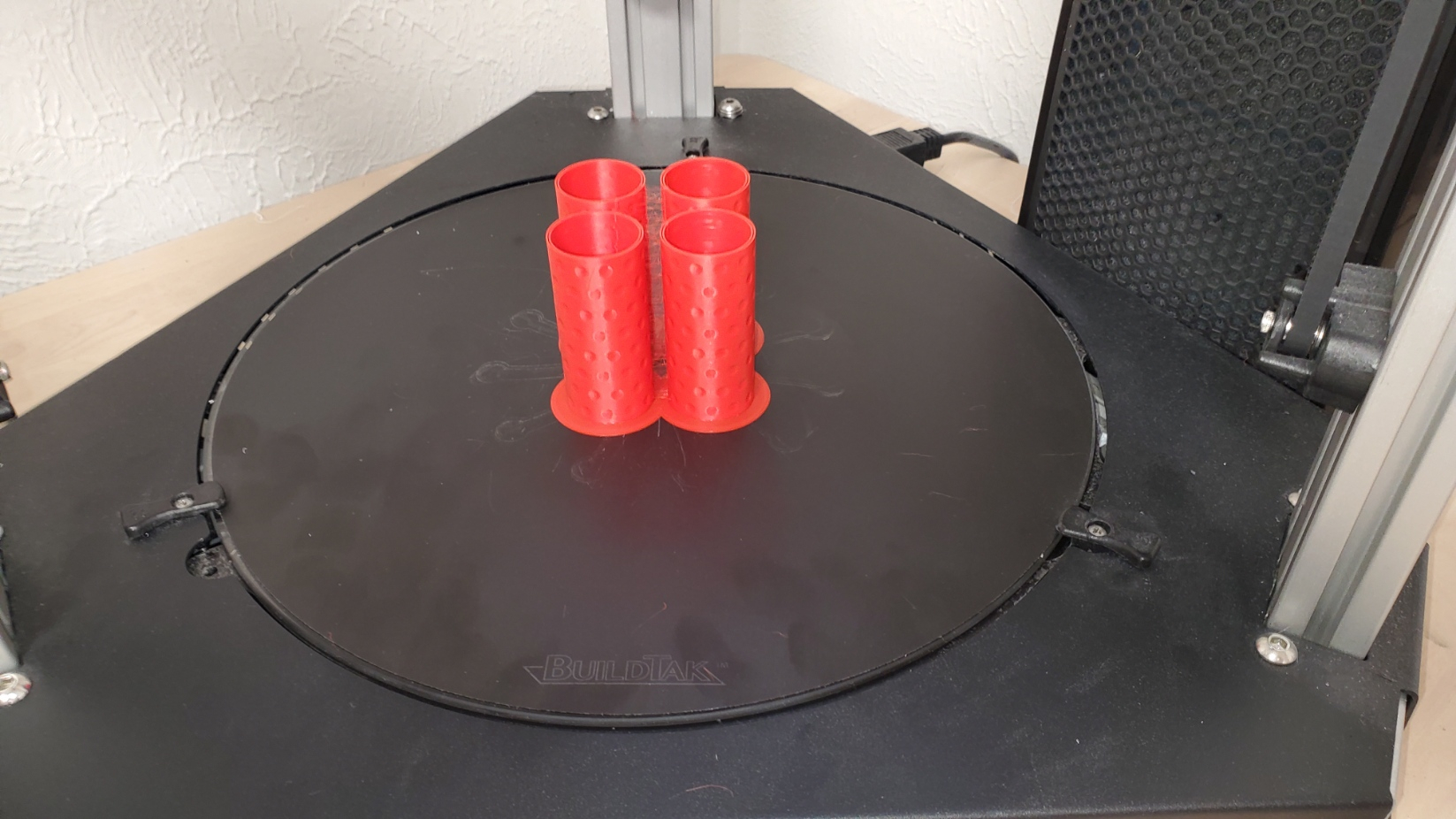

Two of the implements we ordered - the fertilizer/salt spreader and the post hole digger - each have a male and female hydraulic QCs, so to keep those clean I just plugged them into each other, job done! That won't work for the snow blade and the mini-hoe, as these have two female QCs that are also a different size from the PTO-driven tools. So, off to the 3D printer and...
There's about 0.5mm of clearance on the diameter, so they slide on and off easily but don't just fall off on their own.

That's so clean I don't know what it is!

Nice! Does it have a aluminum gas tank? I always heard good things about the Kohler engine they put in the 425. I like 3D printer coupler covers. 👍

Congratulation! I love the 3D printed caps. Sorry about the paint. I was just looking at mine and thinking that it was time to repaint more of it.

Something for you to think about. On the smaller fittings I reversed one side. This means you would have to buy extra fittings (for the other attachments), but then you could connect them all together when not in use, but the big advantage is you always connect them up the right way. I wasn't liken it when I would have to move the lever up for the attachment to got down.
This is most important with stuff like the mini hoe or grapple.
In the pic of the mini hoe, try not to damage the chrome on the piston rod. If you do the piston will eventually leak oil.

FWIW: I just put red and blue zip ties on the connectors. That way I could still reverse them if the need presented itself, but I still was able to hook the connectors up so the handle always functioned in the same way.
