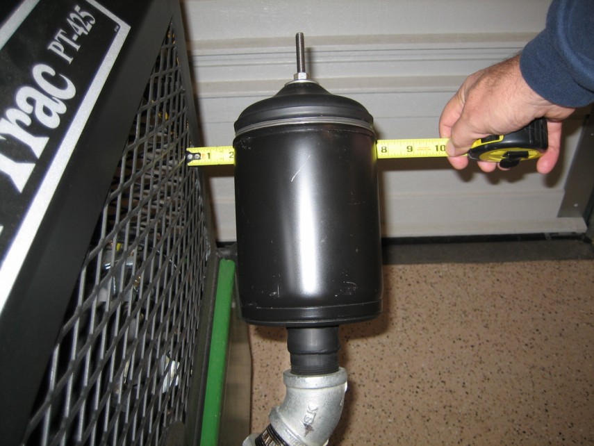

Hogi, The new muffler is quieter. I only started it up for a few minutes to check it out cause it was getting late. I'll take it out later today after church and hopefully see the real difference. I'll stress it a little to see if the performance changed. The instructions said to install one ring per seven horsepower. That's 3.5 rings. I only put in three rings because they come in packages of three for $20.00. I thought that that would be close enough. ... we'll see, huh? If the exhaust is too restricted then I'll buy another package of rings.

Nice conversions. I have one of those mufflers (with three rings) sitting in my garage waiting for me to weld it up. I intended to put a 90 degree elbow on it, and make the muffler point straight up. I bought it mostly because I think the square pipe with the 90 degree turns in the engine compartment is too restrictive and heats up the engine compartment too much, and I intended to weld something up with smoother corners to try to get more of the heat out. As long as I was going to replace the engine header, I might as well replace the muffler with something a little more elegant/effective. I also considered going the double muffler route to minimize exhaust header length in the engine compartment. What would that be, 1 ring per muffler?
How close is the edge of your muffler to the PT engine canopy? I was wondering how far to space the muffler away from the engine canopy to avoiding blowing hot exhaust fumes into the engine compartment or to avoide buring the paint off of the mesh.

Tim, It's approx 2" from the grille of the canopy. I had it out running today. It's quieter than before, but still remains pretty loud.

I thought I would mention something that I remember from many years ago. The frequency of the sound coming out of a pipe, is dictated by the diameter of the pipe. Large outlet. lower sound frequency. These kids and some adults like that roar out of a large tail pipe. That's why you see little 4 bangers with 4 in muffler tailpipes, makes a big racket.
You can get the same hp with much less noise by drilling many small holes in a plate to cover the end of the tail pipe. If you drill enough holes to match the same area of the open tail pipe, I think you will have less noise. For instance, on a 5 hp small engine, that had a fire arresting plate on the muffler, it was fairly quit for a small engine, but eventually, it rusted out and the noise became louder to the point of being hearing impaired. As soon as I installed another fire arresting plate, the sound was back to normal.
Something to try if you have the time. Let me know if you were successful in achieving a lower noise level.
