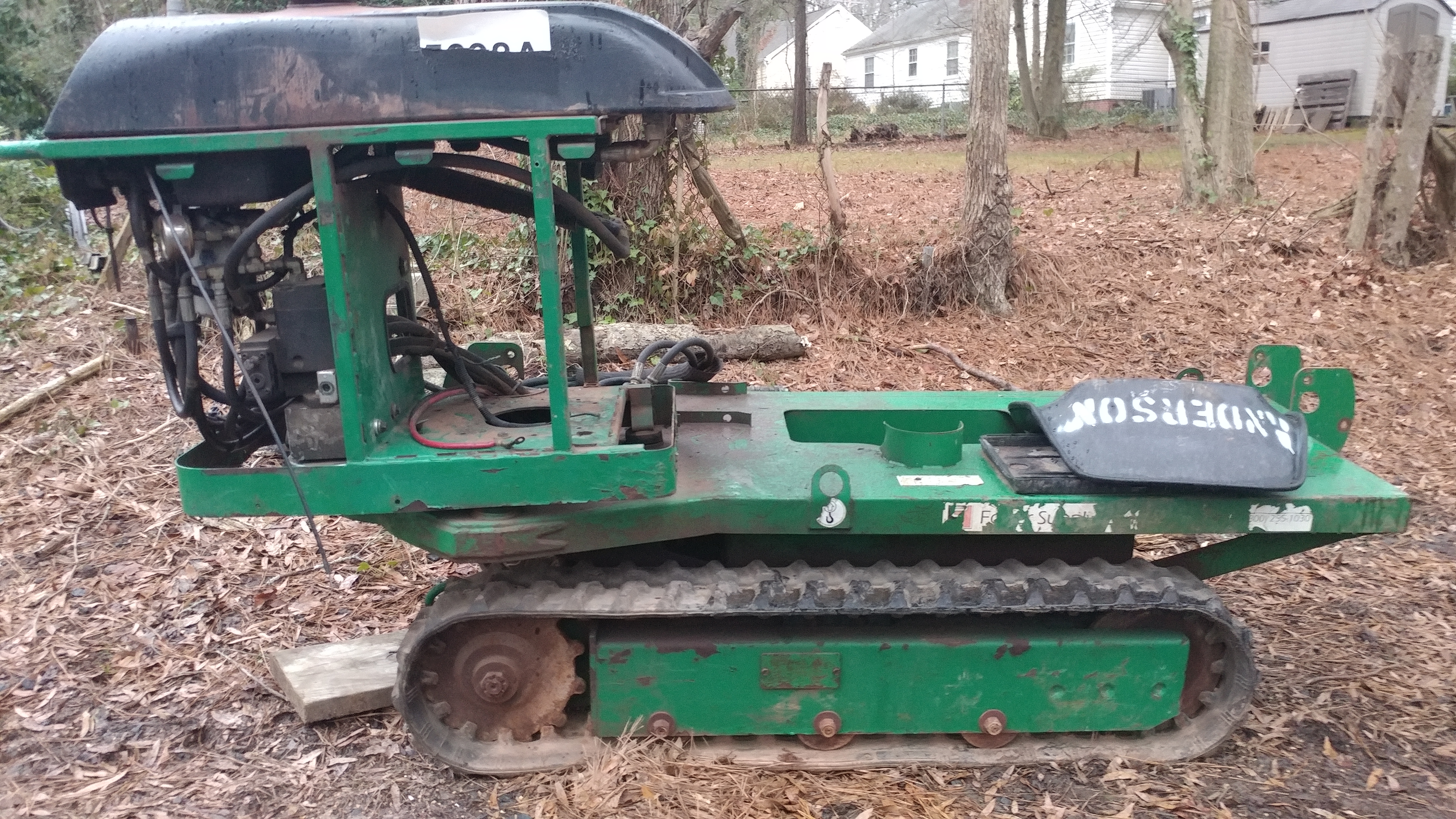

After a few years w pt attachments that, to me, have stacked up well to other manufacturers while handily beating them on price (looking at you toro), I've converted a few different tool carriers/traction systems to use the PT quick attach setup.
First was a magnatrac mh5000 dozer. It's now remote controlled.
Next came the toro dingo, because forget those bendy qa pins and spendy attachments.
Now, I've got 3 conversions on deck and wanted to share the inputs and results.
Next up: is a Mcelroy tracstar 28...some kind of pipe/conduit fusing tool carrier. Idk what it was just the specs... The unit I scooped up is Rubber tracks and hydraulics ready to drop a Honda gx390 (11-13 hp) on... plenty of power for traction, cylinder based attachments (grapple, minihoe) and stationary pto tasks, I'll give the stump grinder a go,trencher not so much. Brush cutter, nope.
It's getting pt arms and qa, a dedicated limb chipper, 4 gpm chainsaw/polesaw/generator circuit, 50' dual hyd hose reel and a 20' man lift w outriggers. Yep, I'm well insured.
After that (assuming there are survivors) a terramite t5c carcass that will be merged with the running gear and power plant of a ransomes 250 fairway mower to become a 4wd, pt 4 series tool carrier and backhoe.
Finally a lay-mor towable sweeper... What? Yep.
I think of it as repurposeful equipment. I recycle my beer bottles, why not machines?

They come from all over the place... A few ppl with eyes out at scrap yards(whole toro dingo $75=personal record) , golf courses are a great supply of Kubota and hydraulic stuff.
The other day on ebay I got a helac cylinder (Google it hard to explain)... 90$ (usually thousands) now my backhoe is getting a tilting bucket. Huge work saver for me... Couldn't afford it otherwise.
If you learn to read those obnoxious part numbers on hydraulic stuff...there's tons of cheap pressure&flow gizmos in ebay from surplus and liquidators.
Ebay, craigslist... I find abandoned projects or 'don't have time to fix' stuff all the time.
Idk what happened in the hydraulic world but there was a ton of cheap valves and such on Amazon. I Search cross and prince valves on Amazon, every now and then... 32$ proportional valve 66$ 2 spool w float... Never know.
