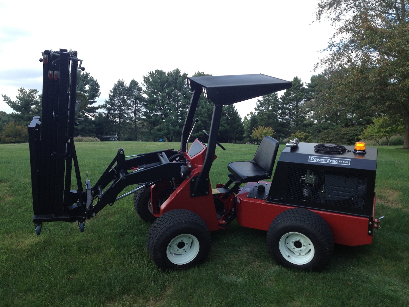

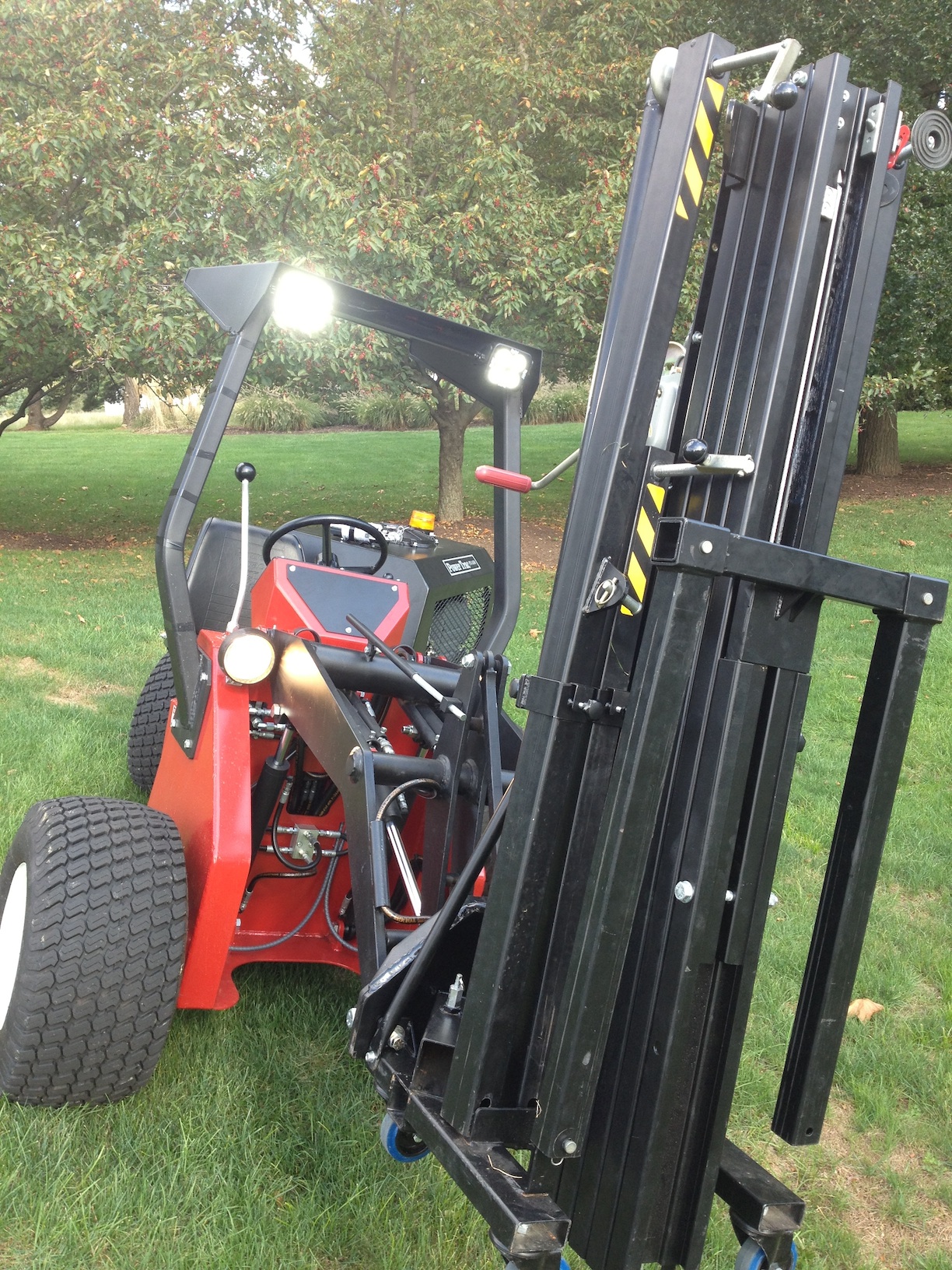

We did get a PT 1430 and have used it twice now. The first place we used it had a gentle slope, but the the unit carried all our gear nicely despite that we had no clue how to use it efficiently. It was actually quite funny: I think it took us twice as long to set up and take down because we had no idea how best to use the PT especially since none of our gear is palletized yet. The second location we used it at was mostly paved but access to the screening location was too tight to fit our 26 foot truck through. We moved in all but our line arrays using the PT. We were also able to easily tow a generator into the site.

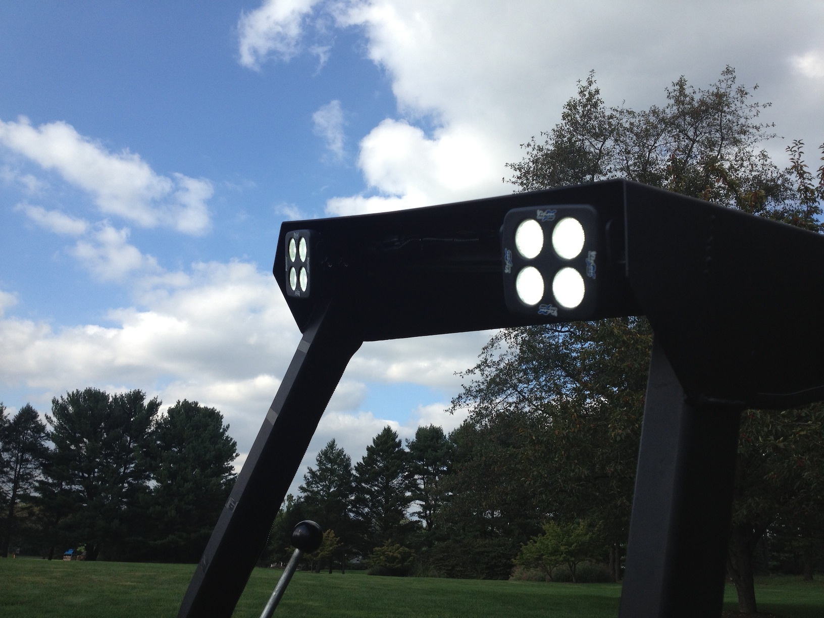

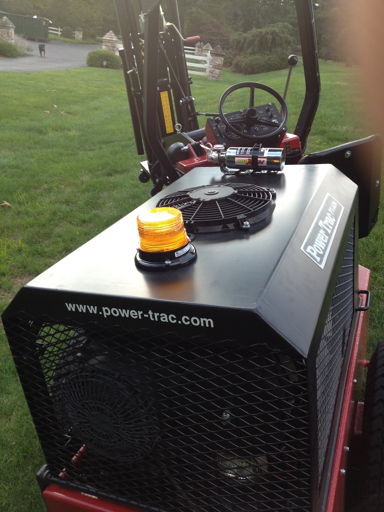

So far I have mounted attachment plates to our speaker stands, installed two 40 watt led lights on the ROPS (similar to SpringHollow), and lastly, attached a beacon and fire extinguisher like what's installed on the 1850s.

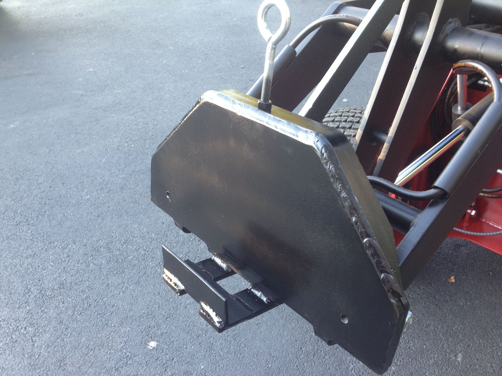

Here are some pictures.

That is a neat looking quick attach plate. Could you explain it's operation?
   / PT capabilities as an all-terrain fork lift
#49
The quick attach plate pictured is what I came up with to carry the speaker stand that is in the other photos. I chose not to weld the plate to the stand as I did not want to modify the speaker stands. The extension in the front of the attachment plate wraps under the stand and I tapped two 1/2" threads into the QA plate so it would not fall off the stand when I was not carrying it. The stand already had two bolt holes, meant for the stand to have a horizontal transport kit. The eye bolt on the top is to attach a strap or cable to the upper part of the stand to reduce the stress on the bolts.
   / PT capabilities as an all-terrain fork lift #50
Thanks for the description. Very ingenious solution.
