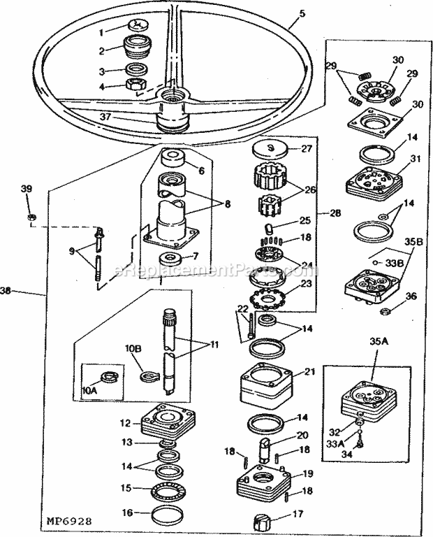

Just for fun, here's what the inside of the steering valve on a JD340 looks like, which, as far as I can tell, is the exact same valve.
Pretty complicated valve with 5 sets of seals. No wonder it costs a thousand bucks.
