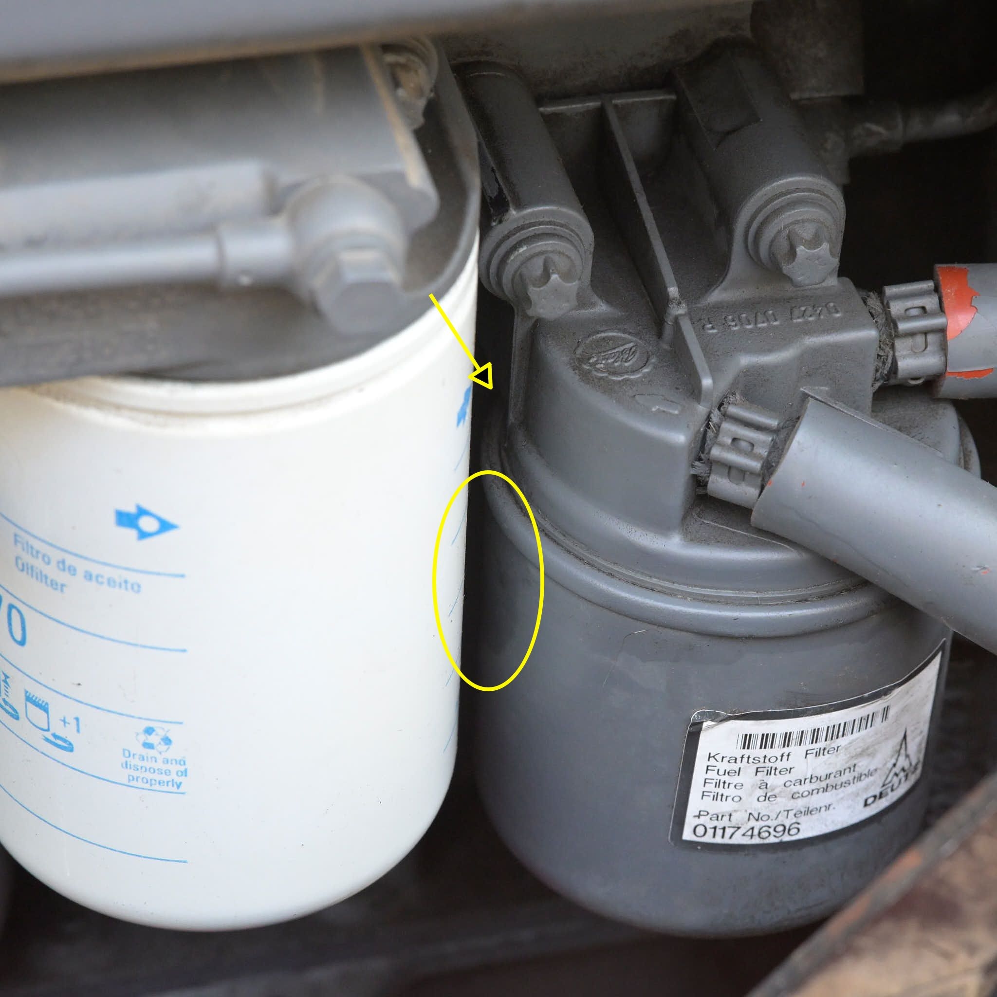

   / PT1445 Deutz fuel filter spewing diesel onto hot engine block
Fuel isn't just leaking when the machine is running, it is actually spewing out from the top of the filter housing on the side facing the engine block. I don't have a way of making a photo of the back of the filter, but you can see where fuel has been on the side of the filter in the oval area.
I suspect either the seal has failed or something isn't right with the housing. Not having another filter on hand, I parked the machine until I sort this out.

   / PT1445 Deutz fuel filter spewing diesel onto hot engine block #6
You could just spin the filter off to have a look see. If the filter is the problem, just screw the old one back on until you do get a new one. If it is not the filter, at least having it off allows you to see behind there better.

I am going to wait until the new filter arrives. What sort of wrench is good for removing the filter in this tight space? A strap wrench?
How are the hose clamps removed? Haven’t seen this style before.
   / PT1445 Deutz fuel filter spewing diesel onto hot engine block #9
A standard band clamp type filter wrench will get it on and off easily. Personally, I would check to see how tight the filter is first. If it is loose, I would tighten it up. If not, I would try tightening the filter first by a 1/4 turn or so, and see.
As @woodlandfarms points out some diesel spray isn't an instant hazard, though I would not want it to happen for more than a second or two.
Those clamps are very strong and reusable. If you look closely, you can see that they have a small tab that overlaps some hooks on the band. I find that with a small screwdriver they pop loose easily and can be re-tightened with a pair of pliers easily.
