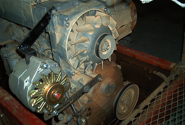

Instead of spending $500.00 plus on a new Deutz alternator imported from germany, I decided to retrofit a "one wire" chev. unit to the contraption.
I used a ford 300 six cyclinder alternator bracket for the lower and made the upper bracket. I removed the Deutz idler pulley, and used the factory bolts for the lower bracket. I had to modify the hood a little for this set up. ;)

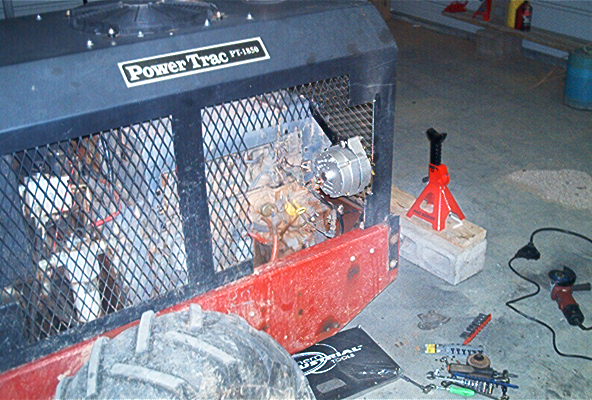

I'll make a removable cover for the cut out. The u can check th eoil without lifting that heavy hood all the time.

I think you have solved the alternator problem!:) At the same time, you now have plenty of capacity for additional lights, 12 volt attachments, (seeders) ect. :p Nice job, I think we will see more of this mod.

We finished hooking it up.
The voltage meter reads a steady 14 volts, the way it used to. So it seems to have fixed it.
But theres a strange side affect. With the new alt. unhooked, the fuel solenoid shuts off by the switch as it should; but with the alt. hooked and running, the fuel shut off doesn;t cut off, and the keys off alll electrical cuts off, except the fuel solenoid...so I have to manually shut off th fuel to stop it.
I think its some kind of ground loop. But at least its running good now.
   / PT1850 Alternator Conversion #10
It appears that you are feeding the plus side of the fuel solenoid with 12 volts, when running. You just might have to rewire the fuel solenoid with a separate switch.
