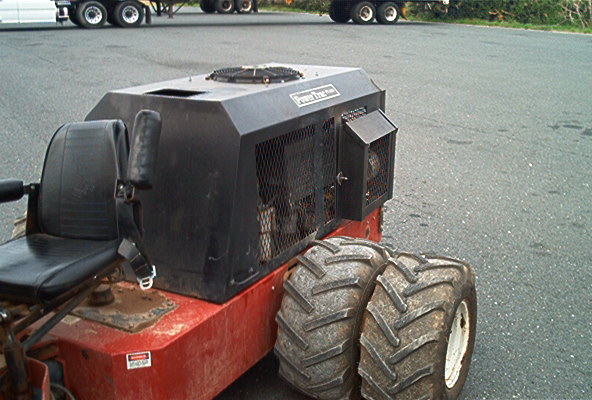

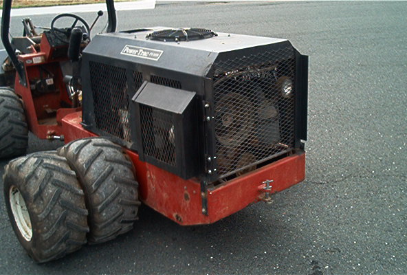

I finally got around to modifying the hood to accomodate it. The side hood swings to the rear for access to the oil, and alternator. Just a little more and its finished. Don't look too close, I let it get out of square before final welding it.

Notice the two pieces of 2 angle on the rear, I needed more room for the hinges, and they are the beginning of the rear air induction system, I'll be fabricating soon.
