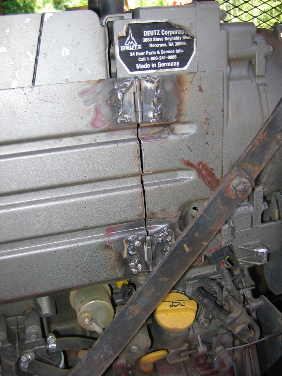

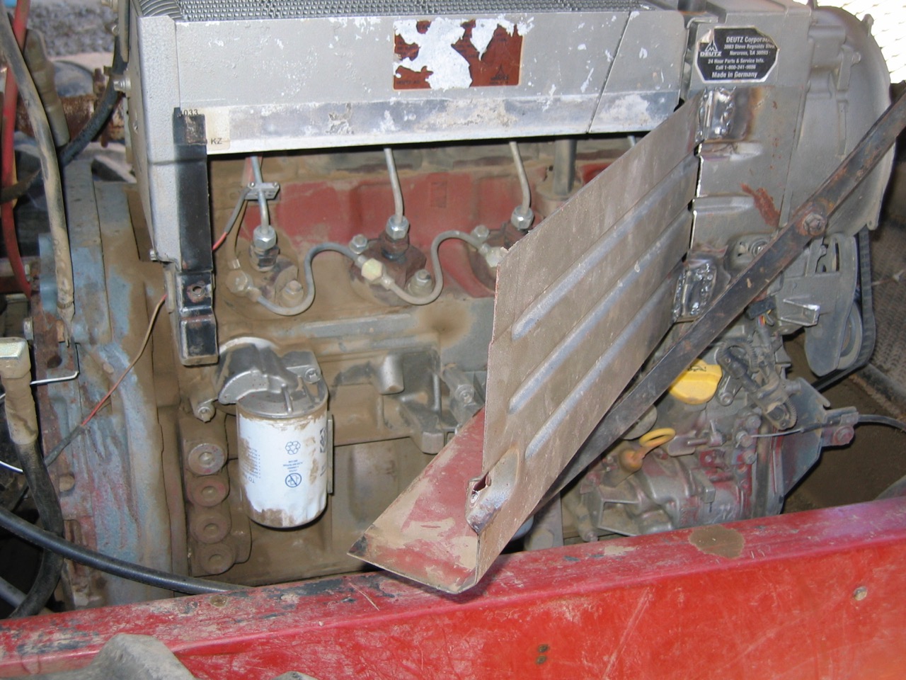

Do you have a laser heat gun? I hate pts method to indicating temp. How dusty is your mowing? How often do you blow the cooling fins out. I am on nights but I will post my cleaning tools and techniques plus the mod I did on my side door which makes cleaning way easier.

So to clean out the engine radiator I use a shorter version of something like this...
Draper ABG5 Air Blow Gun Right Angle 56mm
Now if you have taken the deflector completely off this is not necessary. Like ken, I will run water through coils every couple of weeks. I would advise, though to not run the tractor after until it has dried otherwise if you have dust you will have mud (ask me how I know).

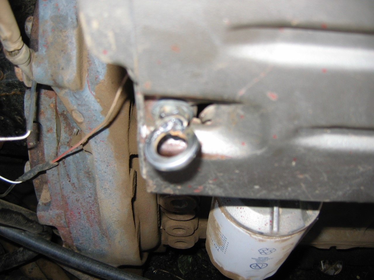

Also, this is the mod I did to my cover. It was when I was first learning to weld, not that that is any excuse. I used some cheap hinges, and welded a washer onto a nut so I could undo the one side by hand.
