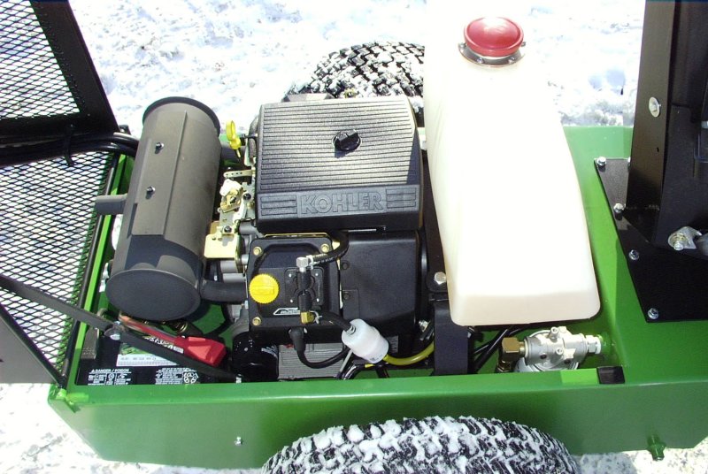

I think my 2001 PT425 stock Kohler exhaust was probably the best VS anything I've seen that PT has made themselves. It's stock from the factory. It exits directly out the rear. Nothing sticks out anywhere.
Drawback.... gotta remove it to get to the battery.
That is a fine looking engine bay! Did you install that Kohler yourself?
