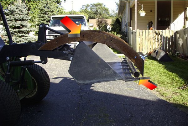

MR:
In your picture of the ring , are the teeth on your bucket the ones power trac use on their buckets? I HAVE BEEN LOOKING AT GETTING A TOOTH BAR FOR MY BUCKET AND THE TEETH ON THE TOOTH BARS ARE MORE POINTED AND WIDER LOOKING THAN WHAT THEY LOOK LIKE IN YOUR PICTURE, AM I CORRECT THAT THE TEETH POWER TRAC USE ARE NOT LIKE THE TEETH USED ON SKID LOADER BUCKETS?

Re: PT425 Grapple Build Project Picture
I think you are correct. The are thinner and flatter than the teeth that I have seen on backhoes.
   / PT425 Grapple Build Project #53
they are elongated flat iron coming to a point. versus most bucket teeth i have found are wedge like. but the pt grapple theeth bucket do the job well.

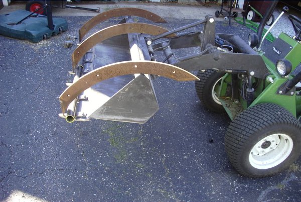

#54
I had an hour to kill yesterday, so I took one of the rings that I found at the junk yard, divided it into fourths and spent some "quality time" with my sawzall/w3tcompact/icons/laugh.gif/w3tcompact/icons/laugh.gif/w3tcompact/icons/laugh.gif Boy is that stuff hard. Took about 10 minutes per cut and two blades total. My arms are really sore today. I could have used the torch, but the sawzall gave a nice finish with no grinding.
I cut at an angle from the outside of the ring towards the left about 3 inches. This gave me a nice point on the tooth end of the grapple fingers. I might just use that with no commercial tooth welded on. If it starts to show signs of wear or doesn't grip well, I'll weld on some real teeth. I'll take some pictures of the pieces later this week and post them.

#55
As promised.. here's a picture of the big steel ring cut into fingers for the grapple project. They are still too long, but you get the idea. I think I'll use three fingers and I'll show you why in the next picture.

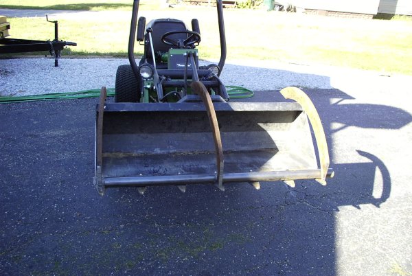

#56
If I use three fingers, one will hit each end tooth and one will hit the middle tooth. The middle tooth will be the one that gets the hydraulic cylinder and the end teeth will have the pivot points. This photo makes the bucket look wider than it is. The distance between the fingers is about 20".
#57
This last photo show an arrow pointing to where the fingers will be trimmed and pinned to the pivot points that have not yet been mounted to the bucket. The lower arrow illustrates the nice thick point that I was able to acheive with the sawzall. Also, note the tubing laying across the teeth of the bucket. This is what I will use for the cross bracing between the fingers.
