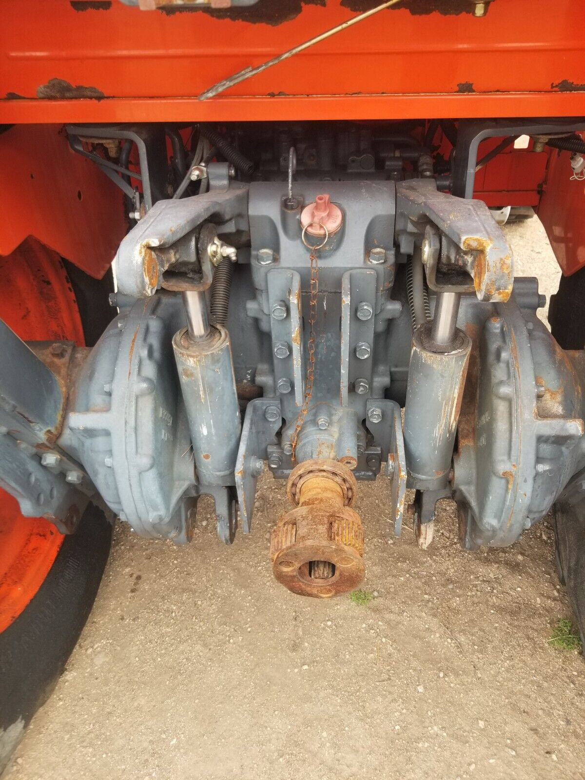

Im looking at a tractor 2005 KUBOTA L5030 4X4 TRACTOR that runs drives only problem is when last owner took off the loader some how they managed to disconnect the 3 point and PTO. PTO Spins free. Any advice on what to fix first and what it will take? Tractor to be used with a backhoe for digging mostly.

What exactly do you want to know? I will say if it spins freely while not engaged, the pto brake is shot. I presume you will mount a frame mount BH. That rear end won't take a 3 point mount BH, you'll crack the back housing and then it will be worthless. Cost to replace a back housing is about 15 grand.

What in the world am I looking at here? Looks like part of a planetary gear set with a bearing out in space.
Exactly what that is stick on the back. Old whipped out 3 pinion planetary from some long gone automatic transmission.
   / PTO and 3 PT #8
I would question that setup in the back too..... never saw anything like that. Could it have been used as a coupler to drive another hydraulic pump... those types that have the hard rubber blocks between the 2 shafts?
Missing all of the 3 point hardware? Could it have been used to mount a BH?
   / PTO and 3 PT #9
That rusty gear set on the pto might be a clue why the pto won't run. Did whatever gearbox was running blow up and they couldn't get the rest of it off the shaft? There might be a bunch of broken parts inside.........
