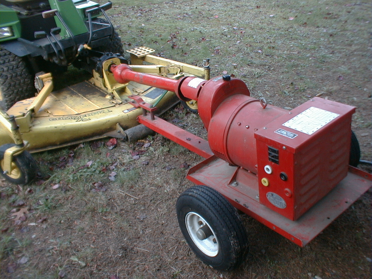

I have both portable & a 12 kW PTO generator. Short runs I use the portable, Long runs the PTO. 12 kW on a Deere X748 24HP Yanmar. This is the same motor that many refrigerated trucks use which runs for days on end. I would not use one of my larger tractors since the fuel consumption would be too high.
