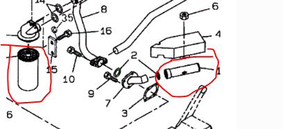

Your problem is tractor internal. Hopefully this V V V [external] adjustment will fix it.

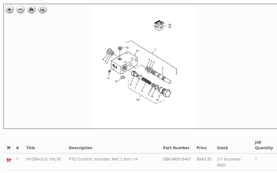

Pto clutch appears to be hyd controlled. I would suggest to check hyd pressure on pto control valve. How long since hyd filter was changed & sump screen cleaned?
just changed both filters and 9 gallons Hyd fluid. The old fluid was pretty rough and I did not check the sump screen... I will check that also! Thanks.
These appear incompatible.

Own the same model tractor. Looked in repair manual and saw nothing that would connect it with a hyd. pto. looks gear driven to me with a single stage clutch to engage and dis-engage. Looked for troubleshooting info but found nothing that would apply to your issue. Never had my bushhog slow down without rpm's dropping accordingly. Unless your clutch is slipping I dunno.
