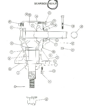

Sorry I didn't make it clear on what fell off.
My husband fixed it. It was the bolt that holds the slip clutch.
Nothing was damaged. He thinks it just came loose from use.
I was mowing after dark but on flat ground.
Is that safe to do?
We have a Kubota L3130 and Kodiak Grizzley bushhog.
I want to take care of this great machine.
Thanks,
sandy
Sandy, sounds like a shear pin to me. No biggie! As far as bushhogging in the dark, not such a good idea, especially in high grass. Please don't ask me what a white-tail deer fawn looks like after a bush hog runs over it (and that happened in broad daylight in 4 ft high pasture grass). Stay with it. YES, IT IS THERAPY WITHOUT THE $90/HR IDIOT ASKING YOU "Well, what do you think???" BobG in VA

Sandy this is a picture of a 40 HP King Kutter gearbox showing the shear bolt and the circle clip that keeps the rear of the PTO from coming off if the shear bolt breaks.

suttles said:
Soundguy,
Do you have any pictures of what you were describing when you said:'"circlip' in a machined groove at the very end of the gearbox input shaft. if the shear pin pops, the yoke can not come of fthe shaft due to the circlip..."?
I posted what happened to the pto shaft and it was the clip that came off.
Good pic pineridge!
